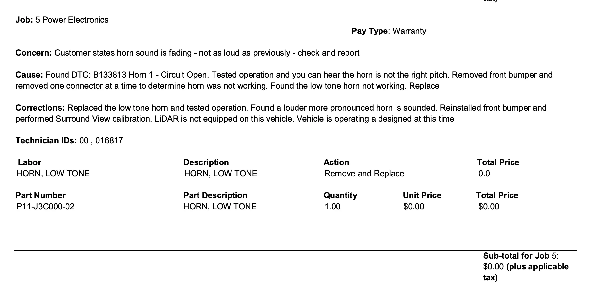

For what it's worth, I noticed a change in tone on my first Lucid horn and the tech replaced it due to a defect.
Worth an ask of a tech to take a look. I think they have two tone horns which may actually be two separate horns. Maybe one of your died too

There was no mention of charging when i submitted the request or when I picked up the car. Here's the record from the service visit.
