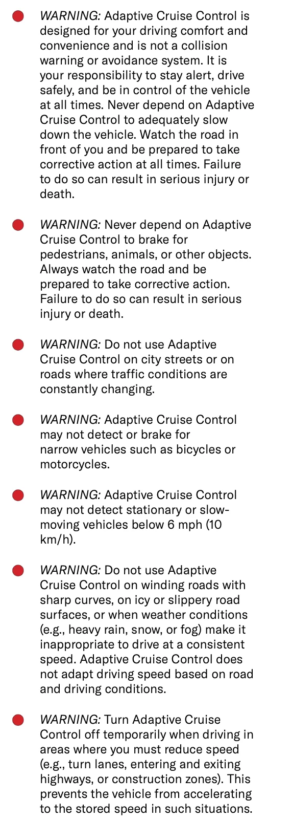

Hence why it’s classed as a Level 2 system and needs to have an attentive driver at all times.
