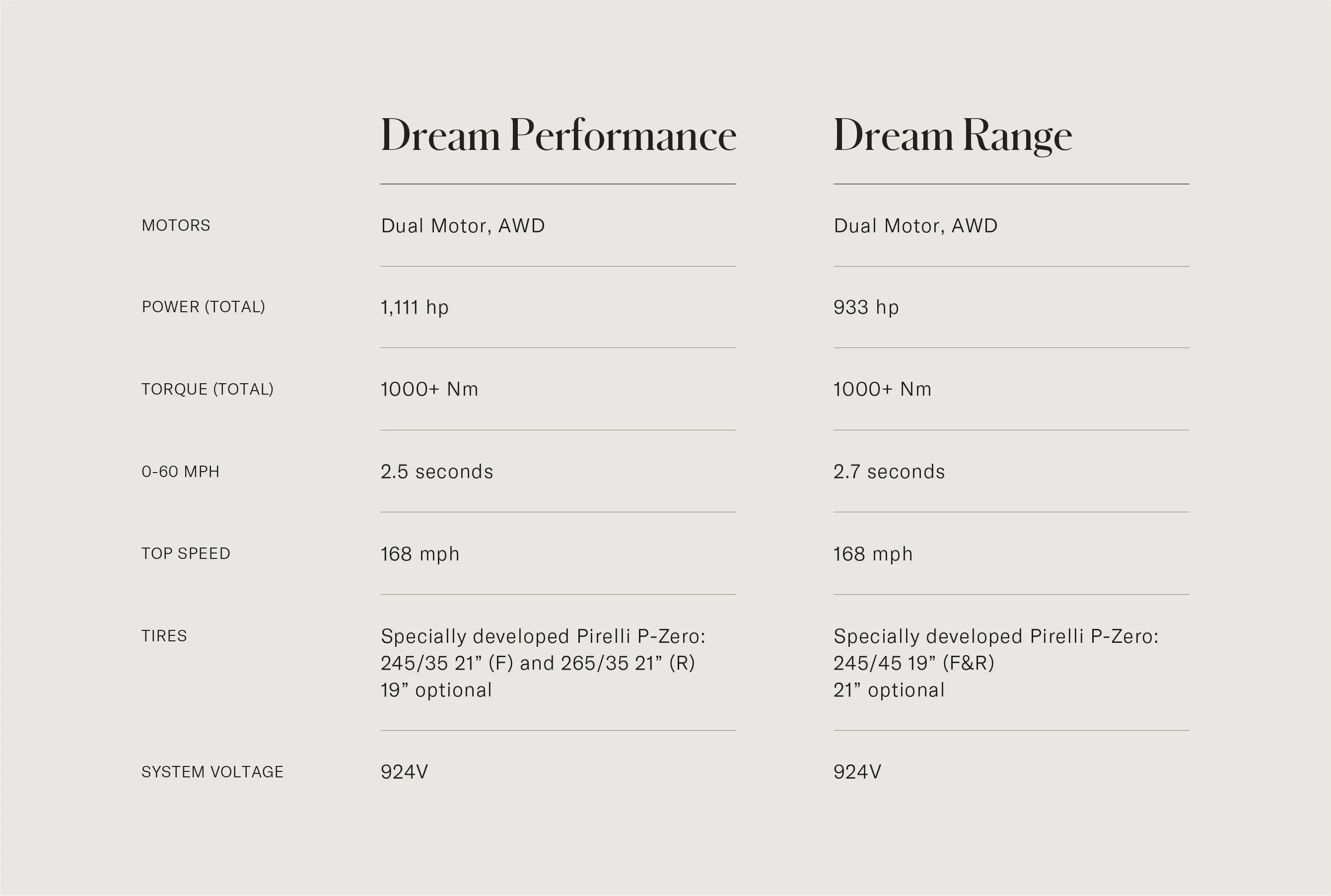

The Grand Turing Performance is a limited production that makes ~720 hp in Swift and 1050 in Sprint. It has 118 kW battery
The Dream Edition Performance is a limited production that makes ~750 in Swift and 1111 in Sprint. It has 118 kW battery.

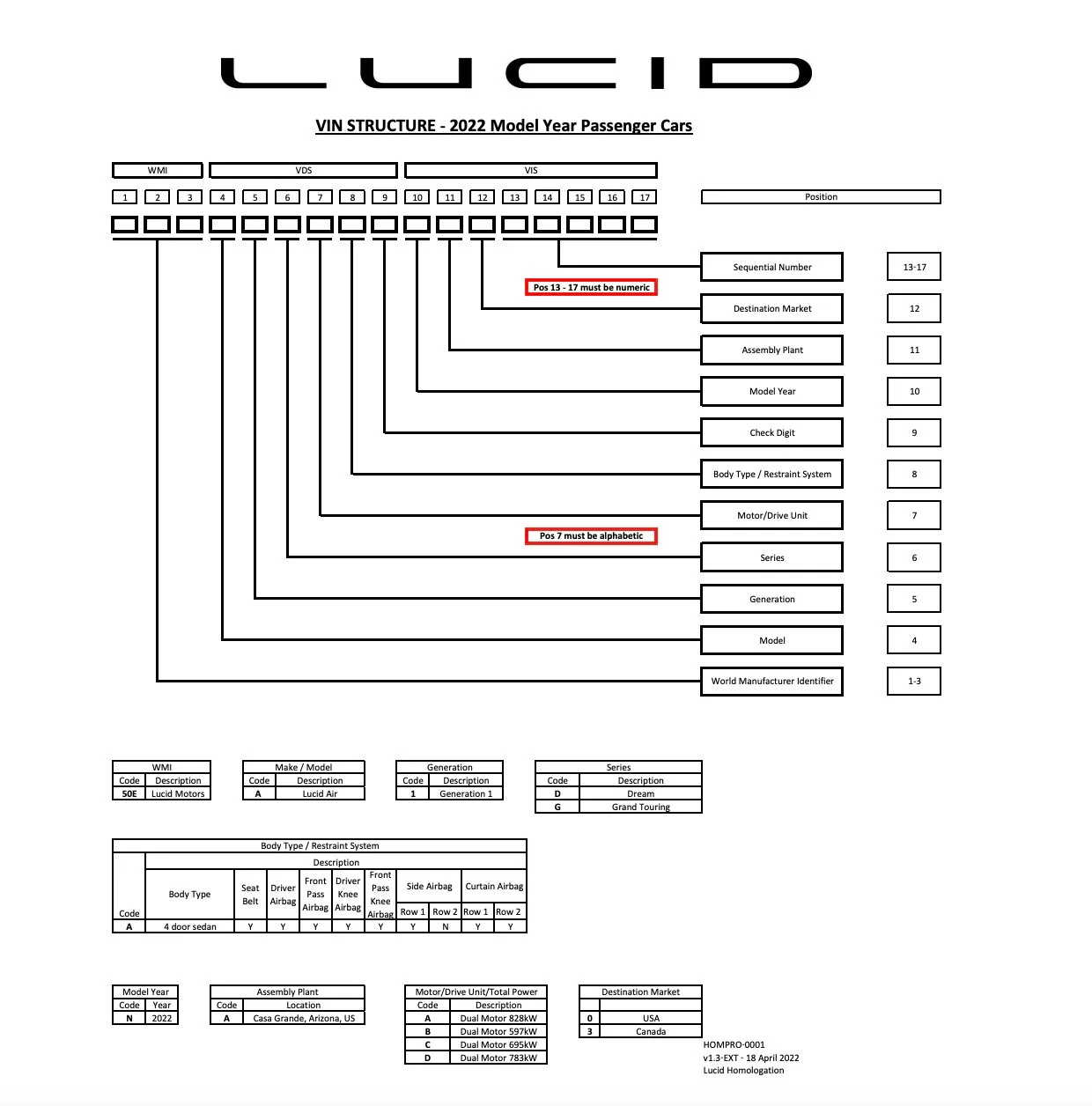

Look for the 7th letter in the VIN....
"B" means Lucid Air Grand Touring
"D" means Lucid Air Grand Touring Performance
"A" means Lucid Air Dream Edition Performance
"C" means Lucid Air Dream Edition Range
These are the codes from before the touring / pure models
