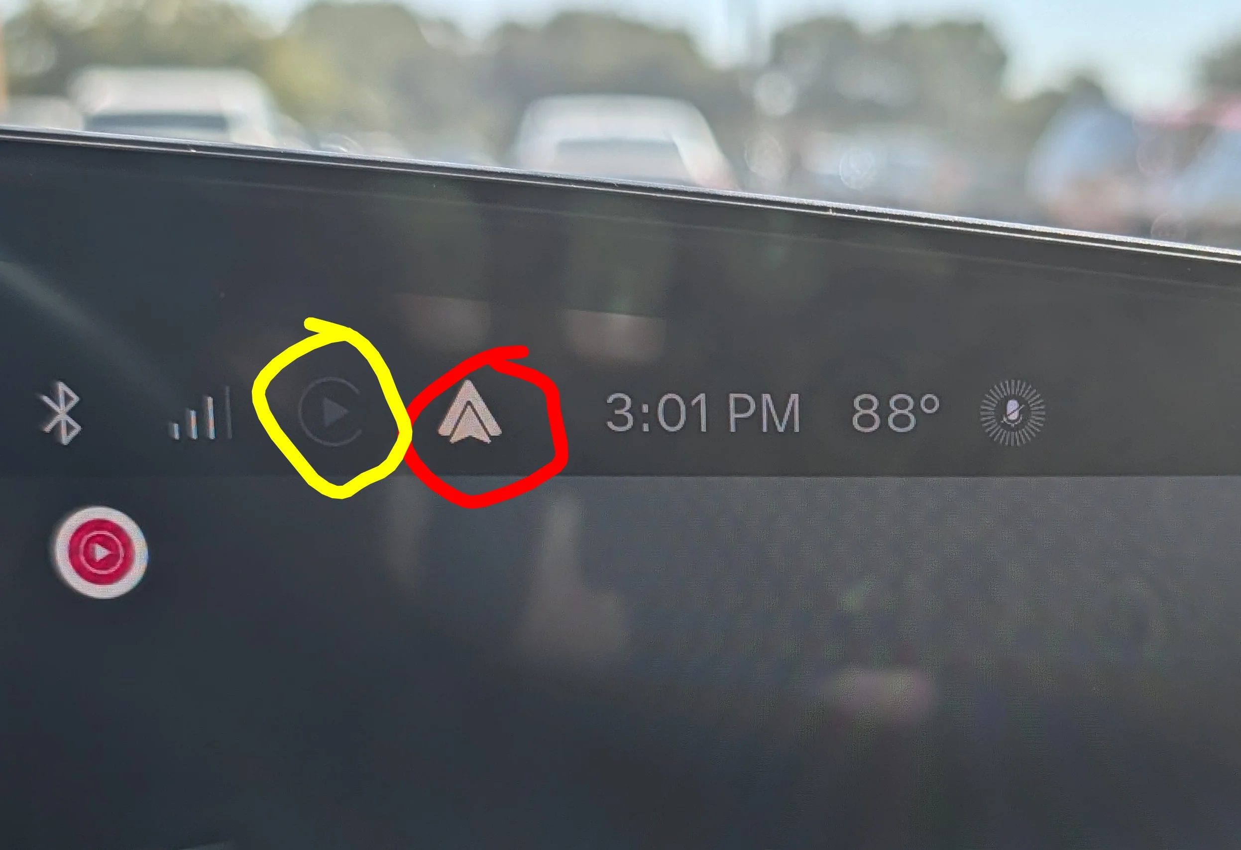

Doesn't CarPlay have the icon on the very top bar that can open/close the CarPlay screen? It works for AA.
Attached pic with the CarPlay icon (I think) in yellow, and the AA icon in red. If I tap the AA icon, it drops me right back to the native home screen, and if I tap it again it brings back AA.
At least when AA has bothered to connect. It's been a little hit or miss with the new update.
