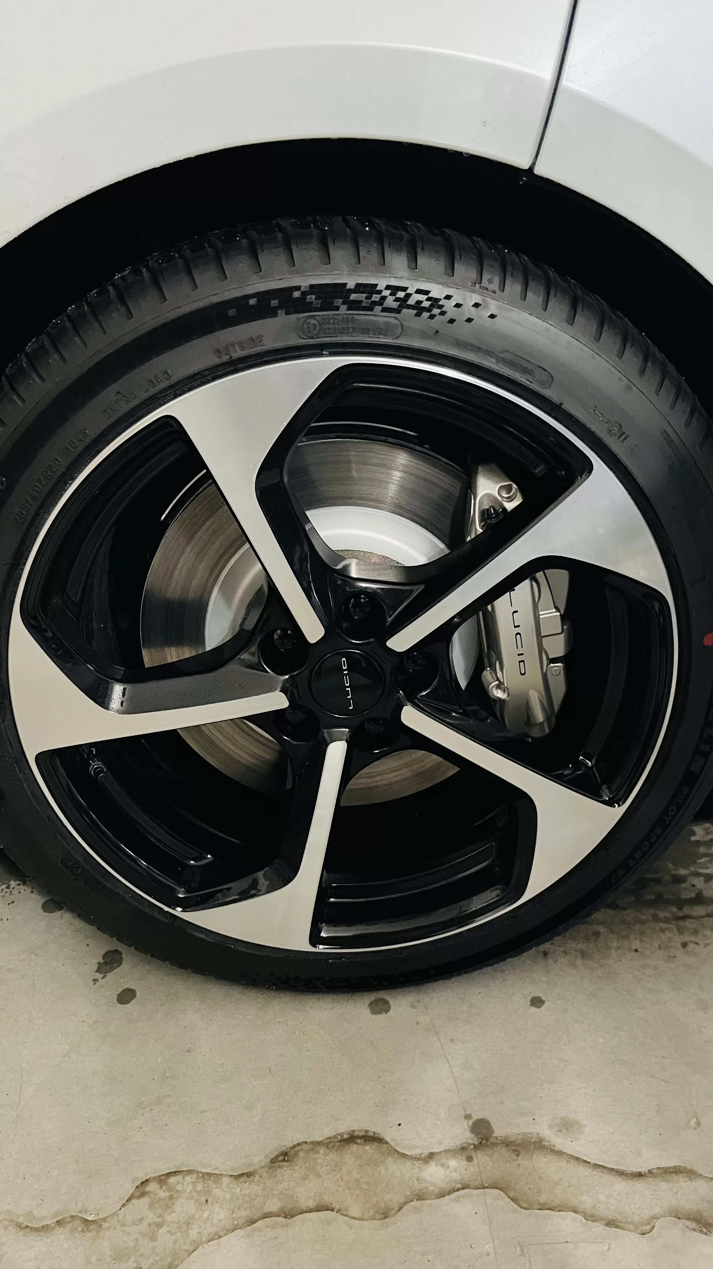

Just did a chrome delete with powder coated wheels 19in, and PPF across the front. Very happy with it!! Westchester AutoSpa HQ in White Plains. Great guys and very reasonably priced. Will add some tint on the windows next time.
