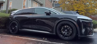

Thinking of going Porsche handling route by upsizing to 295/315. Maybe with this wheel. And a summer tire, undecided as of yet.

295 front tire - another first.
Here it is next to Lucid 22/23 setup

For those who weren’t around to do the math, it’s 295 front and 285 rear on 22x10 on Michelin All Season 4 tire

Dumb question: isn't it more typical to have the wider tire on the rear? What motivates this choice? How would you expect wider on the front to impact the vehicle dynamics?

Pro:
1. Better handling and braking due to increased grip (usually not necessary in lower powered vehicles due to lower limits or less weight)
2. Makes it look bad @$$ - evens out front and rear dimensions
Con:
1. Higher chance to hydroplane in the rain
2. Higher chance to follow grooves in the road
3. Efficiency drop
The basic idea was to give me better stopping and handling to balance out the absurd amount of power.
The braking part needs a new 70-0 test. Will share when I find a spot.
Last result was 160ft for 265/285
