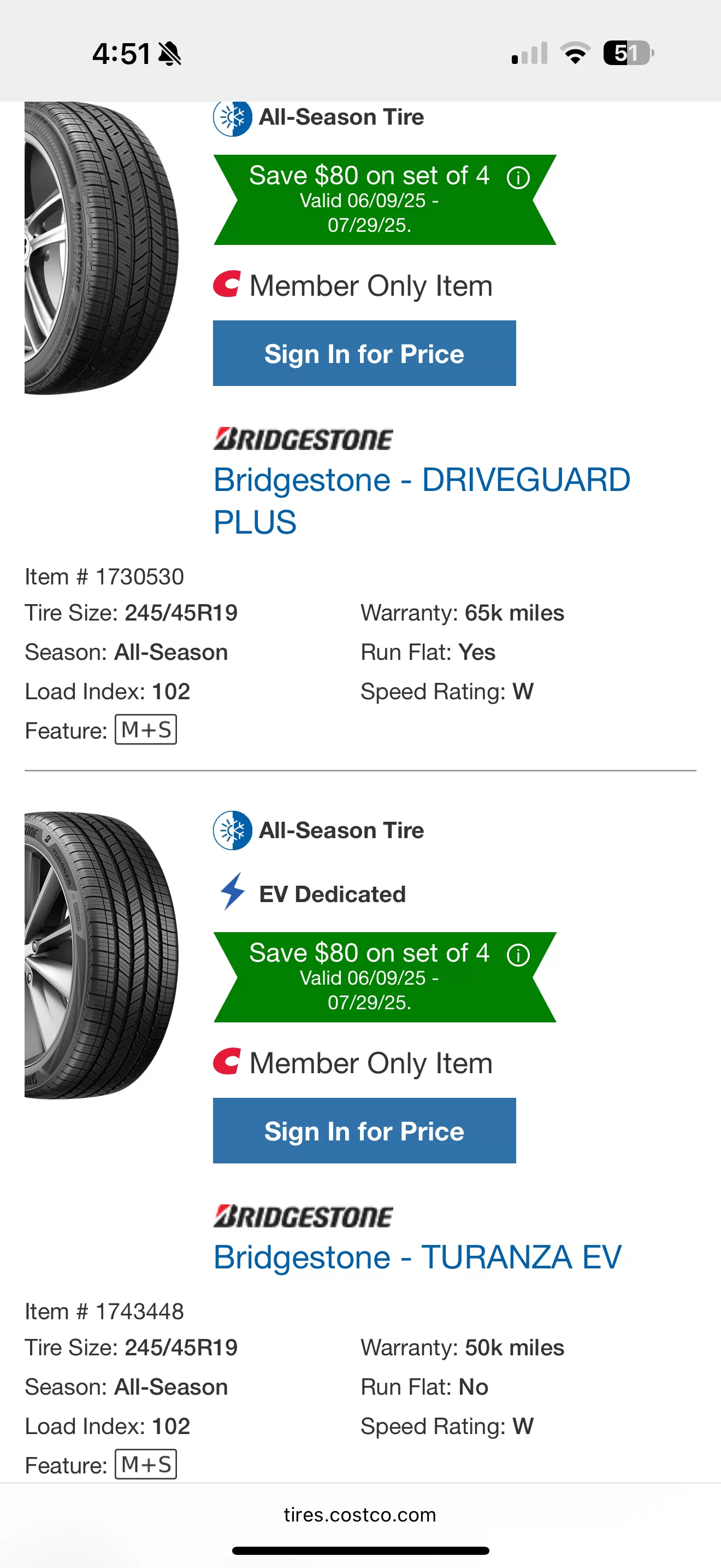

Yes, my plan Is to change all 4 when they say front needs to be changed. Seems links are not sharable once.
