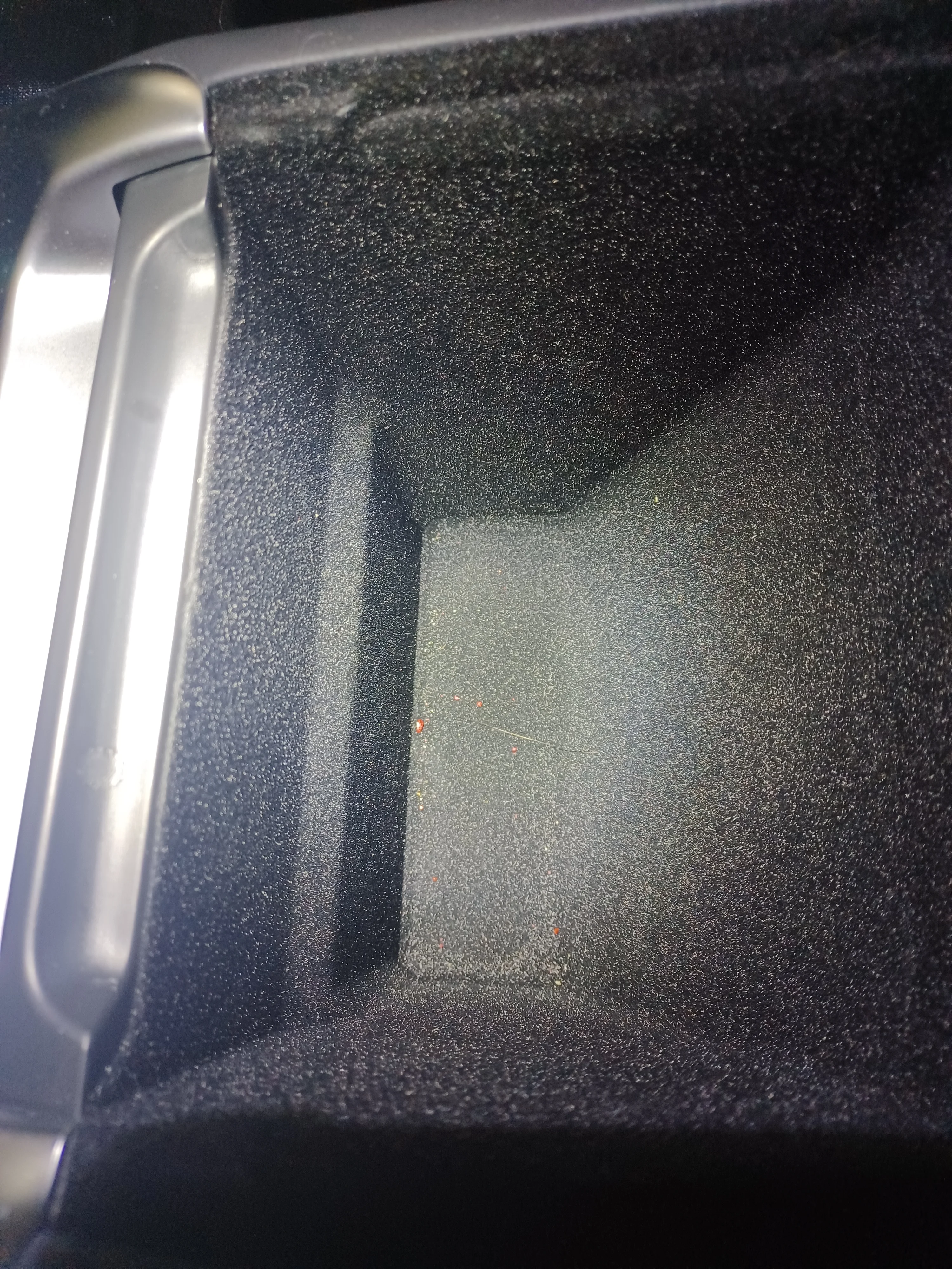

Hahaha. This intrigued me so much that I had to go to the garage and check out mine. That's quite a nice hole someone punched out - I wonder how that happened? I'm including a picture of mine for reference, excuse the red candy flecks. It looks like they'll have to remove the whole center console to get under there. May I suggest you take the opportunity to do a little patch job with some black felt and high adhesive duct tape? Seems like a quick and easy repair with the ugly side being hidden once the console is back in place.

Based on your picture, that hole seems to be where the cupholders would be located.

No, he has an Air and your picture is of a Gravity. It’s not the same but if anything, it corresponds to the back where your cables are kept.
