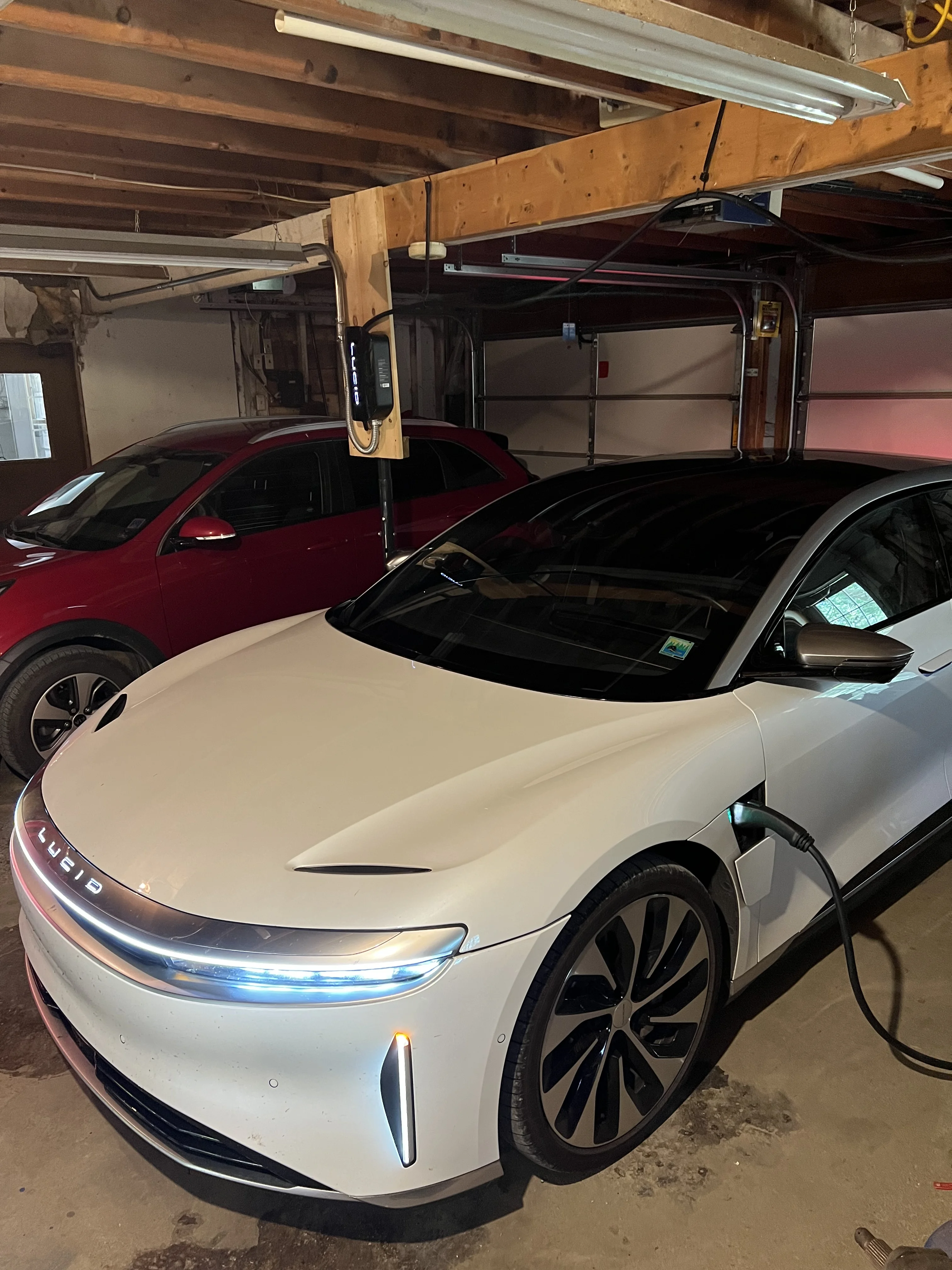

I did similar and then got tired of wet dirty charging cable and strung it via bungee cords to go over the car and drop down net to the charge port.
I currently have a sheep halter hanging down until I can find some nice holster
I have enough cable length to just lay it on the garage floor around the front of the car and plug it in on the left side of the car. Not elegant but very functional.
Same but I thought I’d try it so when I got home I left the car outside and found that it actually reached
What have you got to lose?
If you look carefully you can see that the cable can reach across the top if you want to keep the cable clean and out of the way
Next to clean it up for a more finished look yet retaining the ability to easily charge in the other stall or outside
