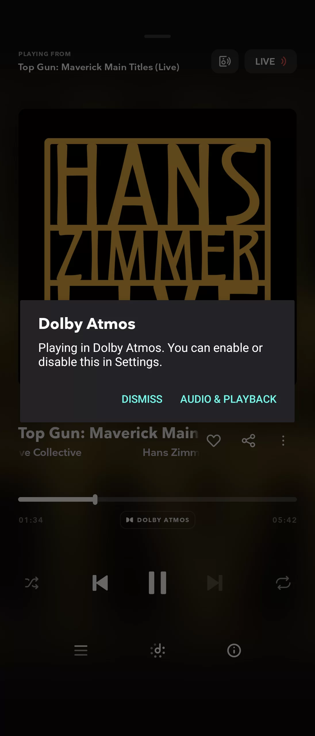

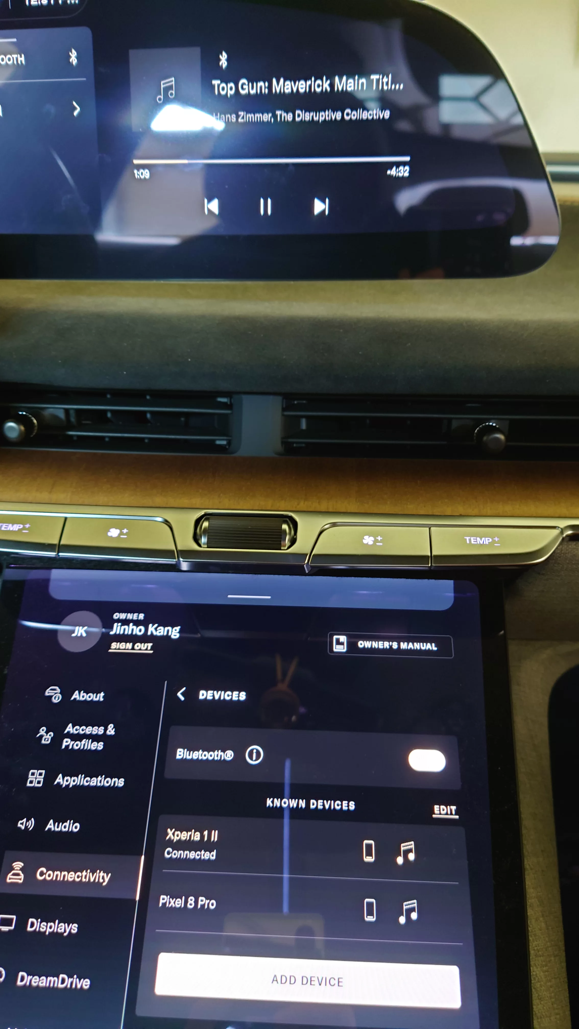

I am however intrigued to try my other phone, Xperia 1ii as it supports Dolby Atmos and LDAC.
