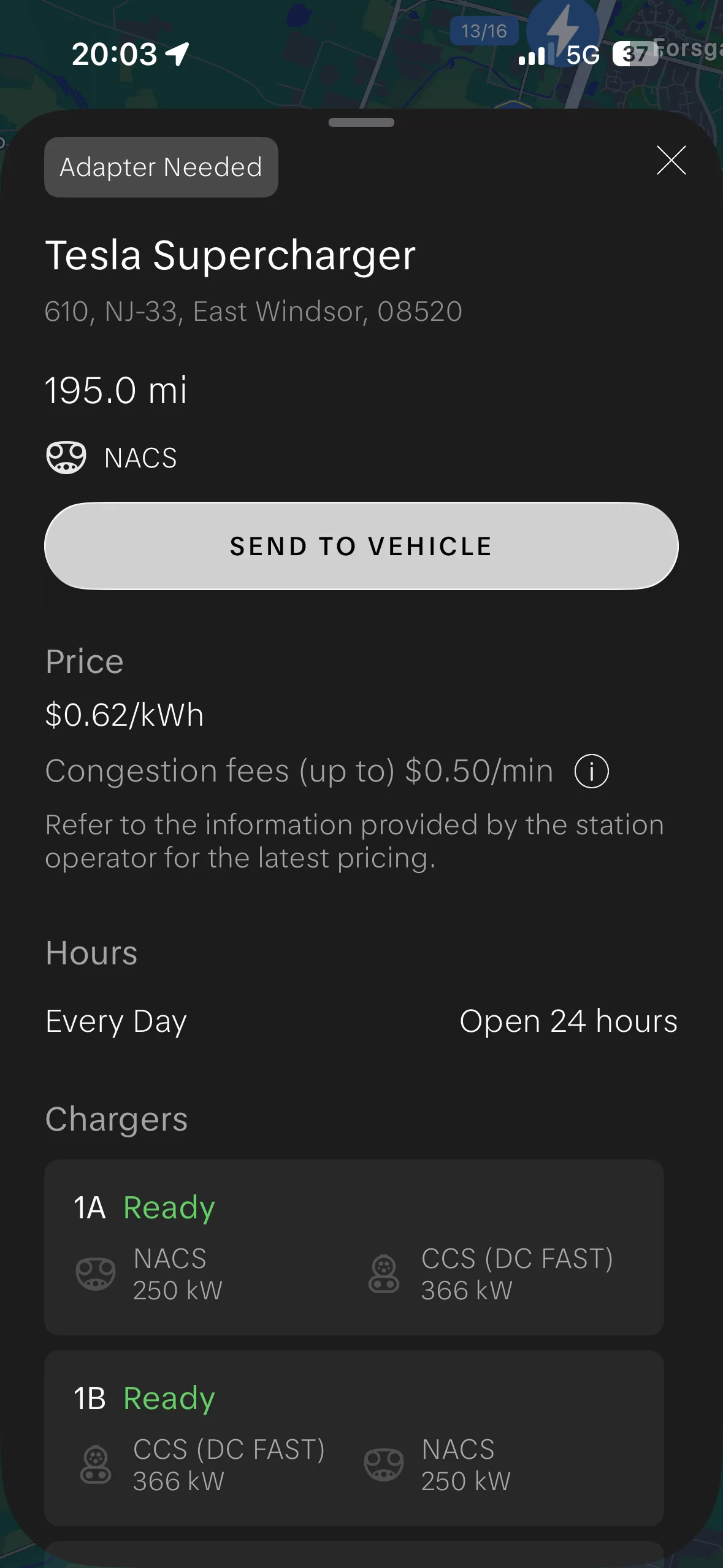

Anybody know what this means in the Gravity navigation phone app? It says if I use CCS adapter at this Tesla I can get 366kw but NACS is only 250kw?
Anybody know what this means in the Gravity navigation phone app? It says if I use CCS adapter at this Tesla I can get 366kw but NACS is only 250kw? View attachment 34207
I thought the Gravity charging at NACS is limited to 250kW due to it having to boost the voltage - not so for CCS. But is seems they would have had to go out of their way to limit the NACS to 400V? This might also have been a limitation of the cabling.
It means "our data is wrong". (I see this a lot.)
