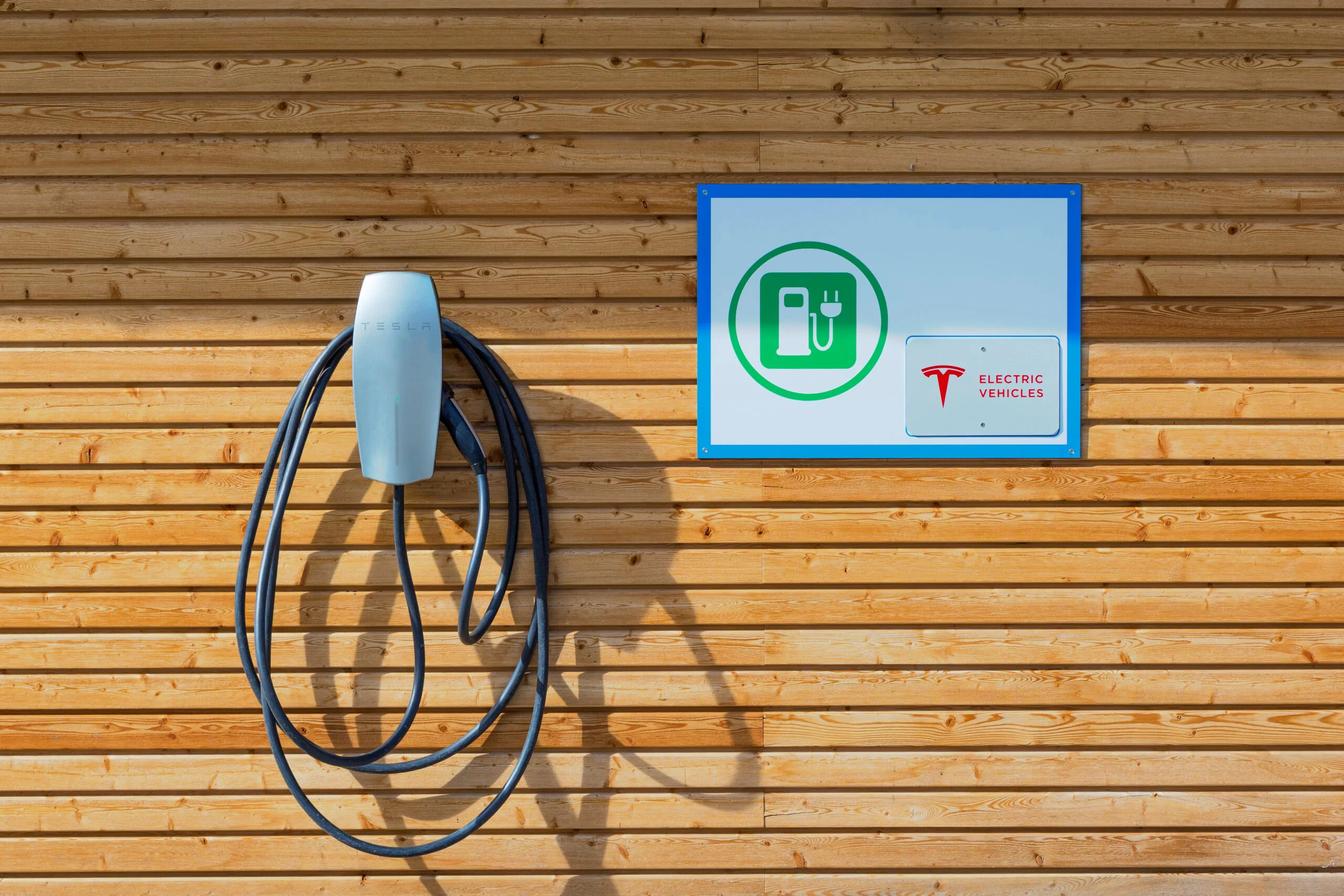

One more thing. What’s a destination charger?
Depends on the charger. Some are free, others not. All run thru the Tesla app unless it's a friend's garage charger. You pay thru the app, either way...
Destination chargers look something like this...
