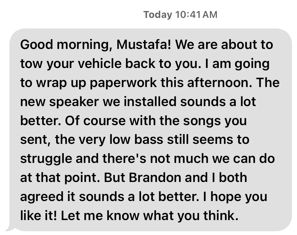

Hello! I’ve been trying to get a quite annoying woofer buzz that primarily comes from the driver side woofer fixed. So far the woofer has been replaced twice - once by the Houston service center and a second time by remote technicians. The car was returned to me both times with it still sounding the same and during this last visit I was told “The new speaker we installed sounds a lot better. Of course with the songs you sent, the very low bass still seems to struggle and there's not much we can do at that point.” The problem is the woofer buzzes on any song that has bass - not just the ones I sent, and it still sounds just as terrible as it did before the appointment.

They did not say if the first speaker replaced was damaged - just that the left side "sounded poorly". I shared my feedback with them so now I guess I'll have to wait and see what my options are from here. Was hoping someone else might've had the same problem and had a solution applied by their service center (that's different than throwing a new speaker on and calling it a day)

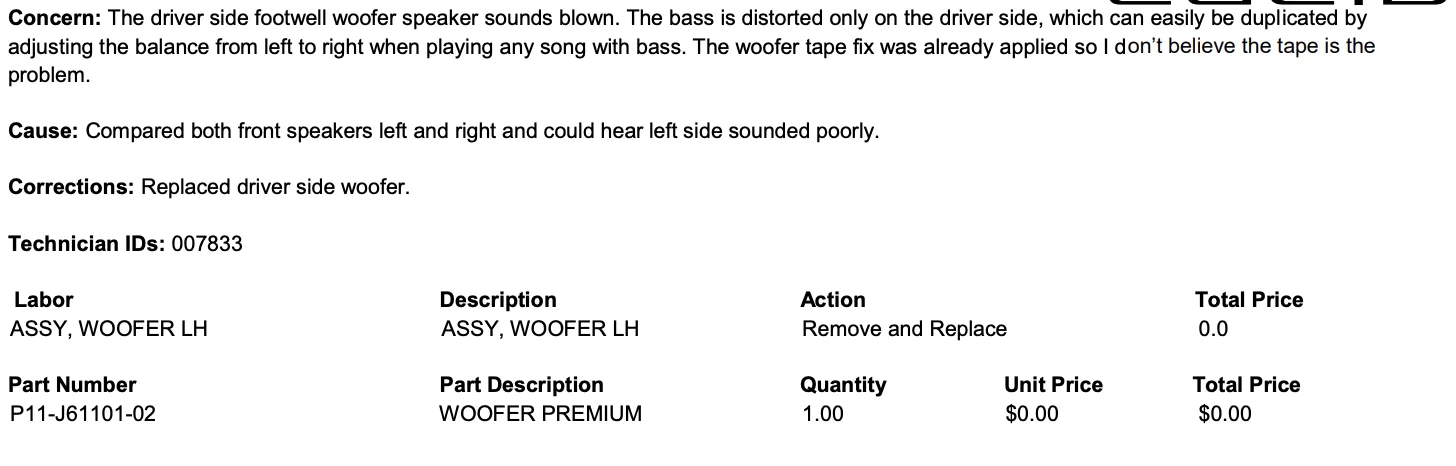

First repair attempt by the service center in houston (1/30/25) -

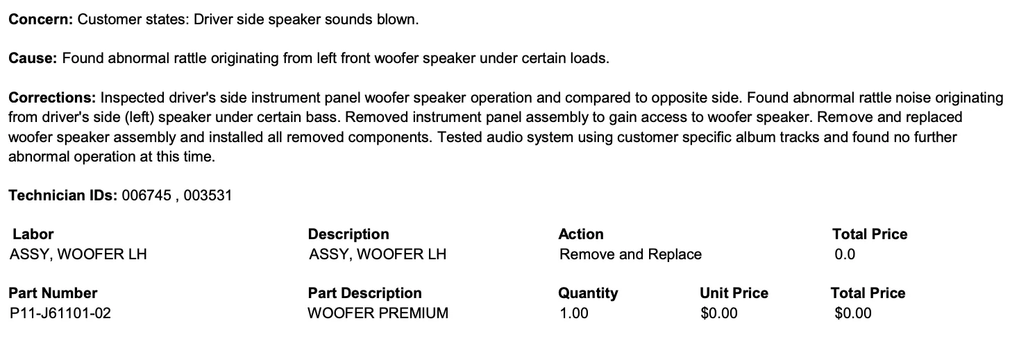

Second repair attempt by remote technicians (2/27/25) -
