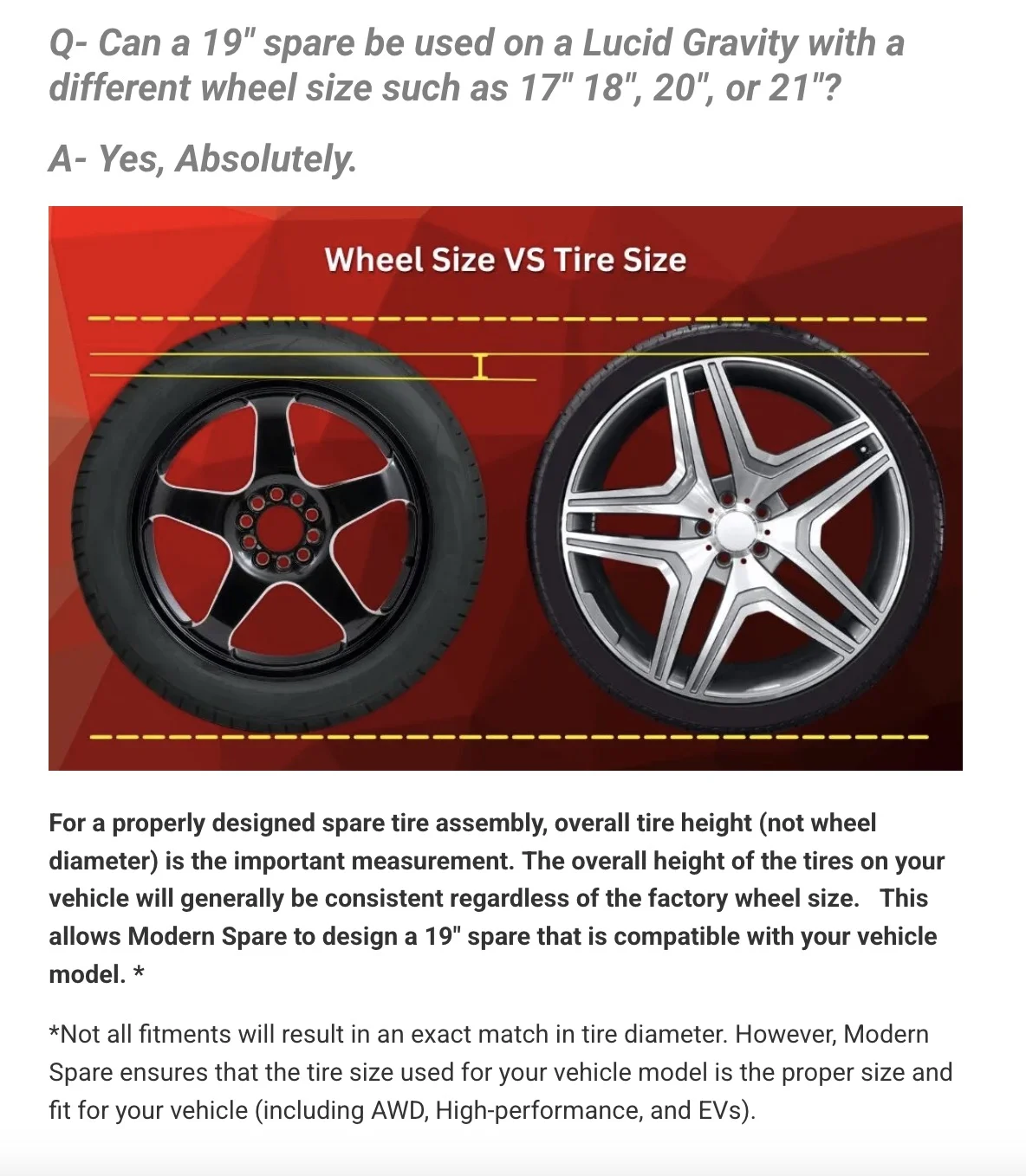

Here's the description from the Modern Spare website. I hope they're right as I just ordered one yesterday for my GGT. Their temp spare tire is 28.8" rolling diameter and is very narrow -- under 6". The wheel is specifically offset so that it places that skinny spare in the middle of where the stock tire would be.

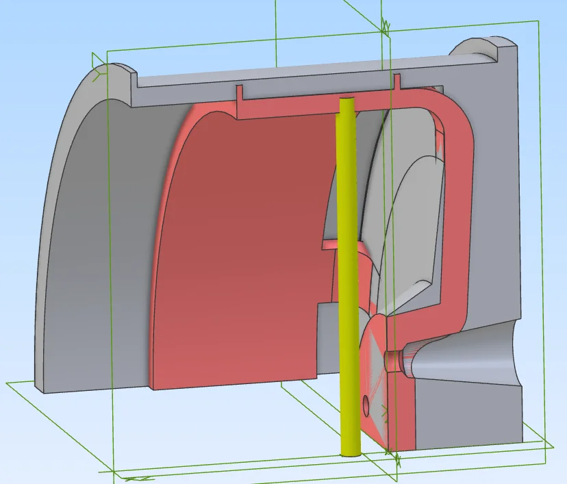

Was curious how the offset would work so I made a crude drawing just measuring from what I could see and the specifications. The offset looks doable but regardless of the hype shown #12 above from the web site, this is what a 19 inch wheel would look like in red with the 20 in gray. The yellow rod is the approximate location and distance from the wheel of parts of the rear caliper. Surprisingly the front caliper OD is smaller and would probably fit the 19inch. I didn't do extensive measuring or modeling, could be wrong.

Also if it is 155 80R19 as shown on the web that 28.8 inch rolling dia is 7.5% smaller than the rear. I thought 5% was the cutoff, don't know where I read that.
By the way I investigated whether a Rivian 20 inch collapsible spare might fit. The rolling dia error would be ~1% but the bolt pattern is 5.5 in. dia not 120mm and scaling the pictures it looks like the collapsed dia would be 24.7 inches which still doesn't fit below the floor or in the frunk! Maybe that's why Lucid doesn't offer one.
