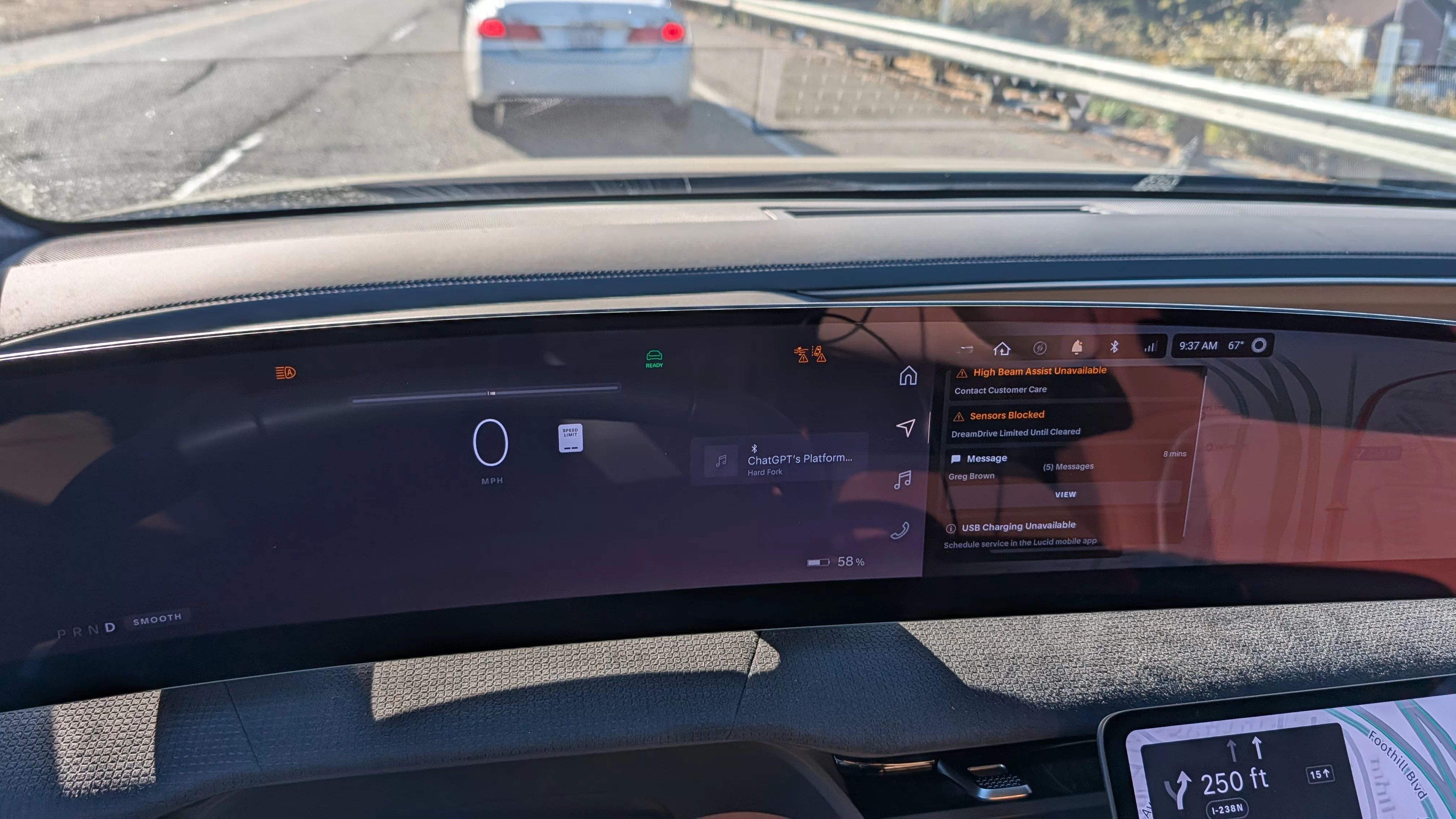

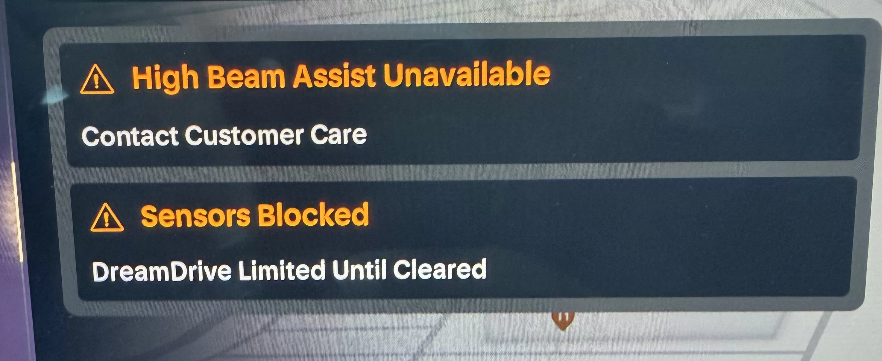

Anyone else getting DreamDrive limited errors? I get it about every other day. Once it happens I lose lane departure assistance, DD and it tells me I’m drowsy. Yes the sensors are clear (washed the car). It resolves with a reboot.
Yes, happening to me infrequent but happening.
Yup, I get them all the time. Pretty sure it just happens when the sun is bright and low so the sensors get blinded.
Yes, I’ve had this happen a couple of times or it’s just not available. I don’t think the constant rebooting the car does helps this in any way.
Mine is permanently in that state right now. None of my cameras are working for parking assist, lane changes or Dream Drive. Yet it still lets me engage Dream Drive most of the time.
I was leaving the highway on a uphill with a sun right in front of me. Sun was still pretty low, but strong. The second I stopped on the lights I got numerous errors and had the same things disabled. Lane departure, collision protection, and high beam assist alert icons. Alert for sensor blocked. Just like you I assumed the senors were blinded by the sun, but I assumed it will fix itself after a few minutes of driving, but it never went away even after parking in dark garage. I ended up doing a hard reboot and that cleared those errors for me.
