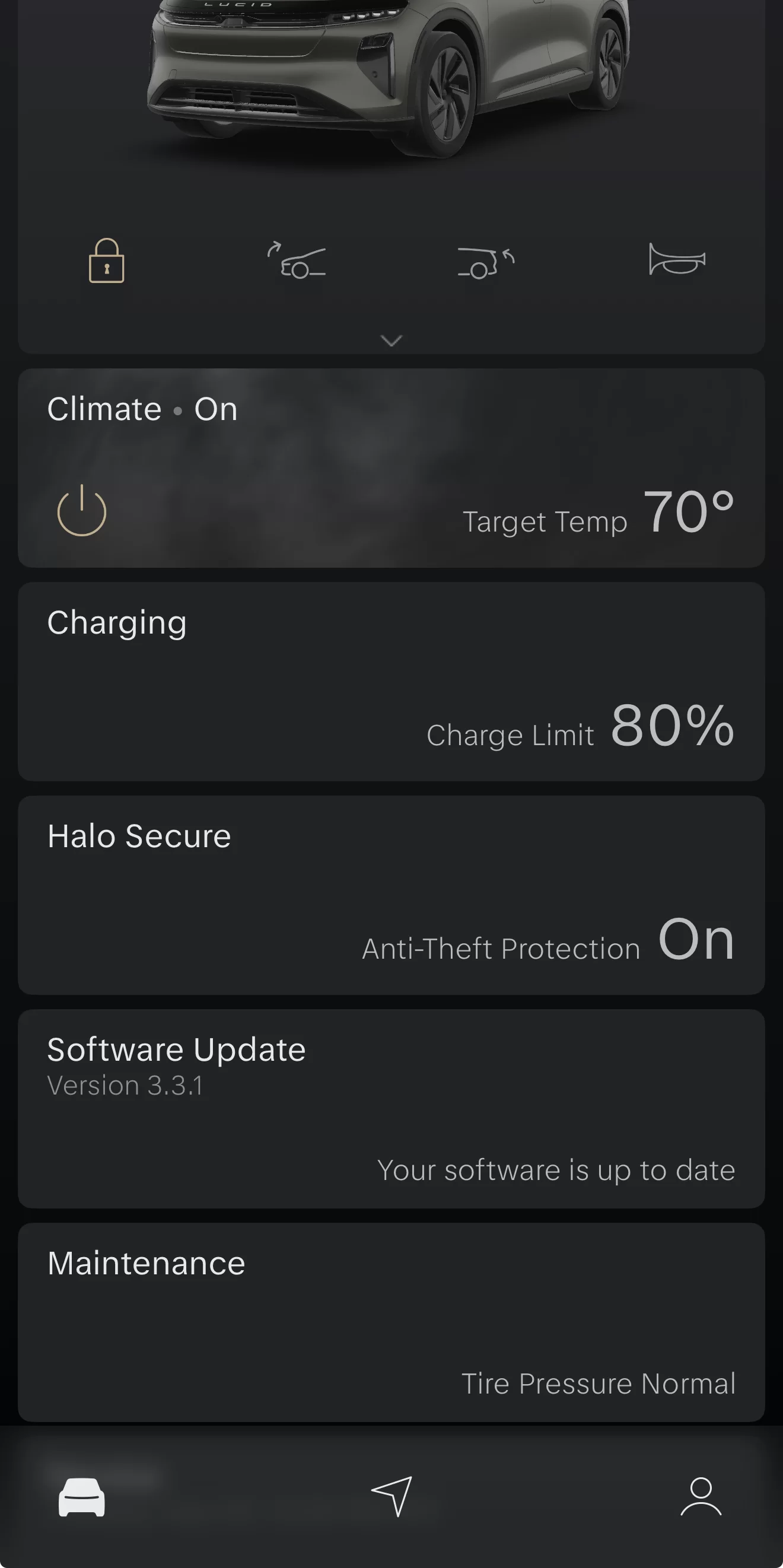

I have a disconnect between my app and the vehicle. The App shows Version 3.2.2 but the gravity itself shows 3.3.1. Any ideas for how to reconcile the two? I tried deleting the app from the iPhone and reinstalling. Its preventing me from using the "Live View" feature.
I updated the app a few days ago also and didn’t have issues but when I upgraded to iPhone 17 yesterday and logged back into the Lucid App on the new phone the “Live View” tab has been missing ever since.
I would try like someone else had mentioned and uninstall the app and reinstall it from your phone. It's possible you don't have the latest version on there. No idea how much testing has been done for the app and the iPhone 17 family and if there are any issues with it....hope you can resolve that one quickly.
Yes, that was the first thing I tried. The app is definitely up to date.
Tried the old log out and log back in trick to no avail so did your recommendation and deleted the app and reinstalled. That fixed it and the live view tile is now back and functioning :)
