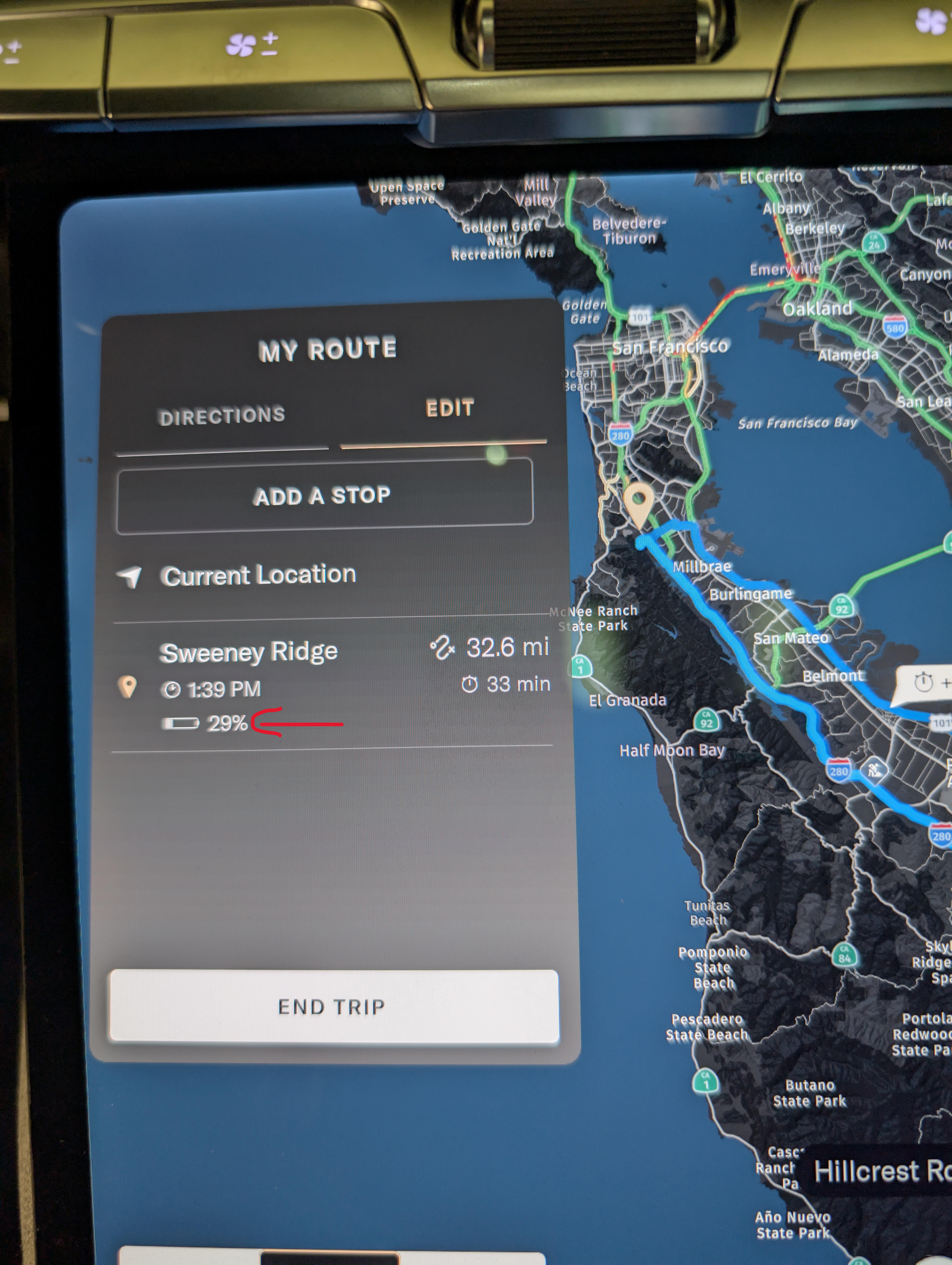

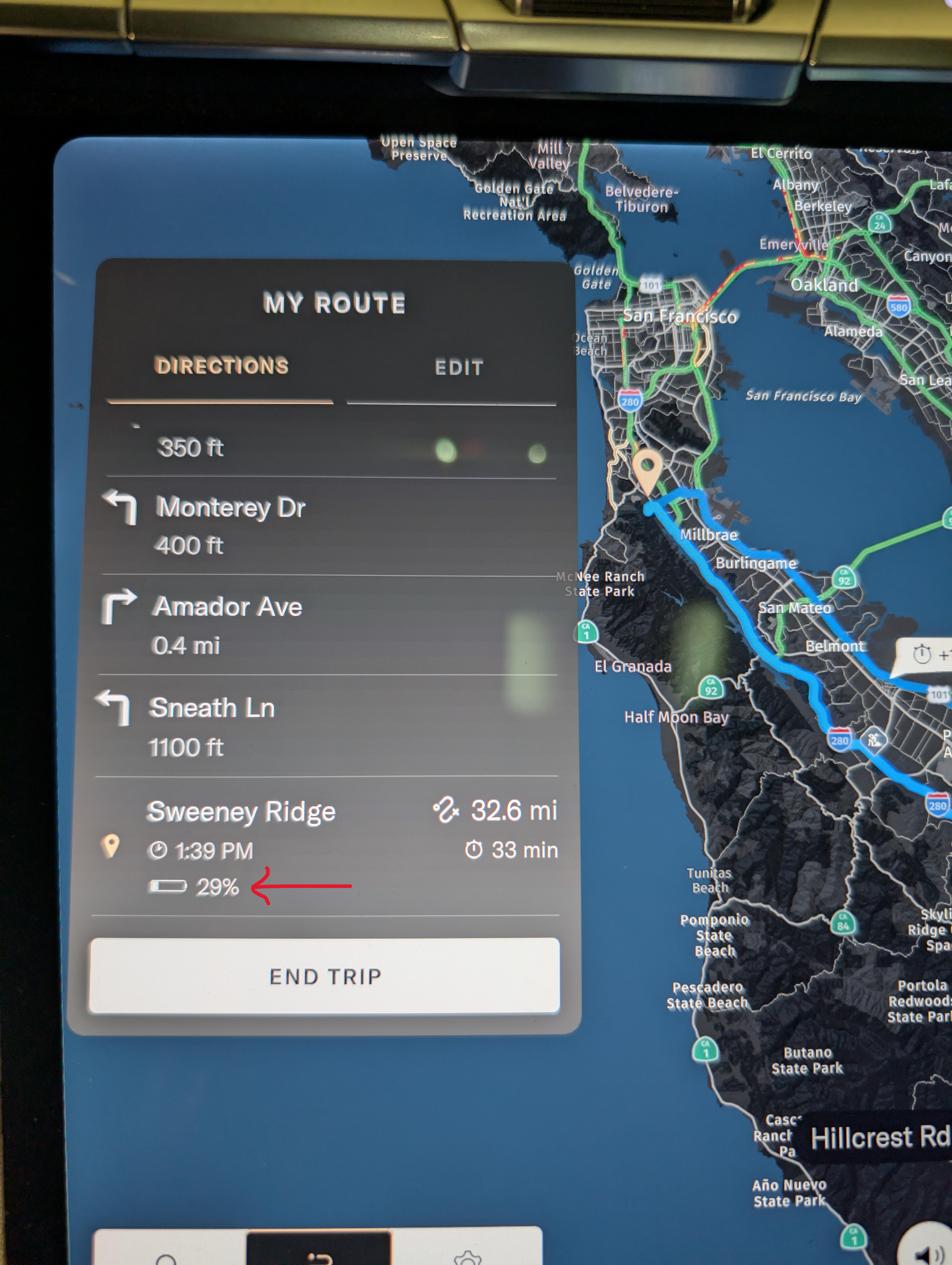

Lucid's nav software does do this when you enter a destination. It's normally pretty accurate.
Thanks. Where? I'm on 2.5.4 and regardless of whether I have the display units on miles or percentage, the capacity at arrival is on the main screen as miles and I don't see battery soc on arrival anywhere?
