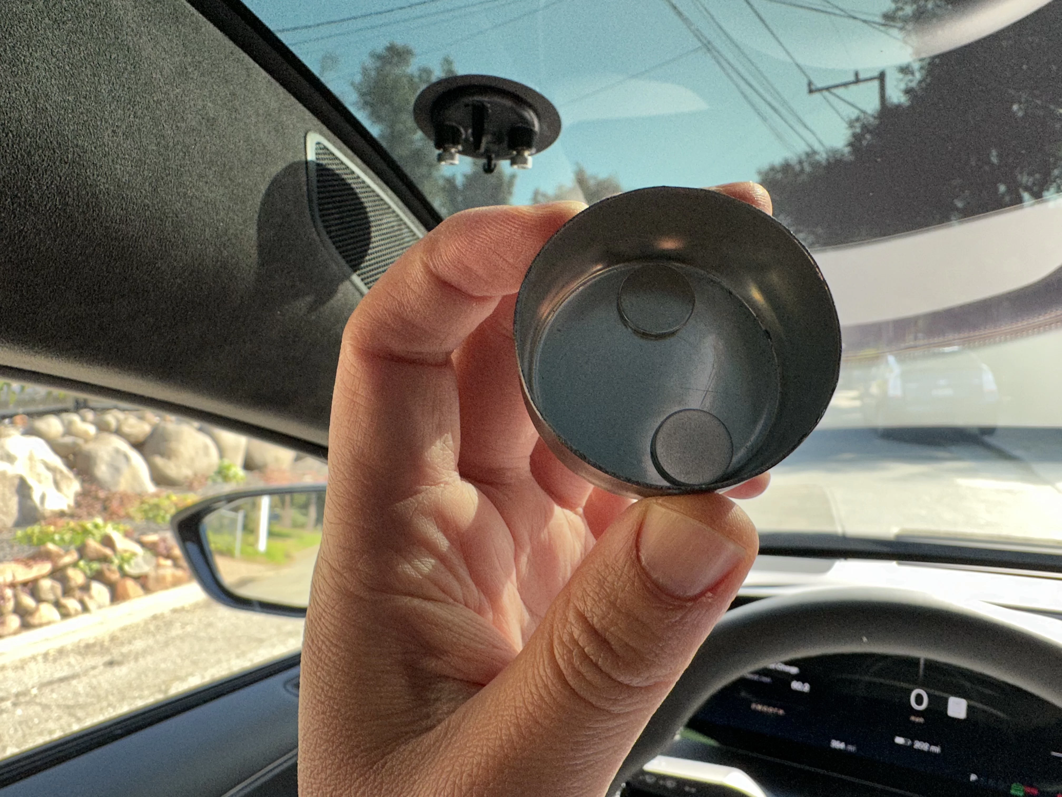

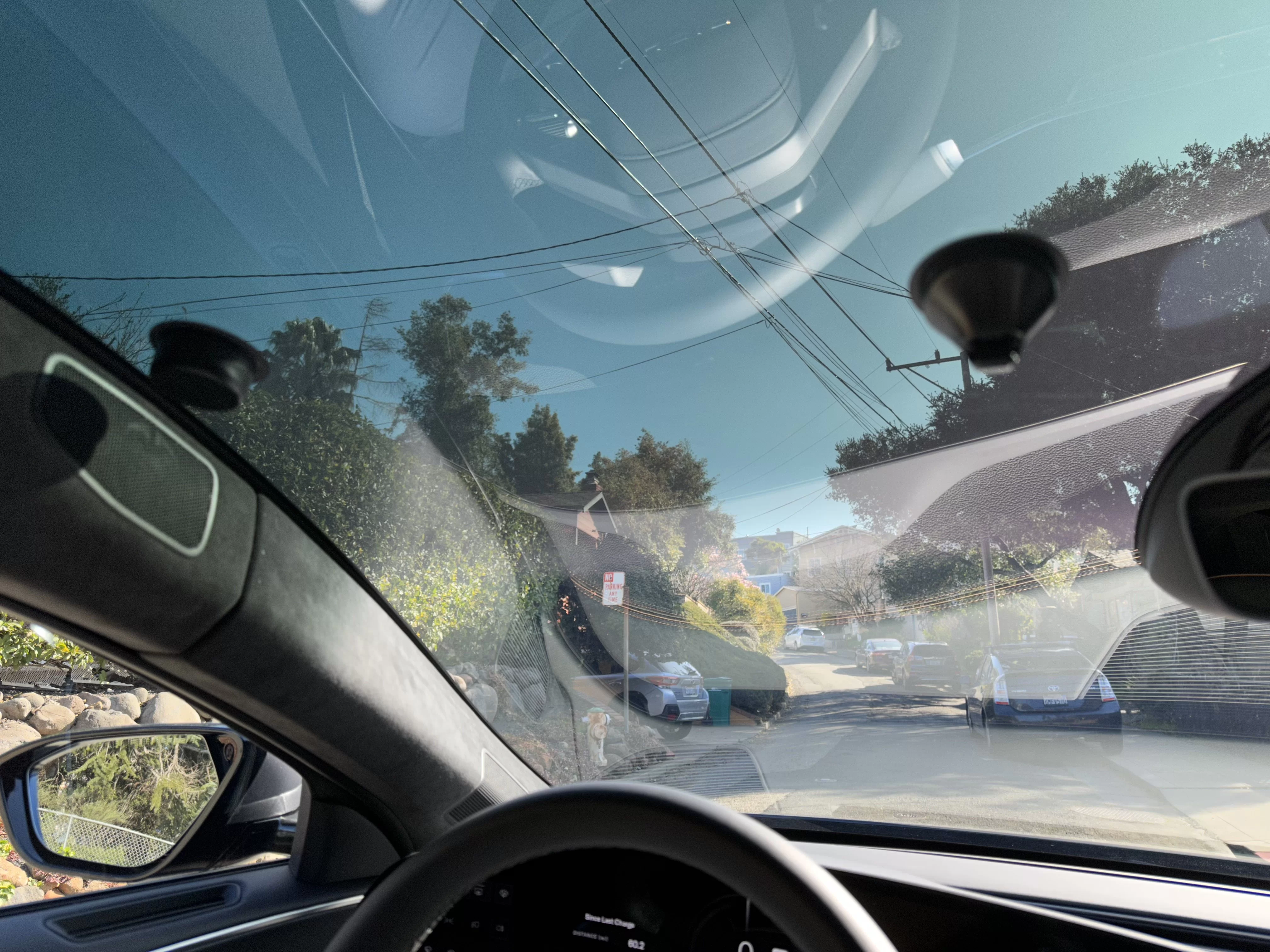

Sharing a nice way to make your removed sunvisor look good in the car.
Bought a pair of aluminum caps, spray painted the outside matte black then put two adhesive neodynium magnets on the inside (sticks to the mounting screws). It's a perfect fit, removable and easy to restore to factory if you change your mind. Enjoying the wide open air with it!

Can you link the caps you bought?
9275K192
Fair warning, the aluminum caps are just cold pressed so i had to clean up the edges. I have access to a lathe to make it super clean but you could do it with a file and enough patience :)
What's the easiest way to remove the visor? I am terrified of touching this car lol, so a guide would be helpful
I had my detailer do it since they have the right trim tools. AFAIK you just pry the plastic cap off and unscrew the two torque bolts. If you have the right trim tools it’s pretty fast.
