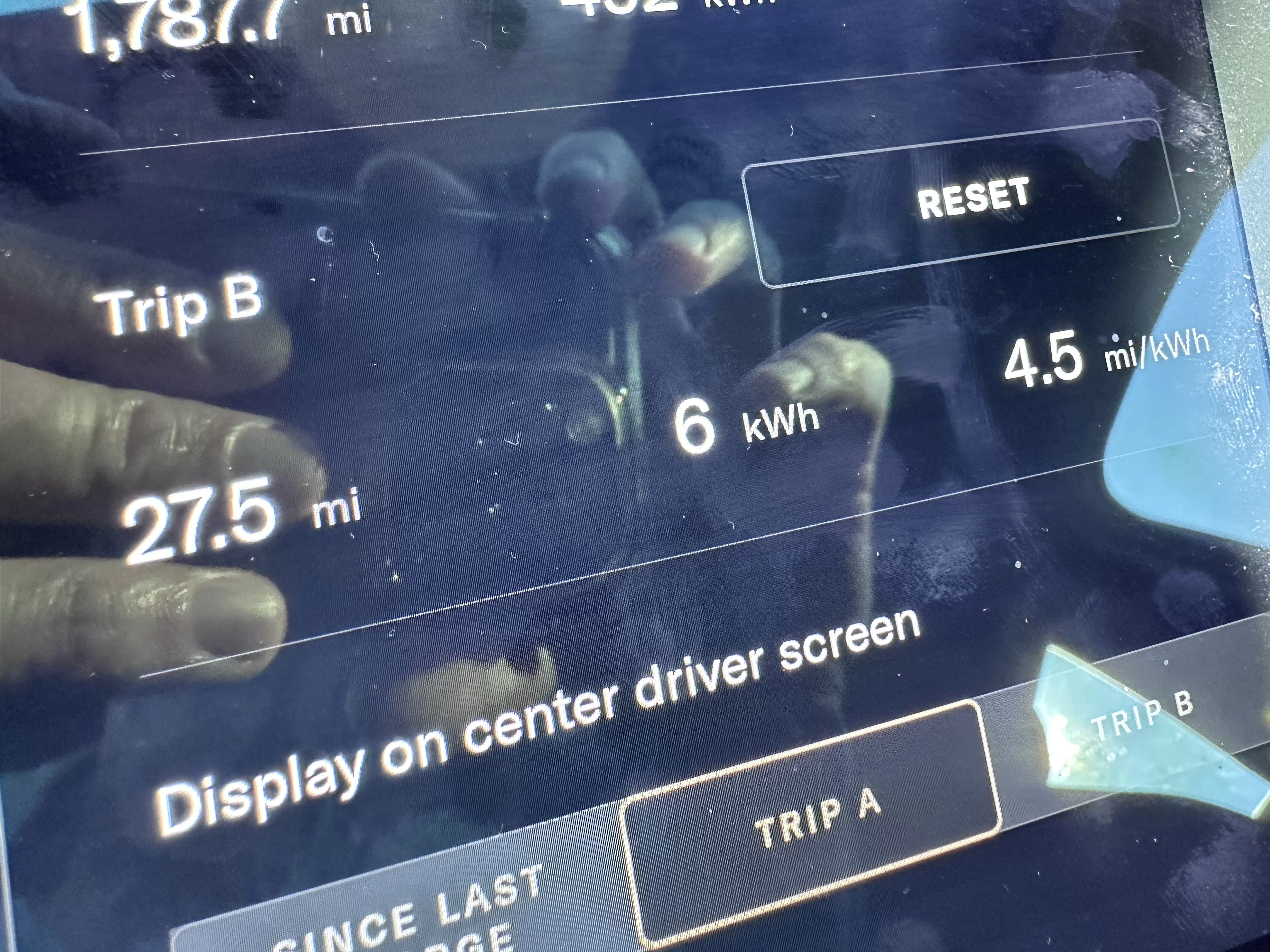

This is a recent pic of my Touring. I usually reset A when I want to track efficiency. My Trip B is all time driving. See how trip A is slightly better than “since last charge” due to Phantom energy use.

well, I figured it out
Driving around with the A/C on uses about 30% more juice. I normally don’t turn it off here in LA, so it’s just running in the background. This trip was a mixture of highway and traffic, and I averaged 4.5mi/kwh. Big jump!! Who would have thought.
