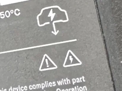

What do you means by this
« The cable alone is not enough, you also need the correct version of the mobile charging cable kit (v2). »
The cables that originally shipped with some of the Airs (early on) did not have V2V capability. Newer ones do. There is a symbol on the charging cable that indicates it.
The V2 mobile charger has this image on it:
