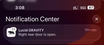

I locked the door…but wife didn’t shut it.
