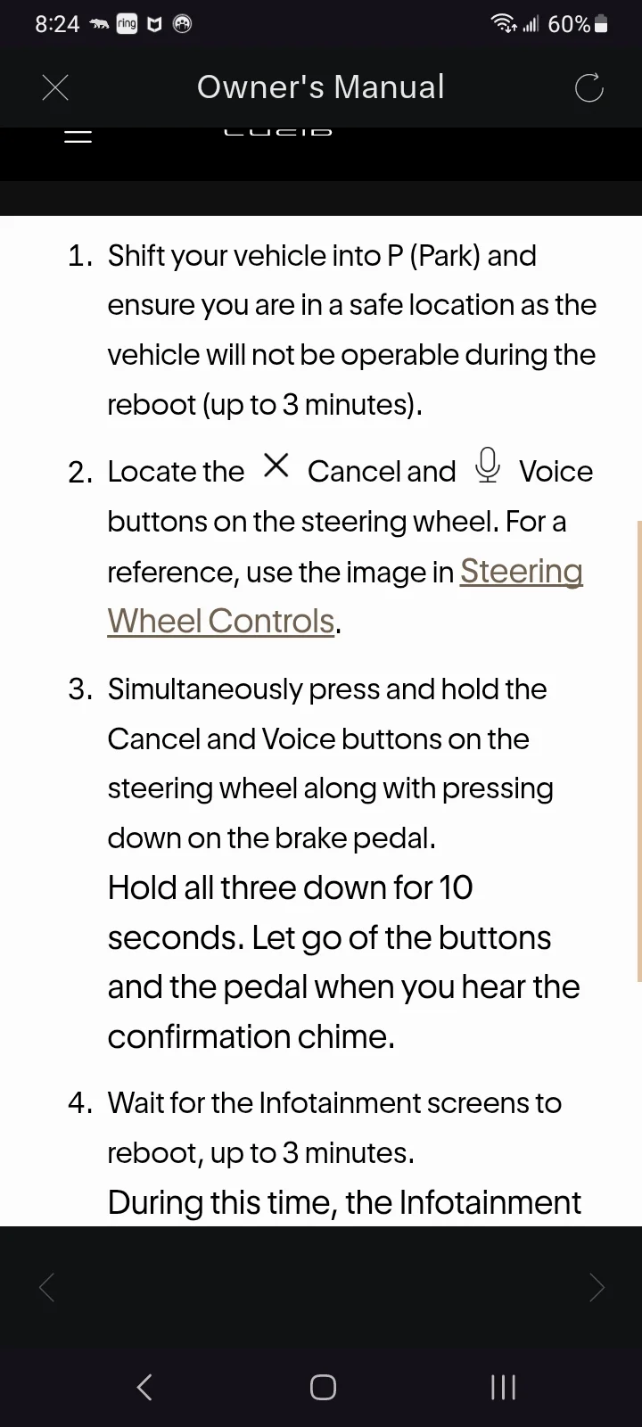

How do I do a hard reboot???Do a hard reboot (steering wheel one) if you are getting those error messages. I had them show up on an earlier update and that resolved the problem. If not, call customer service.

Thank you, I just did that. Hopefully, that will work. I will let you know later after we drive it .From owner's manual
The Air Logo reboot and the ānukeā reset are precisely the same; they are reboots of the infotainment system. If one didnāt fix it, your next best bet is a full sleep and wake up.Which reboot do you typically do @borski? Air logo? The only (and minor) ongoing issue I had after 2.6.11 was getting the upper display to stay on the home setting. The Air Logo reboot didn't help that one.
