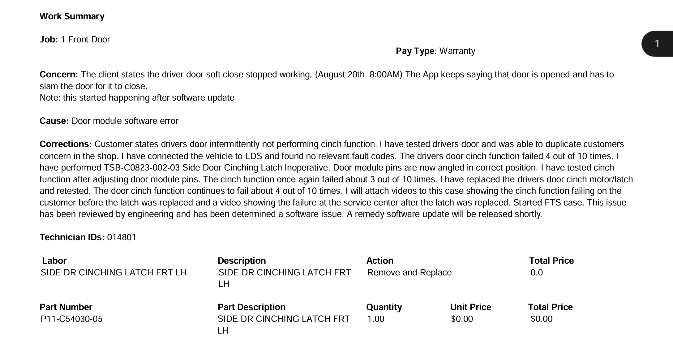

Is it wrong to be upset my brand new 6 figure car doesn't work as advertised? I know its such a small issue. But it 's something i use alot. My other car is a BMW XM and all if my previous cars from BMW/Audi have had soft close that has worked flawlessly. I feel i shouldnt have to slam my "luxury car" door. It was hard enough training everyone NOT to slam my cars doors over the years.

As per SC notes this is a software issue not hardware and will be corrected shortly with the next release. Just be patient. Having the car for one year, one thing I learned is to be patient. Things definitely improve with consistent software updates. I am sure many here can agree.

I think you read my post wrong or I wasn't clear. I meant soft close door wise. and not being able to fix it now. This car was in for many issues 1 day after purchase. Rear truck motor died, 3 tires needed to be replaced, Rear deck was lose and rattled (again at 1 day old) And i didn't complain about that because it was fixed. I'm not expecting a perfect car and ok with it getting fixed...but this isn't getting fixed and no timeline except "soon" and we just had a major software release 2.4 and it wasn't in there. So who knows at this point?

What is it you’d like someone here to say? Agreeing with you just serves to commiserate, which is hard to do because it’s a pretty minor issue, all things considered, and they tried to fix it via hardware multiple times, despite knowing ahead of time it’s likely software, so now it’s waiting on a software fix.

i think you finally got it it. I am asking because i want to see if I'm being unreasonable or if others feel the same way or again as you mentioned if the consensus is "it's not a a huge problem so just wait it out" Also maybe someone might chime in on Lucids history of fixing software things...are they good at it or bad at it. Seams some things they fix quickly and some not so much.

I suspect they'll fix the soft-close issue sooner rather than later (assuming they can identify the bug) because it is affecting more than just a few people, it seems. But I don't know for sure; the thing that tends to define whether Lucid fixes a software bug faster or not is the number of people to whom it is occurring. That makes sense intuitively, from a scheduling perspective, as well.

Thanks for posting this. My last service visit for an unrelated issue also has an almost duplicate correction description. I'm waiting for a software update to fix this (it broken with 2.3.10 for me I think)
I picked up my '24 Touring last week and I think the soft-close function on the driver's door has failed to work about 30% of the time. Every other door has been perfect. The car is already back at the SC for the blown speaker issue, but I've asked them to look at this failure, too. Hopefully they can fix it.
