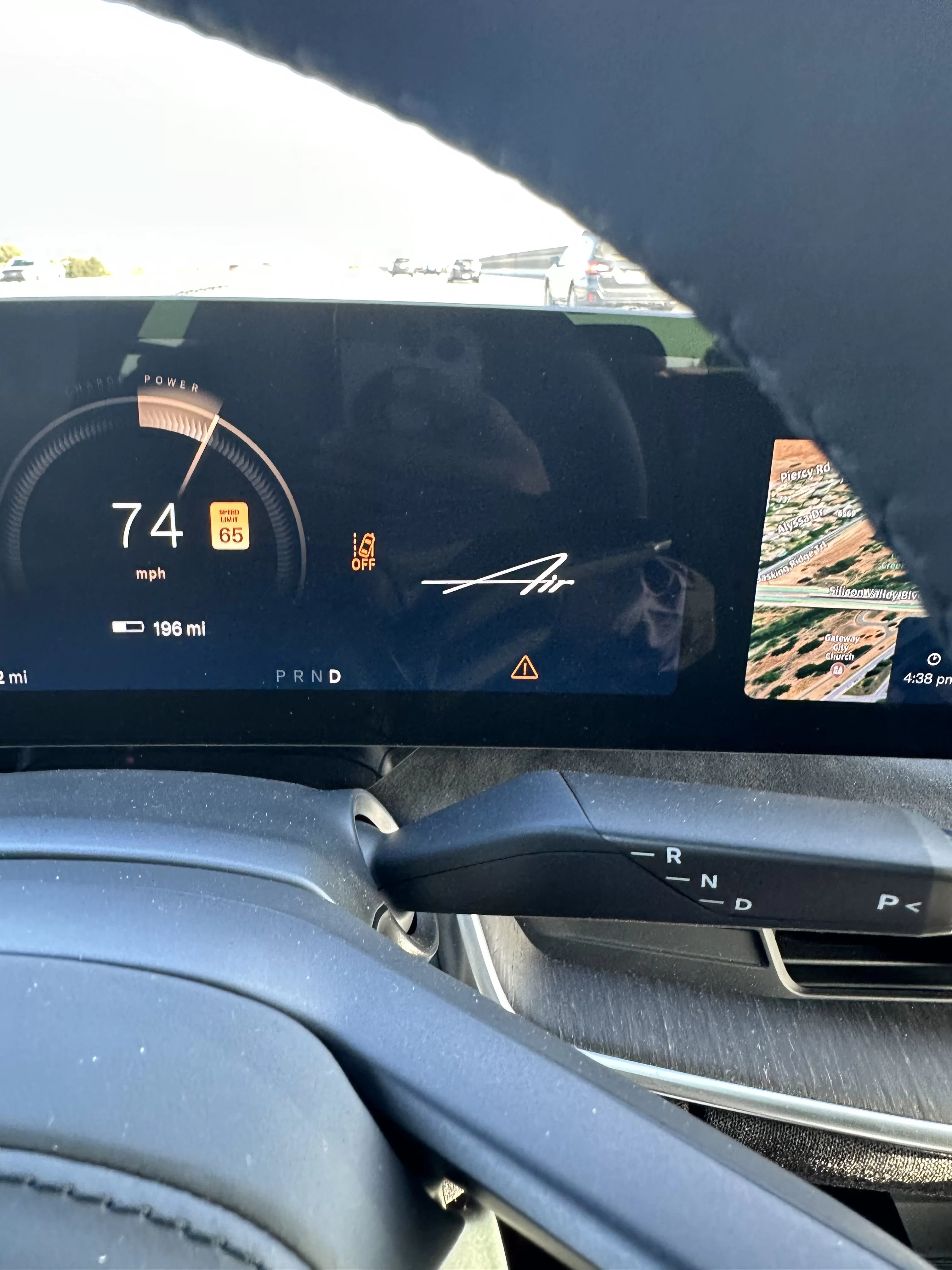

Got the delivery of Air GT a few days back. Still trying to get the hang of a few things. Previous car is 2019 Tesla Model S 100D.
Here are a few questions:
1. The car is giving an error message (see image where the error sign is below the Air logo) - but it is not clear to me where to go and see what exact error is this, and how should it be fixed. Any ideas?

Congrats and welcome!
You should contact service to find out what that error is.

For the error icon, isn't that the lane departure warning is turned off indication?
Lane departure, I have switched off myself, since it annoys me. That is fine.
There is an error message below the Air logo, which I can’t figure out. I suspect it has to do with front sensors (below the Lucid label in the front) getting some dirt. But really not sure. And cleaning the front of the car hasn’t made a difference.
Does it give you a warning when you first turn the car on? I've seen that triangle mostly for parking sensors.

Did you have PPF applied to the car? If they covered the sensors with the PPF and didn't cut out holes for them, you will get an error.

The error is a "System Alert" .. I would definitely contact CS (or a SC).

So, regarding the error message (yellow triangle), here is the conclusion.
Chatted with their customer support through the app. They suggested that I should get the car checked out by Lucid. They arranged the service appointment the following week. An hour drive to bring the car to Millbrae service center. They arranged a loaner from Hertz (Range Rover). Kept the Lucid for one week. Diagnosed that the problem is one sensor in the front bumper got hit by some object and is malfunctioning. Asked me to pay ~$500 to get it replaced. Which I did. They ordered the part. Once they got it, had it painted the same color as the car (Zenith Red). Installed it and checked everything. All worked. Returned the car to me.
Have been driving it for 3 days now and no error message. Everything fine.
I am glad to get the car back.
Of course, I am not super happy that Lucid put such delicate sensors in the front that they can get damaged so easily (the car is barely 2 weeks old), and that Lucid decided that they will charge me for it, instead of covering it as a courtesy.
