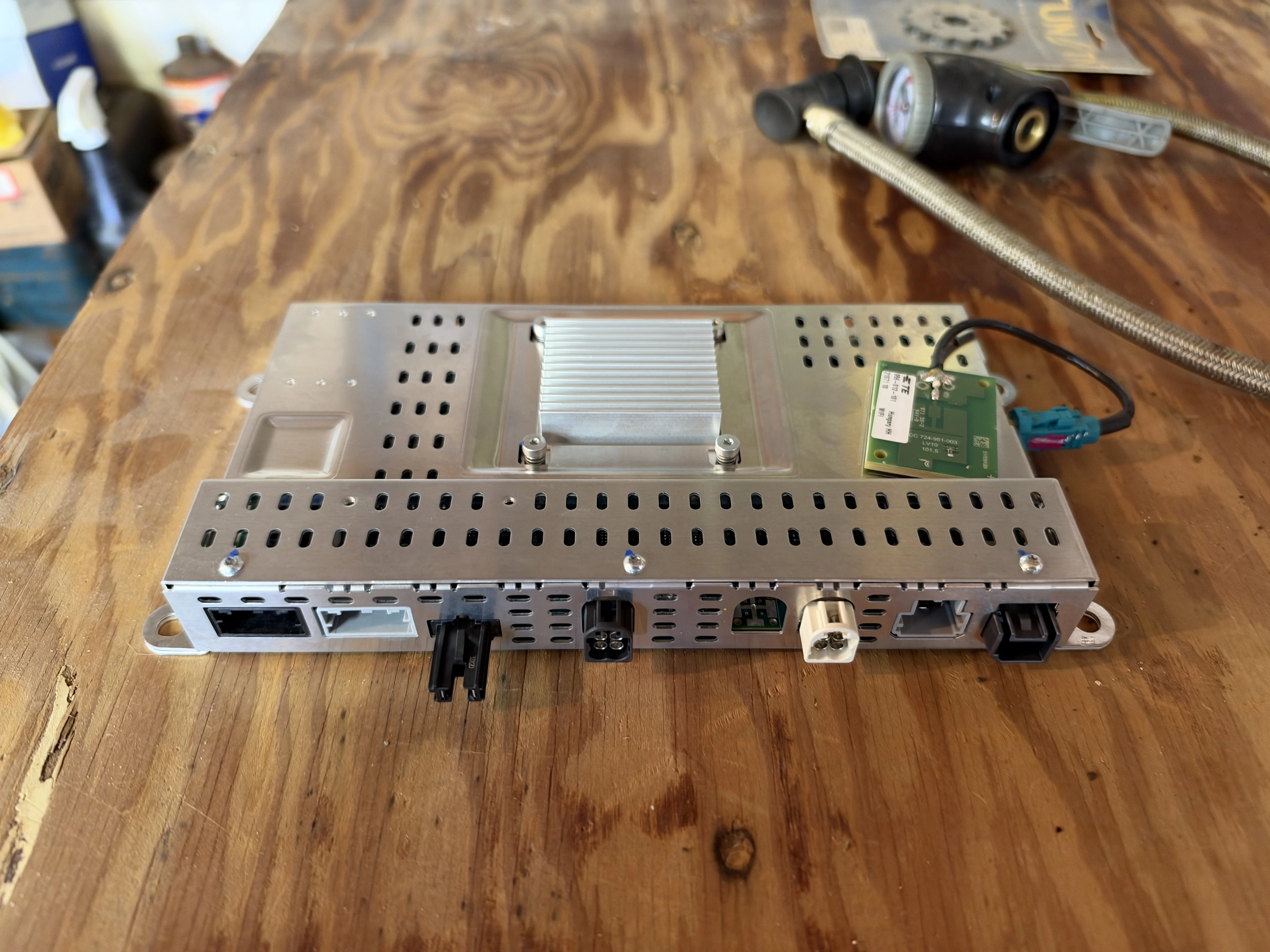

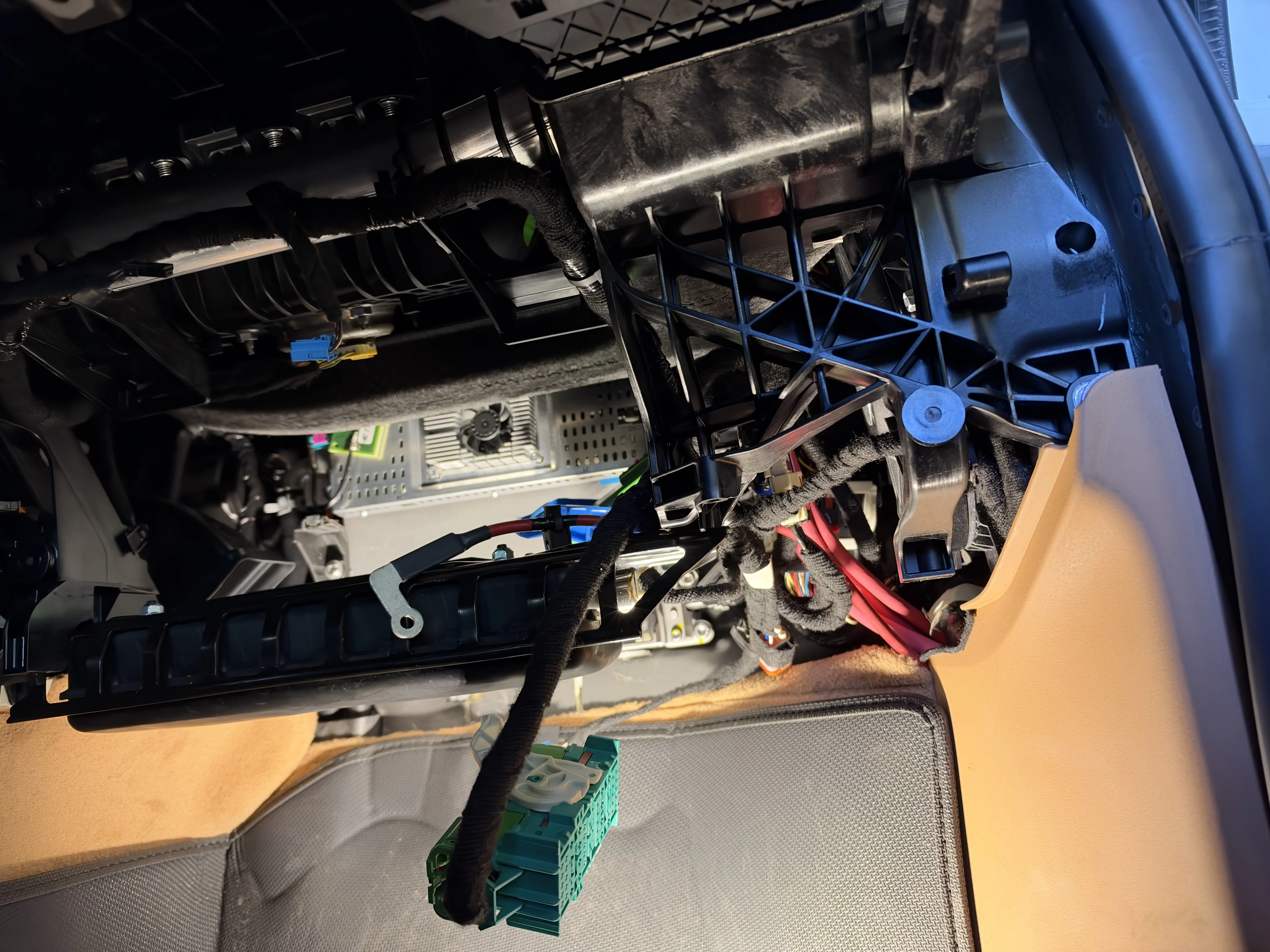

Mine is being installed as I type this. I’m on the deck drinking coffee and R is in the garage doing the major service and cccv2 upgrade. I’m going to keep the old unit for educational purposes, might ask if he has another knocking about so I can have two to break.
If I can I’ll try to grab a photo while he’s got the car apart.
Here’s a couple of photos
In the car, behind the glove box, in v2 bigger heat sink with active cooling (fan).
The other is v1
