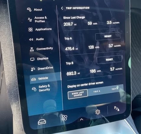

Thank you for the details. It makes sense now. I don't use the miles remaining display but only SOC% because as you point out the miles remaining uses the EPA efficiency for its calculation. I probably would have done 209 miles/ (.69*92kWhr) = 3.3 mi/kWhr. The result is the same.Sure. I did a very simple calc based on my total estimate of range as follows.
On the way there, I calculated that the actual mileage I got in the car was 71% of the stated EPA range. More specifically, I left the house with 100% battery or 425 miles on the car’s estimated range. When I stopped to charge (since my wife wanted to stop) we were at 31% Soc or 131 estimated range left in the car. The difference between 425 and 131 was 294 miles of estimated range used while we actually had driven 209 miles. When you divide 209/294 you get 71%. So assuming I get 71% of the left over range on the car, the car’s total range would be 425*.71=302 miles. So a simple 302 miles / the battery capacity of 92 kw= 3.28 or 3.3 miles per Kwhr in the car.
I did the same calc going back home and got the lower 2.9 mile/kwhr when going above 80 for most of the trip.
I am curious about the difference between the calculation and the since last charge number because I have not seen that type of discrepancy before.
