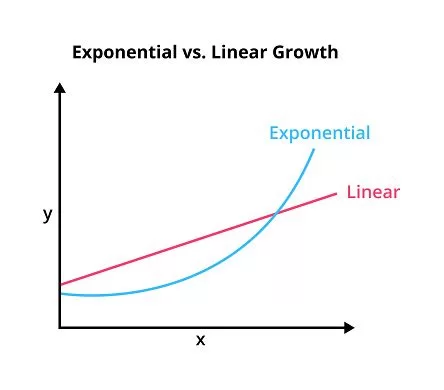

The dependence of air resistance on velocity​
The force of air resistance clearly depends on the velocity of an object moving through the air:
the larger the speed, the larger the drag force.
F (air) = Kv^squared
( the difference between 70mph and 80mph is HUGE)
plotting this will give you a exponential graph, with higher velocity requiring hugely increasing amounts of power.
However, at low speeds,the air resistance grows linearly with velocity:
F(air) = Kv (plotting the difference between 28 mph and 50 mph is almost a straight line)

I was under the impression is was more or less common knowledge that efficiency decreases exponentially with speed. That is to say, the different between 40 and 60 mph is not the same as the difference from 60 to 80, which is not the same as 80 to 100, etc.
Not only is the drag increasing with the square of the speed, but there are non-linear costs associated with drawing power from the batteries due to losses associated with higher currents. In other words, if you need to double the amount of power going to the motors, it's going to cost you more than double in terms of energy expenditure due to the increased losses. All of that to say, you have quite a few factors working against you as the speed increases.
