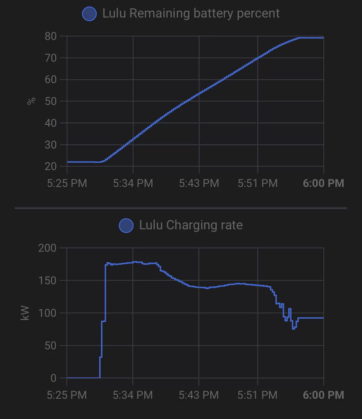

Here is a recent charging session I was very happy with:
This was on a balanced 350, and I was pulling 177kW immediately, since the other Mercedes was also pulling 175ish.
21% to 80% in 27 min on a glorified 150kW charger.

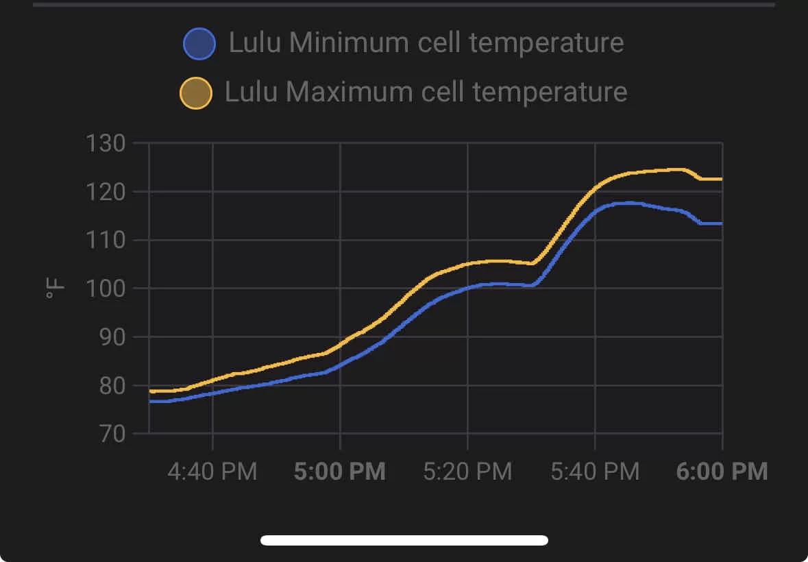

But here the thing, I preconditioned for about 40 minutes beforehand, and check out the battery temp graph:
It took about 40 minutes for my batteries to get from “driving temp” of about 80ish F to “charging temp” of about 100F.
So yes, you should precondition. It can only improve your charge.
