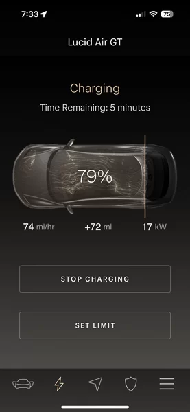

Tried my LCHC station for the first time in quite a while today. Realize that my free charging at EA is eventually going to end, so it makes sense to get familiar with the process now. Found the charging session started at 75+ MPH, but degraded over time to about 30 MPH. Never had this happen before. Tough to realize after three hours of charging (when I expected process to be nearly complete) that app was then showing 2+ hours remaining to reach full charge, and that charge rate was retarded to 29 MPH. Lucid charger is on 100 amp circuit, and used to be able to charge at 75-80 MPH. Is there a setting in either vehicle or LCHC device that I am not aware of that can cause it to ramp down?
