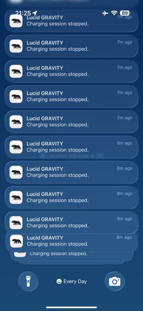

Prior to 3.4.1, my car stops charging once it hits the target and throws an error. This persisted through the 3.4.1 update. It will charge at a high AC rate (so I’ve no issue at 80A), then once it hits 80% (my set limit), it throws a “Vehicle Not Charging” error. Happens even when I use the Lucid wall adapter. Seems unique to me but Lucid is aware. Only annoying in winter as it then loses an absurd amount of range overnight with 25 degree temps. Which also seems to be a bug.
Example - Charges to 308 miles by midnight - throws the error, then is down to 297 miles by 7:00am.
Example - Charges to 308 miles by midnight - throws the error, then is down to 297 miles by 7:00am. See pic.
I have been getting that error before and after the latest update.
Same here. It hits 80% and then it stops charging, but attempts to charge again, over and over. I reported this back on 19-Dec-2025 along with the logs from the Lucid Connected Charger (LCHCS), in hopes this would be helpful to them.

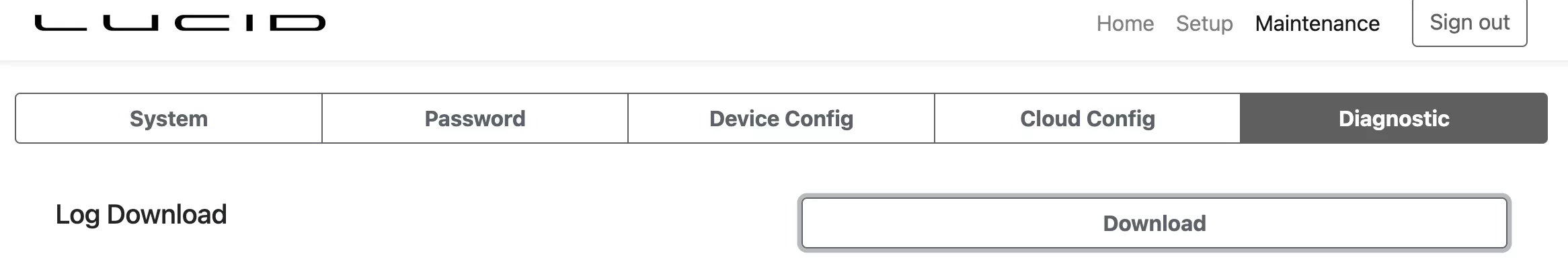

When you provided the LCHCS logs, you downloaded them using the charger interface after logging in?
See image below.
I click on the Download button, but nothing happens.
See image below.
They asked me for the diagnostic log as well. Nothing downloads, just like you. Not sure why. I told them this a couple of weeks ago, never heard back.

I found this thread that's related to the inability to download an LCHCS log.
However, no solution posted yet since the original post last October.
@borski the OP was looking for a response from you.
Do you have a solution on how to download a log?
See image below.
Yes I used the charger interface. I have that same problem. Maybe they updated the software on the LCHCS? Unfortunately, I am trying to access it remotely, because the LCHCS is at our vacation home. Although, I have the correct port forwarding, I still can't do a download. When I did the download last time in December, I was local to the charger.
