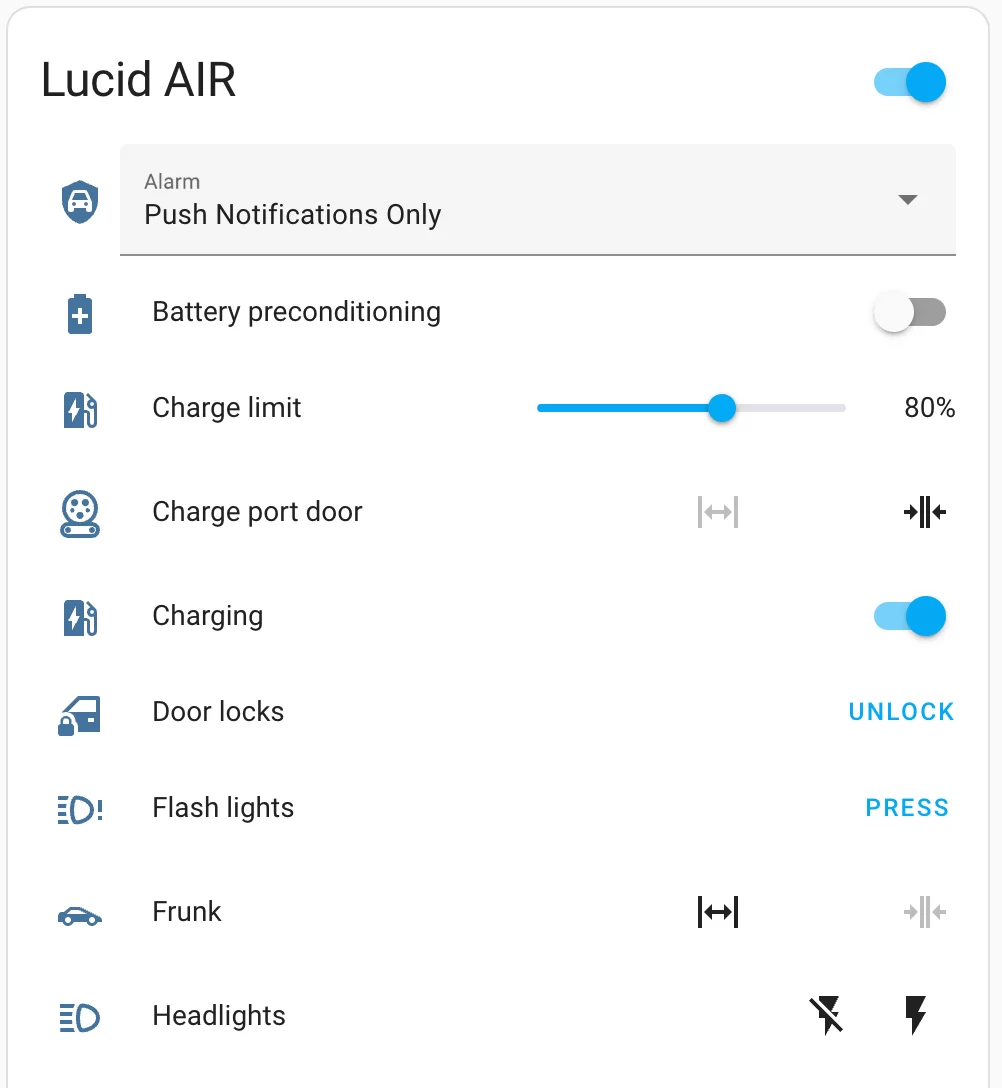

How do I get the other screens that are shown in your documentation on my Home Assistant screen. I only see this and climate control.
I’m traveling with family so tagging @segbrk in case he can assist or someone else can
Google “home assistant Lovelace” and you’ll want to build various cards on your Lovelace dashboard (which is just the normal HA dashboard)
@segbrk @borski Thank you gentlemen for your work and tips on Home Assistant and getting the Lucid app. I was able to do it! Not easy for a bloddy beginner, but I got it all done in about 1h. @borski, you now have a new user. Q: How do you track parameters over time (battery, usage, charging, temps etc)? I want to collect data and then make a graph on temp vs mile/kwh for example, or by tire size, or by avg speed, etc.
To graph parameters over time: Click on "History" in the navigation, and add the parameter you want to graph. For instance, my car is named "Lex Lucid", so I click on "+ Choose entity", type "Lex" in the search box, then select "Lex Lucid Remaining Battery Percent" from the drop down list. That shows me a graph of the SOC over the last 24 hours. If you click on the date at the upper left, you can change what time period is displayed. And you can choose additional parameters to have them all show at once.
Thank you @maractwin @borski for the tips. That worked. Endless possibilities....here my first (non-sense) draft....Is there a way to share dashboard design with each other directly?

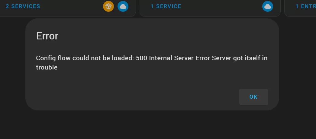

Anyone know how to fix Config flow could not be loaded: 500 Internal Server Error Server got itself in trouble when trying to set up the Lucid Motors Home Assistant integration?
Huh, go to Settings > System > Logs and see if it says anything relevant there?
