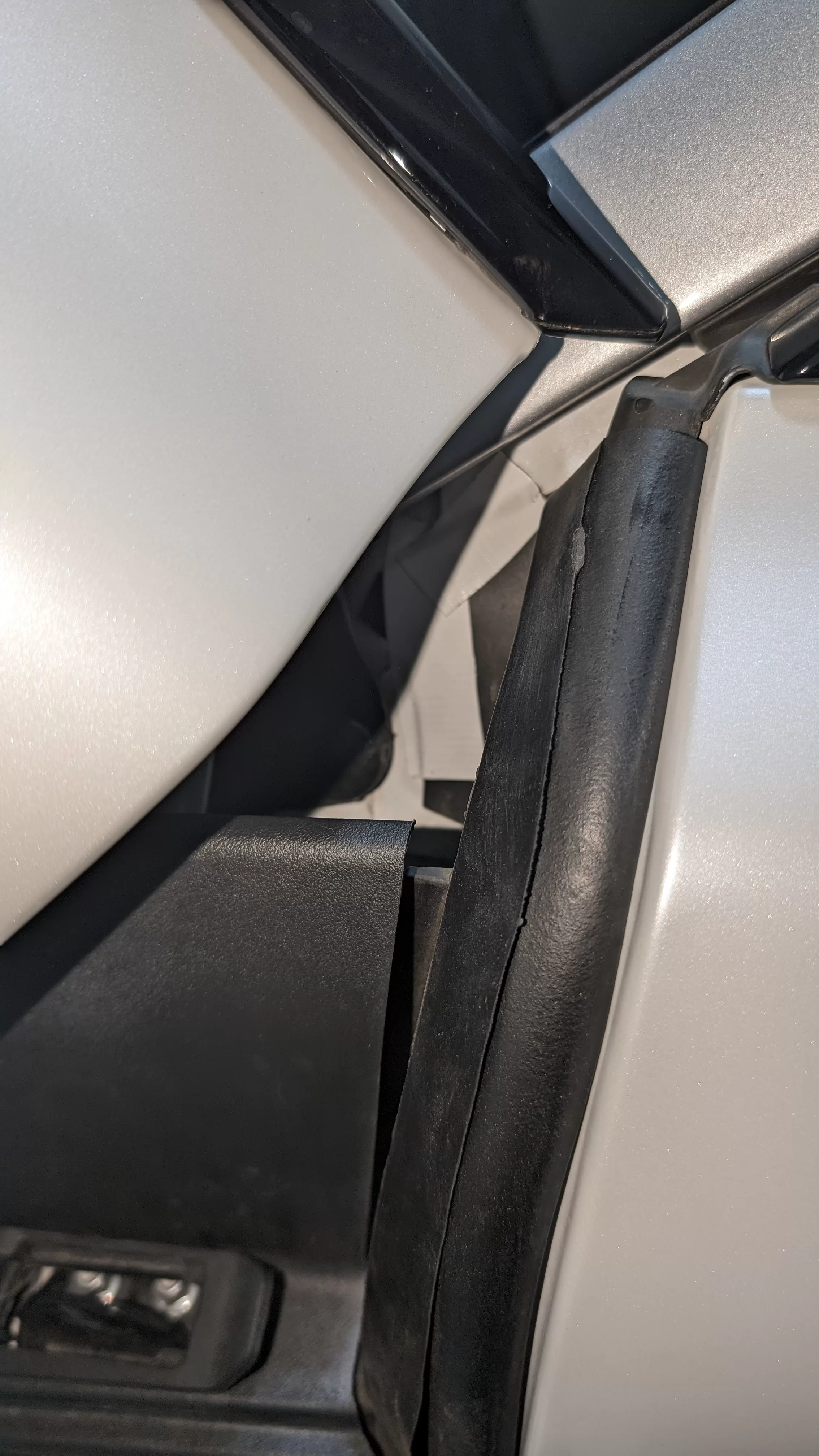

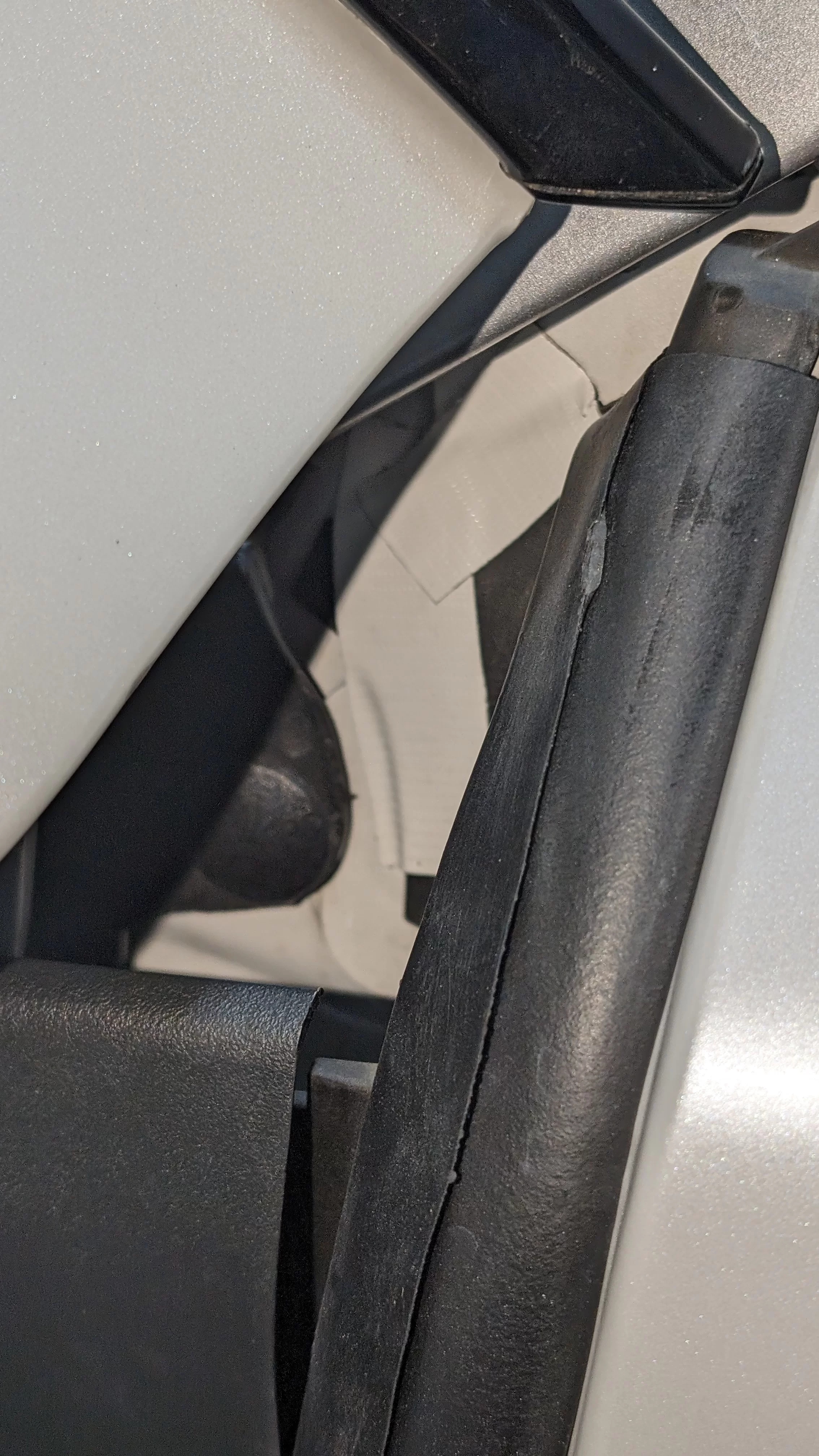

So this is the solution that fixed that annoying buzzing/humming noise for me, is near the hood and above the charge port there's a rubber seal that is visible when the hood is open, the edge of that area towards the front of the car doesn't have any adhesive and moves around when wind passes through. So I just got some foam tape from amazon and taped the edge of that area securely to the car, and after doing that the annoying sound disappeared, had this setup for 2+ months now and going strong.
Tape I used from amazon: https://www.amazon.com/dp/B082F37WJH

the flap is located around that area in the red circle

Thanks! I've always been suspicious of that piece. It seems so much flappier than I'd expect. The one on the passenger side in my car is less movable. I'll give this a shot in the morning, I have some similar tape already.

Update - so I did NOT experience any positive change in my wind noise issue after this. The mystery continues...
Looking at the pictures again maybe the tape should go on the part circled on the picture by JKM … it’s looks like a different area in the same approximate location

The tape has mostly fixed my issue. I need to do a slightly better job with it, but I’m 90% there. Silence is so nice. I didn’t realize how much that noise was nagging at me until it was gone.
I just applied tape on both areas left and right of the hood hinges. I will report back tomorrow after my highway drive to work
