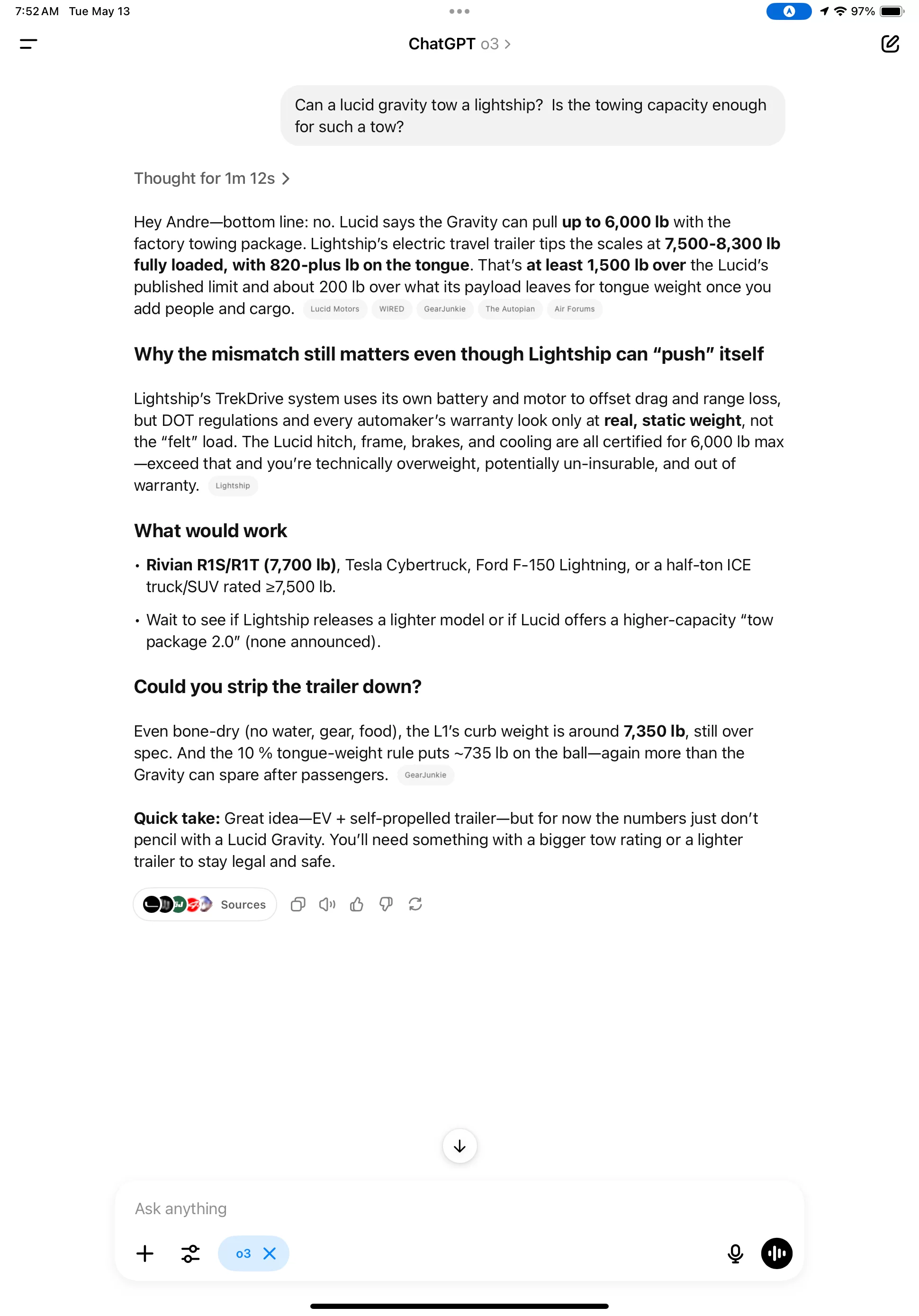

No, the Lightship is too much for the Gravity to tow. The Lightship website lists the dry weight at 7450 lbs, and gross weight as 8300 lbs. That means even a completely empty trailer exceeds the Gravity's rated towing capacity by 1450 lbs, and by more than a ton once you've loaded it up. While there's always a little safety margin in the towing figures, I'd consider it incredibly reckless and dangerous to overload a vehicle's towing capacity by such a large amount.
The Lightship team seems to be explicitly targeting EV pickup trucks as tow vehicles, and is making little effort to target EV SUVs. The SUVs pose a real challenge for powered trailers like this, because adding the weight of a drive train and batteries to a trailer to get a long range boost is fundamentally also adding a lot of mass, and thus making it hard for smaller EVs to cope with the forces that towing puts onto the tow vehicle.

They are optimized for generating "words that go together well" but don't have symbolic reasoning to back that up. (There's tons of ongoing research around things like Retrieval-Augmented Generation and other techniques to improve this.) The underlying data is no worse than if you do a web search, but the result is presented so confidently that people just assume the answer is correct.
The above is a great example. You (and the language model) are both capable of finding the tow capacity of the Gravity and the GVWR of the Lightship. You're able to determine that 6000 is less than 7500. The language model doesn't have the concept of those things as "numbers" that have a mathematical relationship, and reaches the wrong conclusion (confidently). This is made worse by the fact that they're prompted to sound "agreeable".
