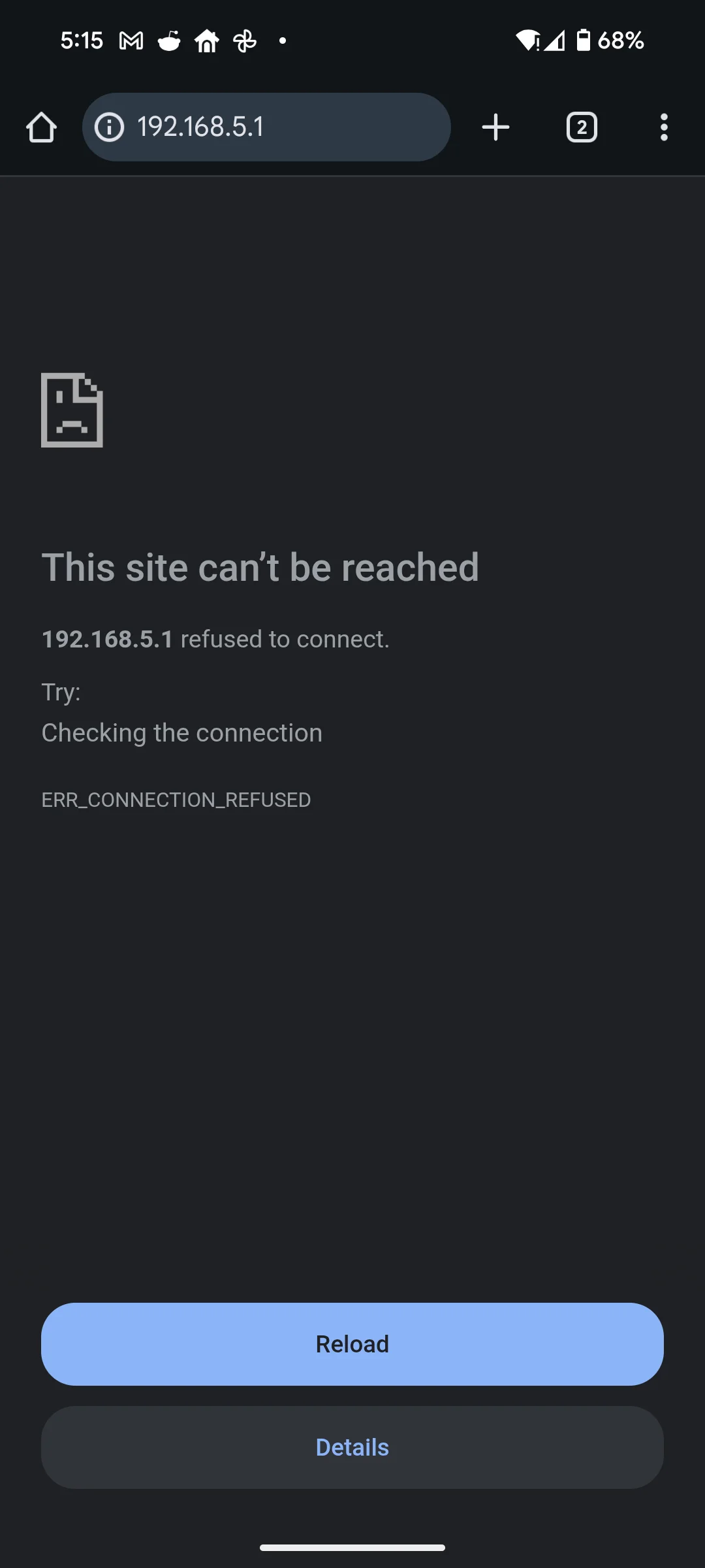

Following the instructions, I've connected my laptop to the stations SSID (which is the station serial number). So, my laptop is connected to the station -- I can clearly see it is connected, the signalstrength is strong,but there is no internet access. No internet access is expected because the station has no internet access.
THe next step,per the instructions,is to use a browser (I'm using a Chromebook, so Chrome is my only option) and go to the IP address 192.168.5.1 The browser is giving an error message that says connection refused. I tried various different Proxy Server settings, and that didn't help (although I did get different error message is from the browser).
Any help out there? Thanks.
I'm going to try with a PC and a Macbook while I await the hive's response.
Same result with other browsers. I even tried my phone's wifi and browser. On hold with customer care now. Screensnap is is from the phone.

Is your home wifi subnet 192.168.1.x ? If so, it is breaking the LCHCS's tcp-ip stack.
The LCHCS does not work on 192.168.1.x. You won't be able to connect to 192.168.5.1 when connected to its SSID, if your home wifi is 192.168.1.x. I know it sounds crazy. A firmware bug (a conflicting hardcoded IP address) in the LCHCS that has gone unaddressed for 2+ years.
And once you do get it connected to your home network at 192.168.1.x, your router will show it as on the network, but it won't communicate.
My LCHCS is on my guest network at 192.168.2.x for this reason.
It's surprising that Lucid has not fixed this yet @marqie. In my experience, 192.168.1.x is the most-common default home router subnet.
@geosynch you are the second person to post about this problem, this week.
Turn off your home wifi, leave it off, power cycle the LCHCS, and try to connect to 192.168.5.1 again.
I realize that the two wifi networks should have no problem coexisting, but the LCHCS has a bug.

Wow. 192.168.1.x is the most common home IP address.
But my home is set up for 10.0.0.x
I'll try the suggestion of turning off the home Wi-Fi and trying again. But not tonight. Got other stuff to do.
Does anyone think this is the reason I can't charge at >12 amps?
Customer Care didn't think the two problems were related.
