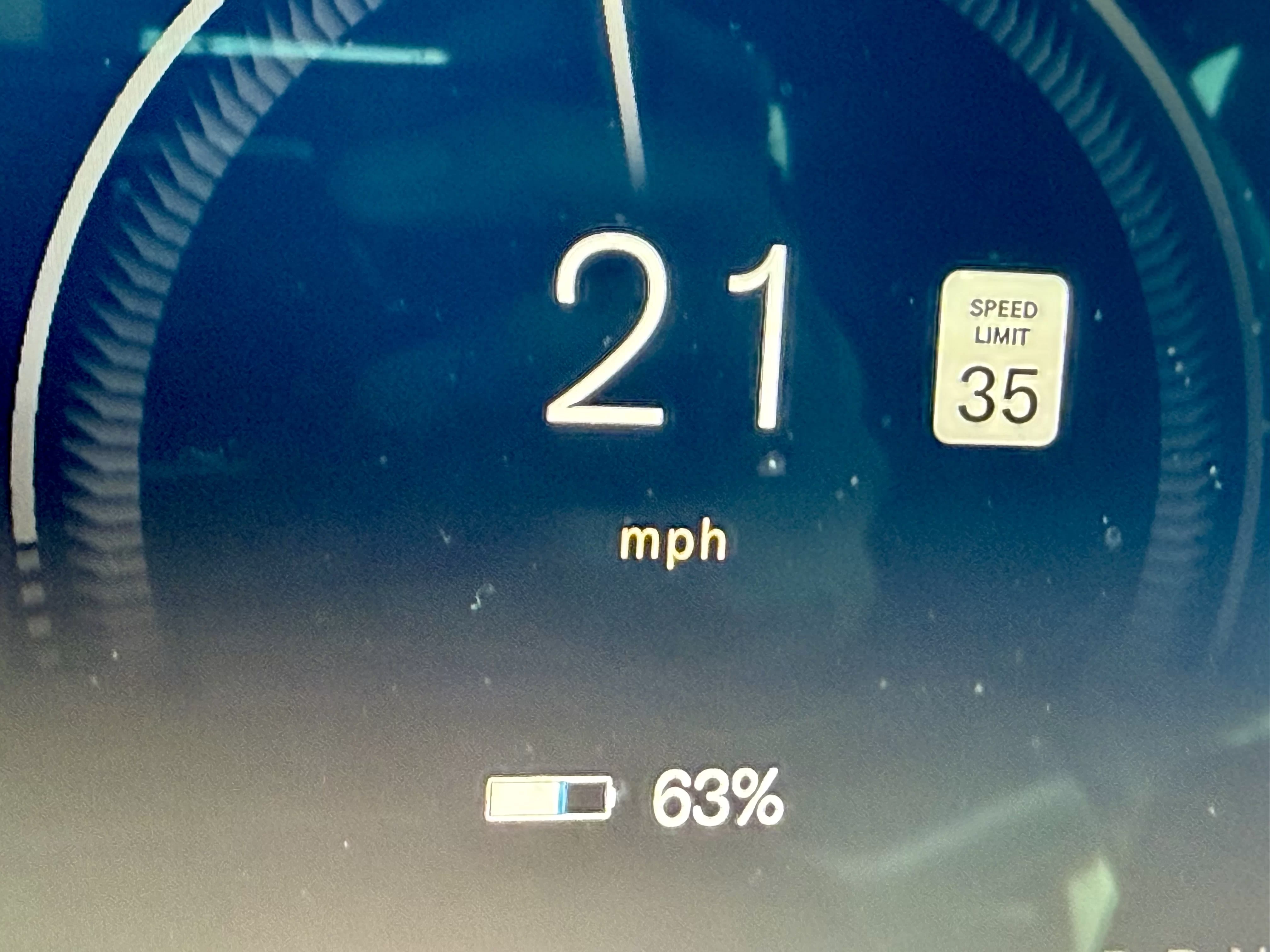

Nephron Member Verified Owner Joined Oct 14, 2023 Messages 27 Reaction score 51 Cars Lucid AGT, 718 GTS 4 Jan 22, 2025 #1 Just noticed blue line in battery indicator . Any thoughts ? Just curious . Screen defect or cold temp ?!
J JGard18 Active Member Verified Owner Joined Sep 6, 2024 Messages 116 Reaction score 71 Location Boston MA Cars 24 Lucid Air Touring Referral Code BIN679WM Jan 22, 2025 #2 Cold temp, reduced energy available. It'll show in the app, too
Halodde Active Member Verified Owner Joined Aug 12, 2022 Messages 1,265 Reaction score 1,052 Location Buffalo, NY Cars Lucid Air Touring Referral Code BJ2URGEK Jan 22, 2025 #3 Look at the charge screen in the pilot panel. It will tell you
Electrified Active Member Verified Owner Supporting Member Joined Jan 22, 2022 Messages 689 Reaction score 568 Location Chicago Cars AGT, F Type SVR, F-Pace Referral Code 04MXQNS5 Jan 22, 2025 #4 Nephron said: View attachment 26164 Just noticed blue line in battery indicator . Any thoughts ? Just curious . Screen defect or cold temp ?! Click to expand... It's just letting you know the battery is cold and there is reduced power, if you want full power you can precondition the battery while parked or driving, the precondition will use about 3% of the battery to warm up.
