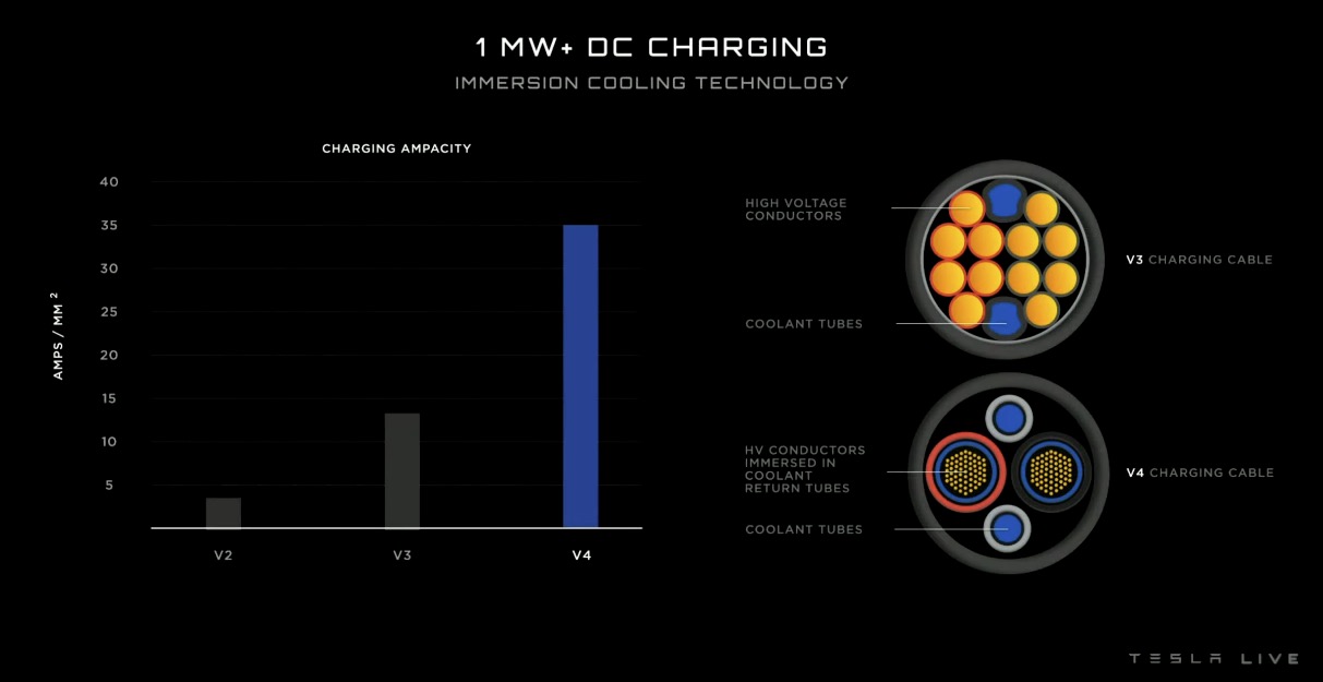

The longer cable has to be retrofitted/built into the stall, and it is not an extension cord because if you see the cable cross-section above, it has coolant running through it.

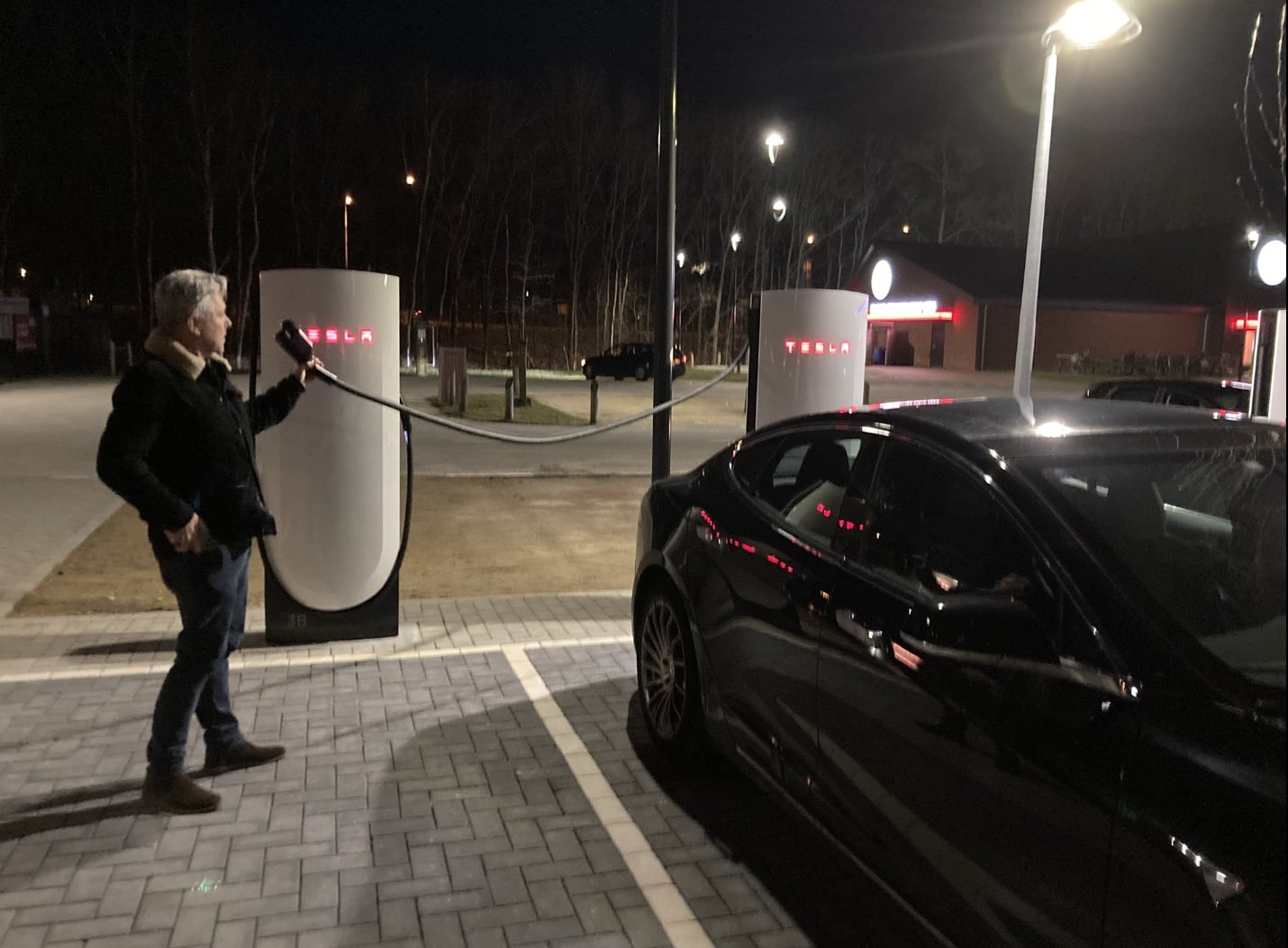

Longer cables have been started in Europe, reaching a generic car's left or right side.

Those are the new V4 dispensers with longer cables. They're currently being operated at 450V max using v3 power conversion cabinets....Longer cables have been started in Europe, reaching a generic car's left or right side.
