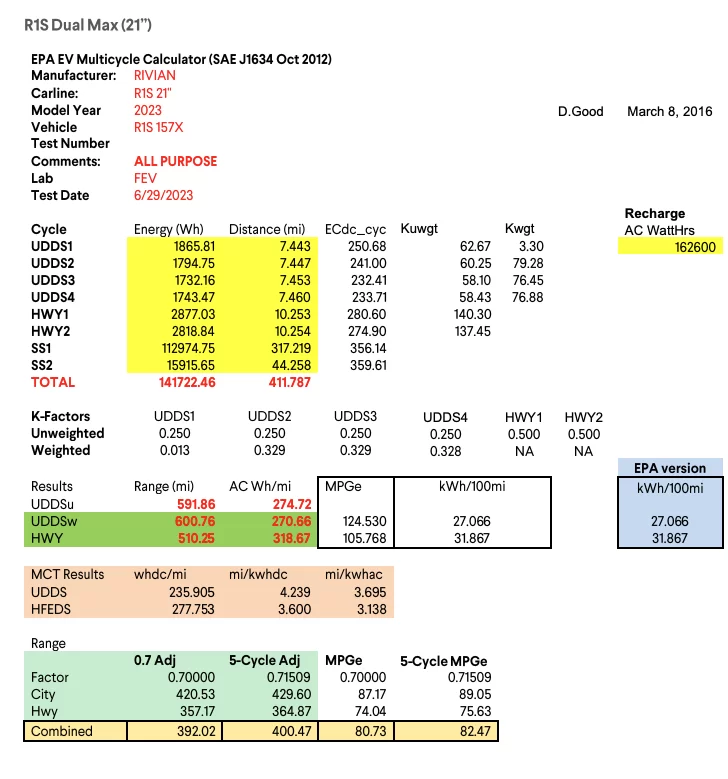

I don’t know about the German automakers (but it’s always common for them to underrate everything, range, performance, etc) , but Rivian uses the 5 cycle test, so how do they manage to have epa figures in line with real world driving?The conclusion is something that has been discussed on this forum many times:
The 5 cycle tests overestimates real world range. It's a marketing gimmick to advertise the highest possible range. The 3 cycle test has a fudge factor that is decided on by the manufacturer. Some use a smaller fudge factor to underestimate their real range (ie Porsche) and others use a more realistic fudge factor to give a range that is more in line with reality.
Unfortunately, there isn't one standard test by the EPA for unclear reasons. It would certainly level the playing field. That being said, Tom Moloughney, did get pretty damn close to EPA range on his DE 70 mph test. And as others have shown, if you drive closer to 65 mph, your range will be in line with the EPA estimate.
