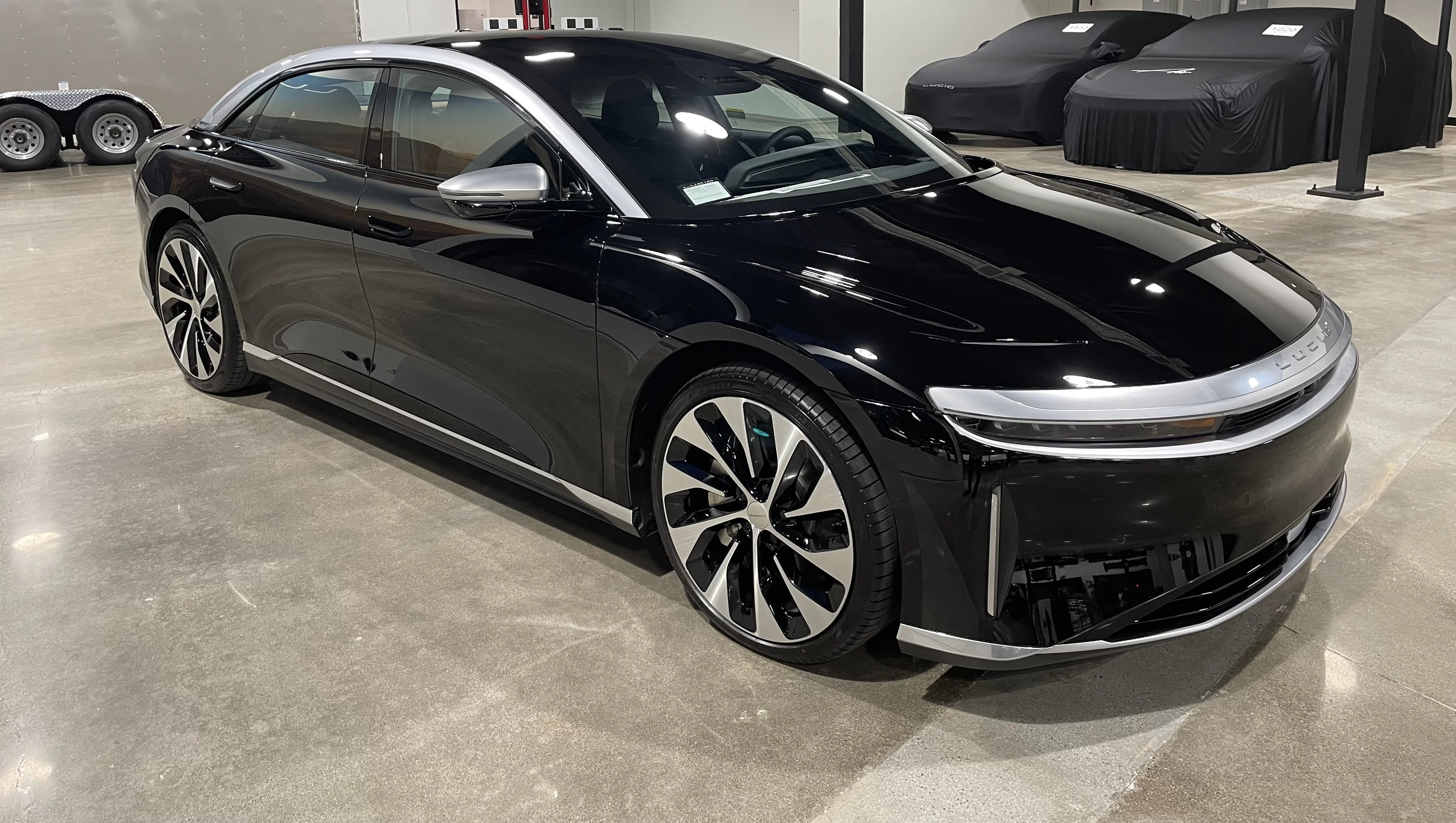

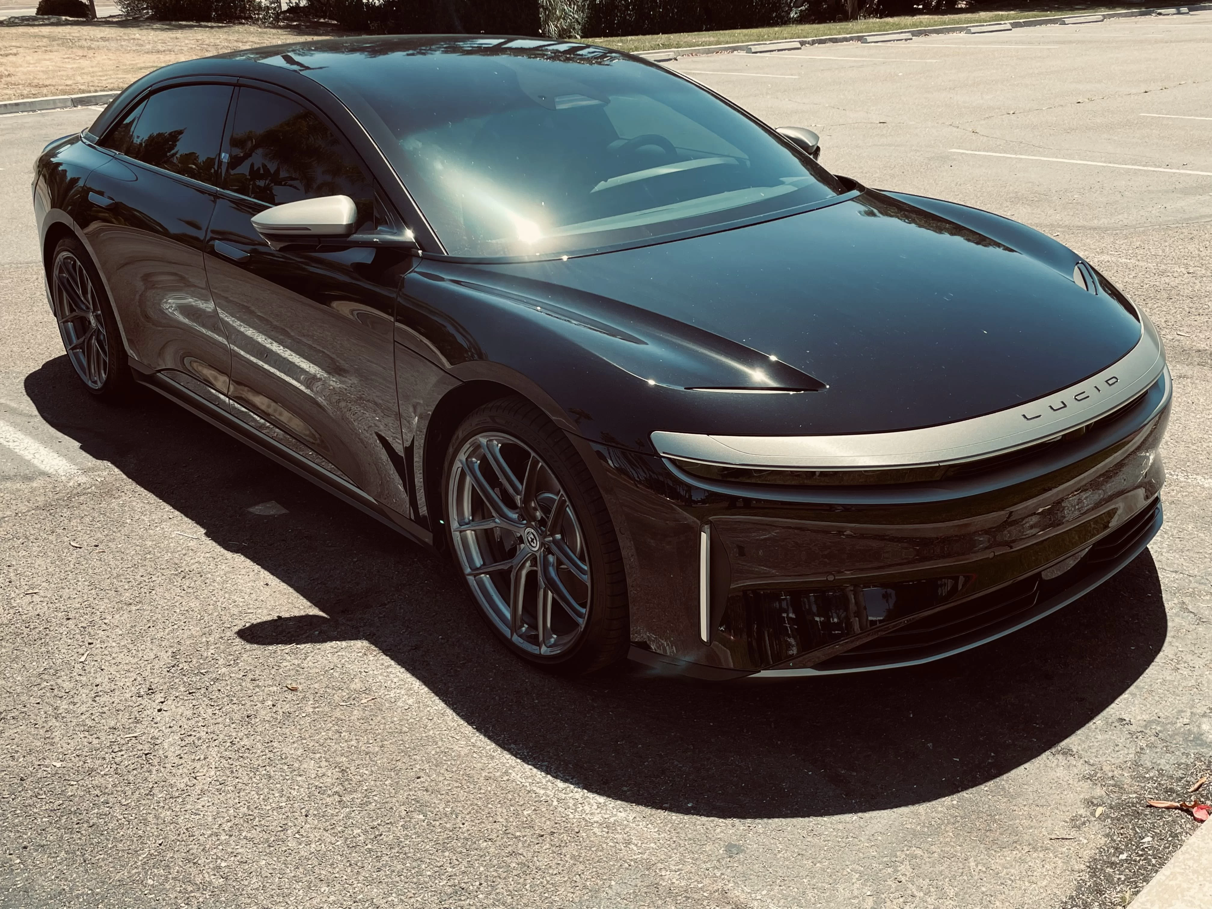

I replaced the OEM aeroblade 21's on my AGT with the HRE p101sc's and kept the original pirelli tires. I personally prefer the look of the HRE's. But aesthetics is a very personal choice, so to each their own. I weighed both the OEM and HRE wheels without tires:
OEM: 37.2 lbs front, 38.2 lbs rear for a total of 150.8 lbs
HRE: 22 lbs front, 23.4 lbs rear for a total of 90.8 lbs
The difference therefore ended up being 60 pounds of unsprung mass. I felt a major difference right away in terms of steering and ride comfort. The car felt much more agile and absorbed bumps in the road noticeably better. Overall, I was actually quite surprised at how much "better" things felt with the new wheels. That being said, I'm not a performance car driver or have extensive track experience etc like some of our esteemed members so might not be noticing some of the finer details or differences. I'm just an average joe who drives his car to and from work and takes it on the occasional road tip.
I was most curious about what the impact of the HRE wheels would be on range. Although they are significantly lighter, they are not aero designed. So far, my results suggest minimal if any impact on range. The first 1750 miles I drove with the GT, I averaged 2.9 mi/kWh. The next 1350 miles, my average rose to 3.2 mi/kWh which I attributed to passing through this mysterious "break in period". Since the wheel replacement, I've driven an additional 2100 miles and my average has stayed the same at 3.2 mi/kWh. I was prepared to take a range hit with the new wheels, but am actually quite pleased to find that hasn't been the case.
Photos are comparison from 100% stock picture I took at the service center on the day I picked it up (in studio lighting) versus after exterior mods including new wheels (in afternoon sunlight). I honestly love the stock unmodified look too, but ultimately prefer the modified aesthetic.

I wonder if the range effect of lack of aero covers on the HREs are offset by the reduction in weight. I’d think not since aero has way more to do with range than weight does. That’s great it makes such a difference in the feel of handling though, which was already excellent. I don’t know what I’m gonna do with my 19s once they’re ready to be replaced. I think the Pirelli have too much road noise on certain types of surfaces, it’s an irritating resonant tone that almost sounds like a musical note, but then my mobile service guy said someone who had swapped for Michelins said they were noisier than the Pirellis (on asphalt the Pirelli are damn quiet, but on other roads I don’t like them).

They look good!

Yeah I was wondering about that too but all the reading I've done suggests, like you said, that aero effects are much more important than just weight. So I was a bit surprised that I didn't seem to take any range hit, but will continue to monitor the situation long term. I'm leaning towards replacing the Pirelli's next but I wanted to wait until the Michelin EV's come in 21 cuz I think that's the one version of Michelin tire that also has the foam noise reduction system? I could be wrong.
