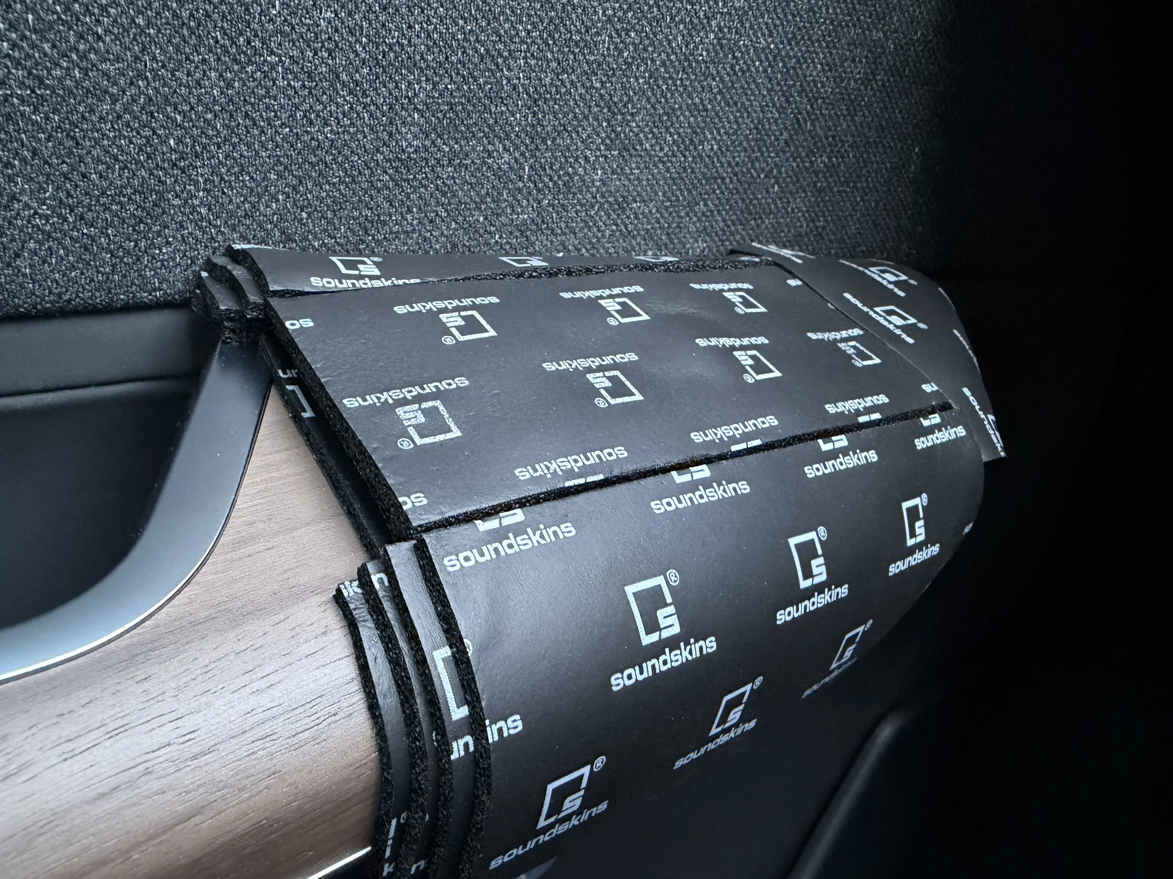

Tweezers, a tiny screw driver to poke, and patience. It is a bit tricky to get it in there nicely because there is no space to work.
Right now at night when the headlights are on cup your hand and cover your window switches. The majority of the electrical sound is coming from there. The tape is meant to seal the tiny gap between the switch and the housing.
I don't notice the tape with typical switch use. I did this to all switches and had probably a 70% reduction. Without this it was highly grating to my ears. It does make a difference but it's not perfect.

That’s simpler than I expected, thank you. I ordered a door trim removal kit thinking I had to get in there. Maybe I’ll try that anyway and give it a shot.

Be careful if you do remove the door trim. I was told by a service tech that at least on the Air it's easy to break the clips.
