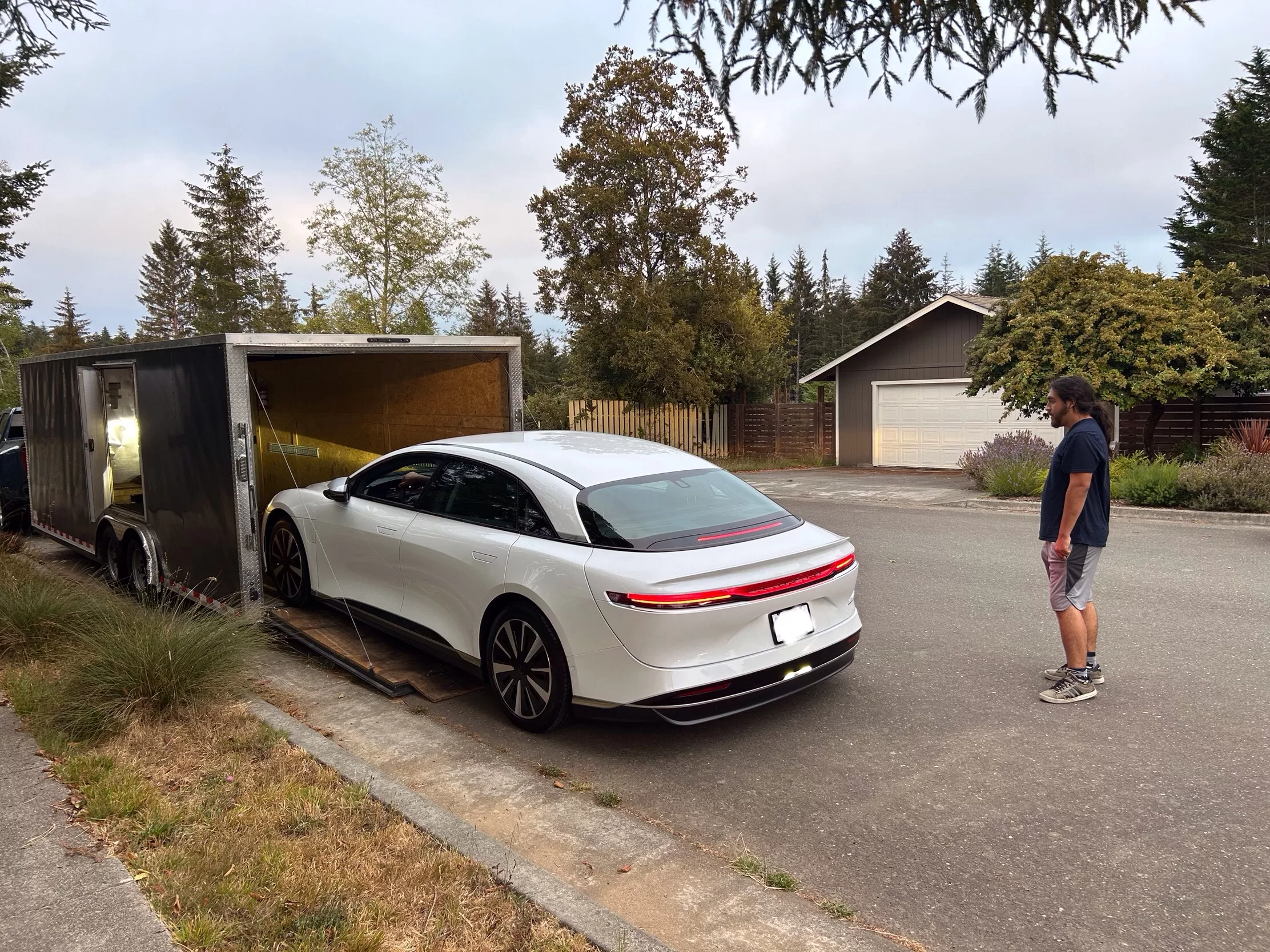

Our Stellar White Air Grand Touring was delivered to our home in McKinkeyville at 8:00pm on July 31, 2025 via enclosed trailer. McKinleyville is about 300 miles north of Milbrae, CA. I ordered our White AGT with Aluminum roof, 19” wheels, Mojave PurLuxe Leather Alternative, 20-way seats and DreamDrive Pro on May 16, 2025. First day of “In Production” was July 16. First day of “Preparing for Delivery” was July 24. The Air replaces a 2015 Chevy Volt that we are in the process of selling. My wife and I also own a 2000 MBZ SL500, 2010 Smart Fortwo, and a 2017 Volvo XC90. Some might say we have too many cars.
