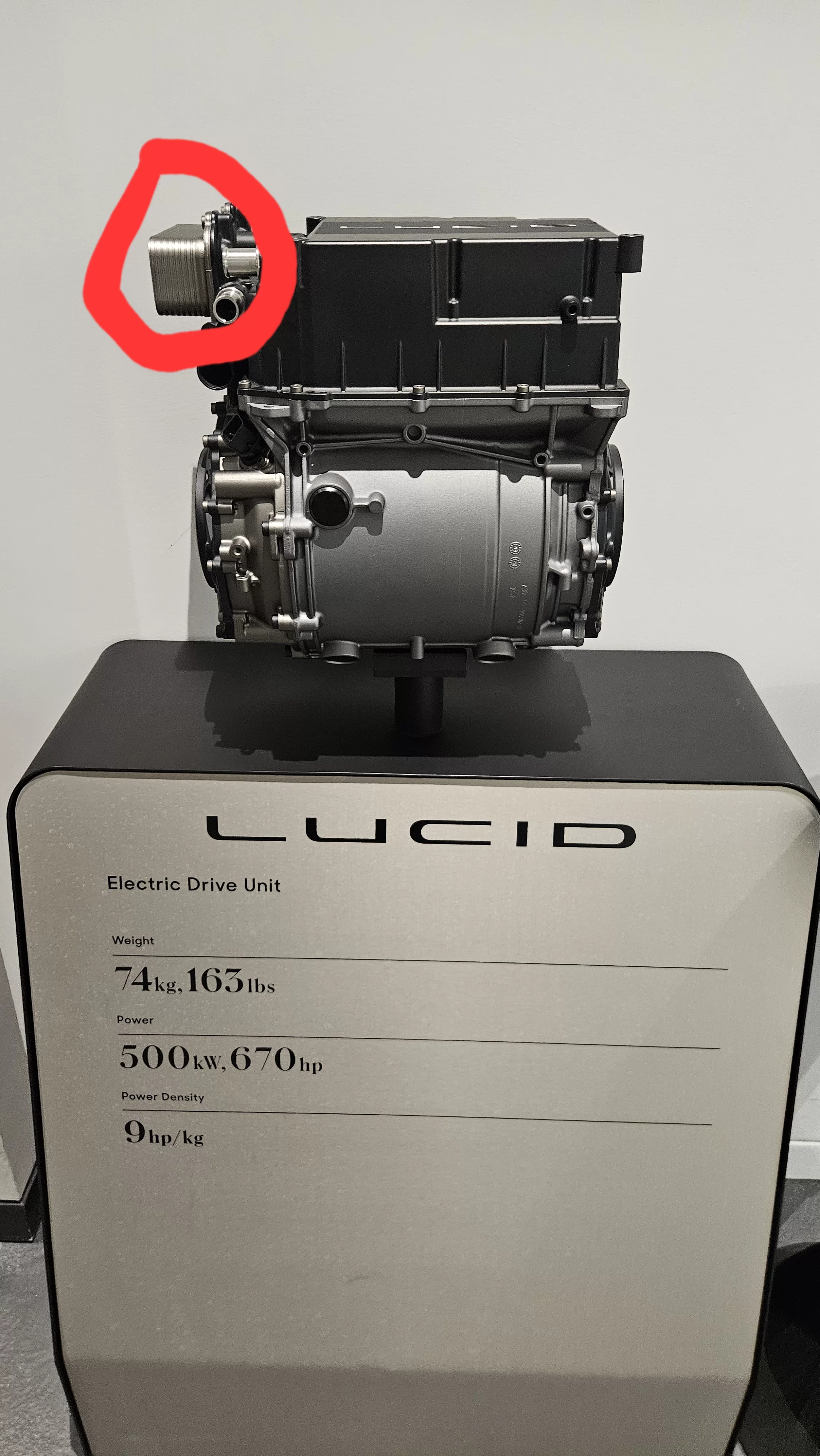

Has anybody seen any detailed information about the Lucid Heat Pump Technology? I assumed there was a small compressor somewhere that worked like the heat pump in a house but on a smaller scale. When I inquired at the studio I was told that the heat pump is this tiny element attached to the propulsion unit (circled in red in picture). I question how a unit that small can produce any kind of meaningful effect, but I also can't doubt Lucid given what they have done to improve power to weight in their motor. Does anybody know how well this heat pump works, or have any more info about its tech?
Has anybody seen any detailed information about the Lucid Heat Pump Technology? I assumed there was a small compressor somewhere that worked like the heat pump in a house but on a smaller scale. When I inquired at the studio I was told that the heat pump is this tiny element attached to the propulsion unit (circled in red in picture). I question how a unit that small can produce any kind of meaningful effect, but I also can't doubt Lucid given what they have done to improve power to weight in their motor. Does anybody know how well this heat pump works, or have any more info about its tech?View attachment 25640
That is NOT the heat pump that heats / cools the car. That is purely the pump that circulates coolant through the inverter IIRC from Eric Bach’s Tech Talk in Inverters…
Thank you, that makes a lot more sense
