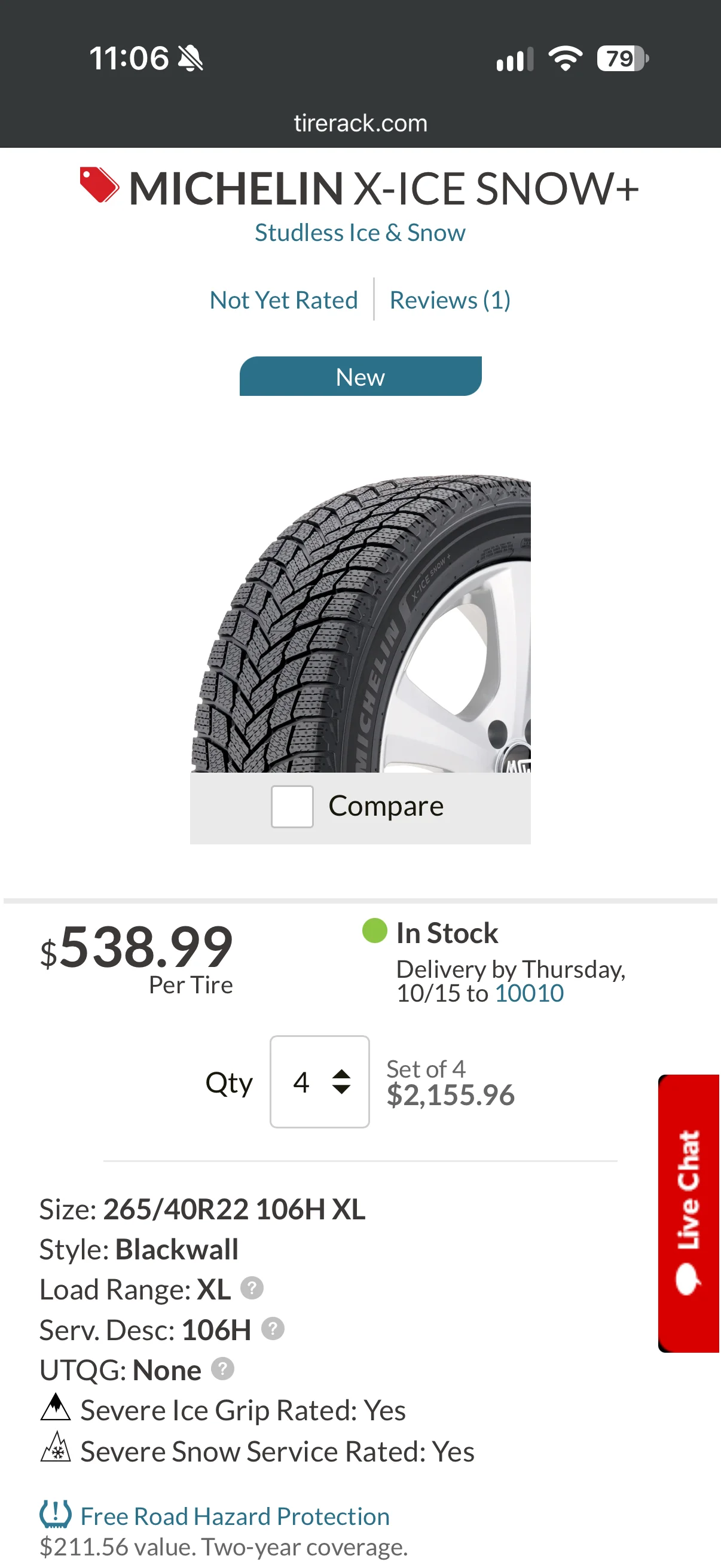

Get a set of 22” wheels and put Michelin X-Ice snow SUV on them, there are no ice rated tires in 22” size so you are stuck buying the Lucid small wheel.

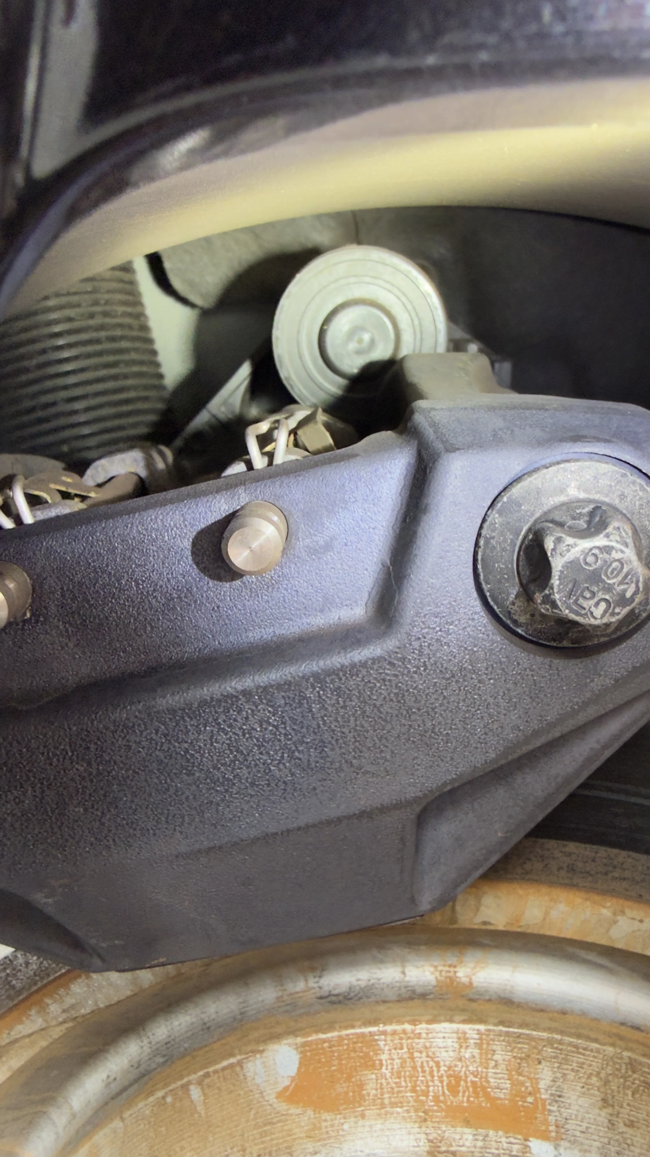

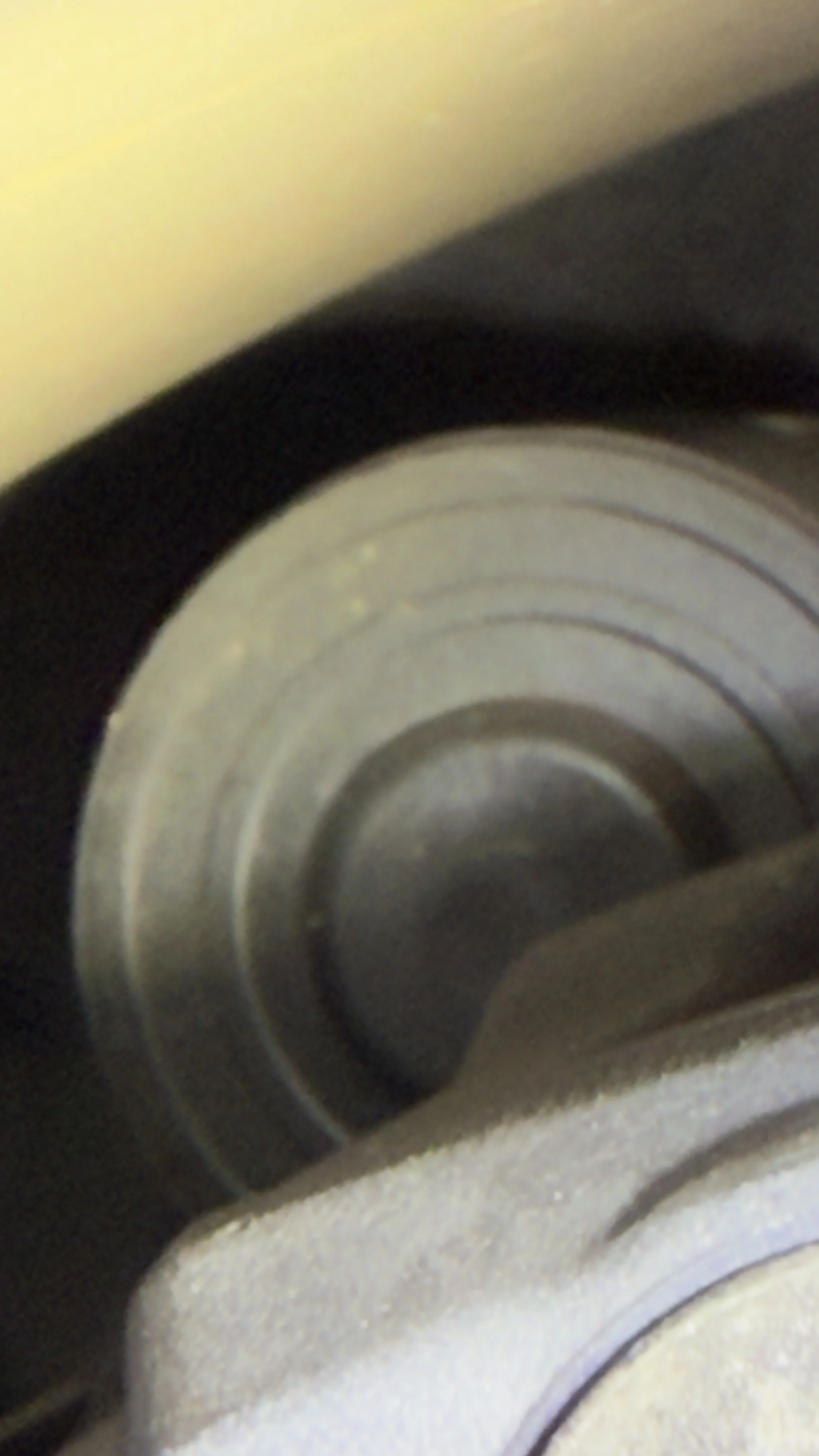

Lucid rear 21” wheel has a step barrel with extra height for the parking brake. Other 21” rear wheels will not clear the barrel.
Go with Lucid 20/21” or go with 22”.

Unless 50+% of your driving is on true ice, I just want to re-emphasize that a good set of studless tires is likely better for your use case. Studless winter tires will perform better in snow, slush, and dry conditions, and they also have respectable ice performance, unlike studdless winter tires of the past. I haven't skied Stowe, but I've spent a lot of time skiing Killington, Sugarbush, and Stratton, staying at places 1+ hours away from the mountain with far less frequent plowing, and I can unequivocally say in all those instances studless tires were better suited than studded.

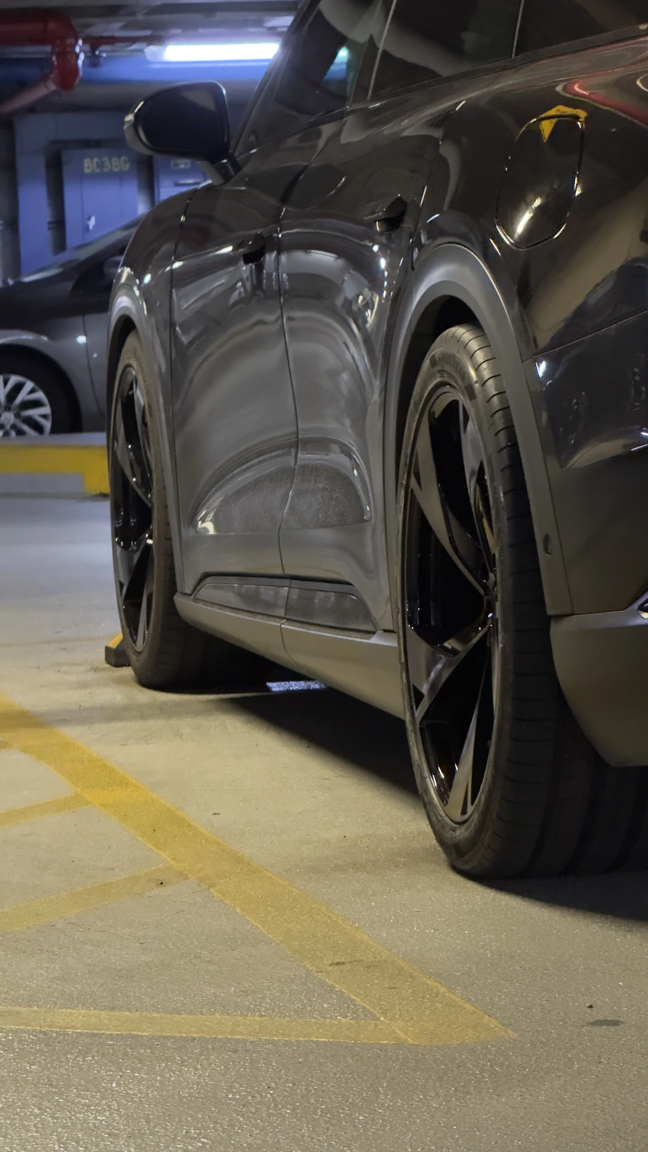

First I ran 22” with all seasons, sold this to another member and went 22” summer. Should have my winter setup in the next two weeks.
Otherwise…no one else can do it. And that one person in Ohio…but that’s it!

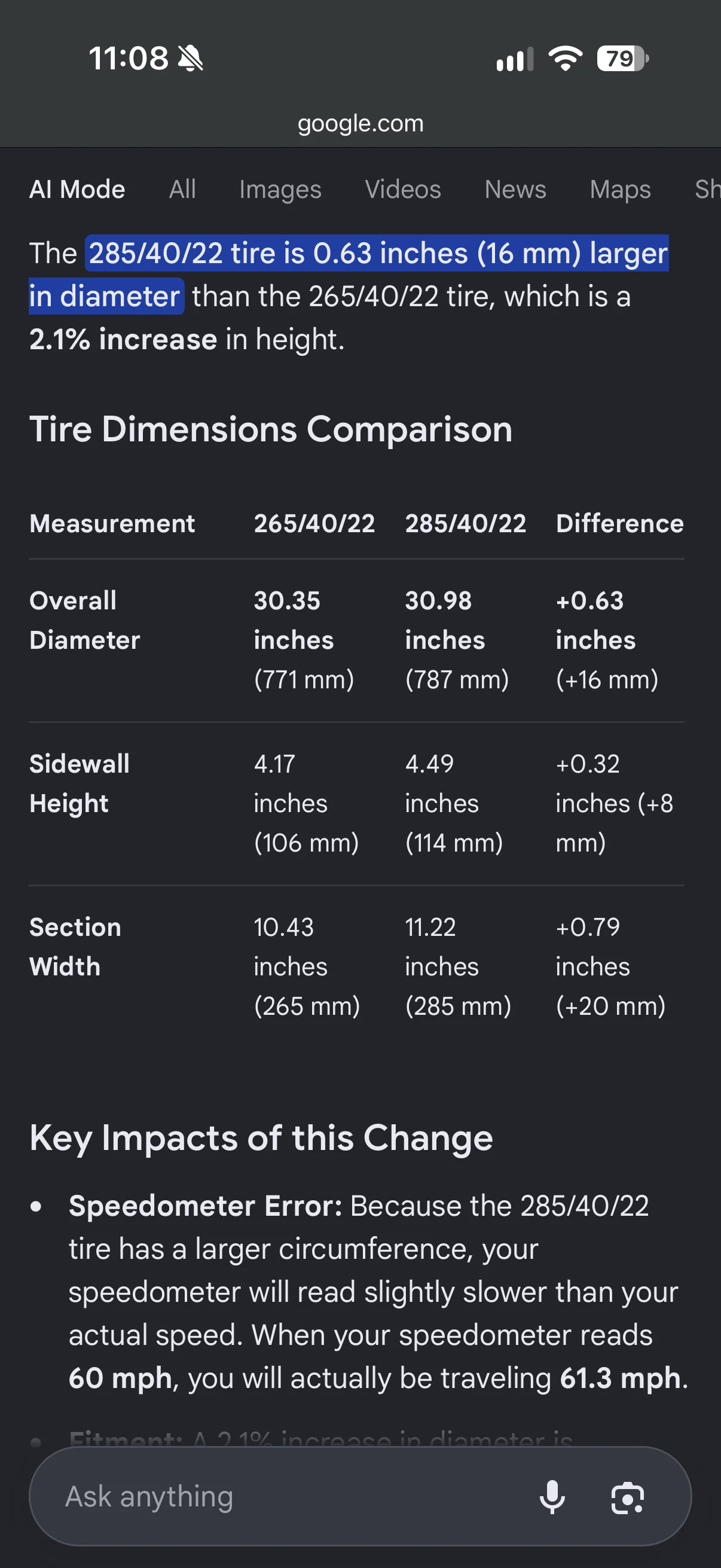

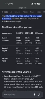

  2. Car settings: Will the car let you select 265/40R22 front and 285/40R22 rear together, and does everything behave (TPMS, traction control, range estimate)?

2. Car has no idea what wheels are used, will show you rated range based on stock. As long as diameter is stock, you are fine

4. Model X wheels will not have the load rating you want, Land Rover wheels have a forged option that may fit with a 5mm front spacer, I tried to go that route and it was painful. Have to be careful with weight.

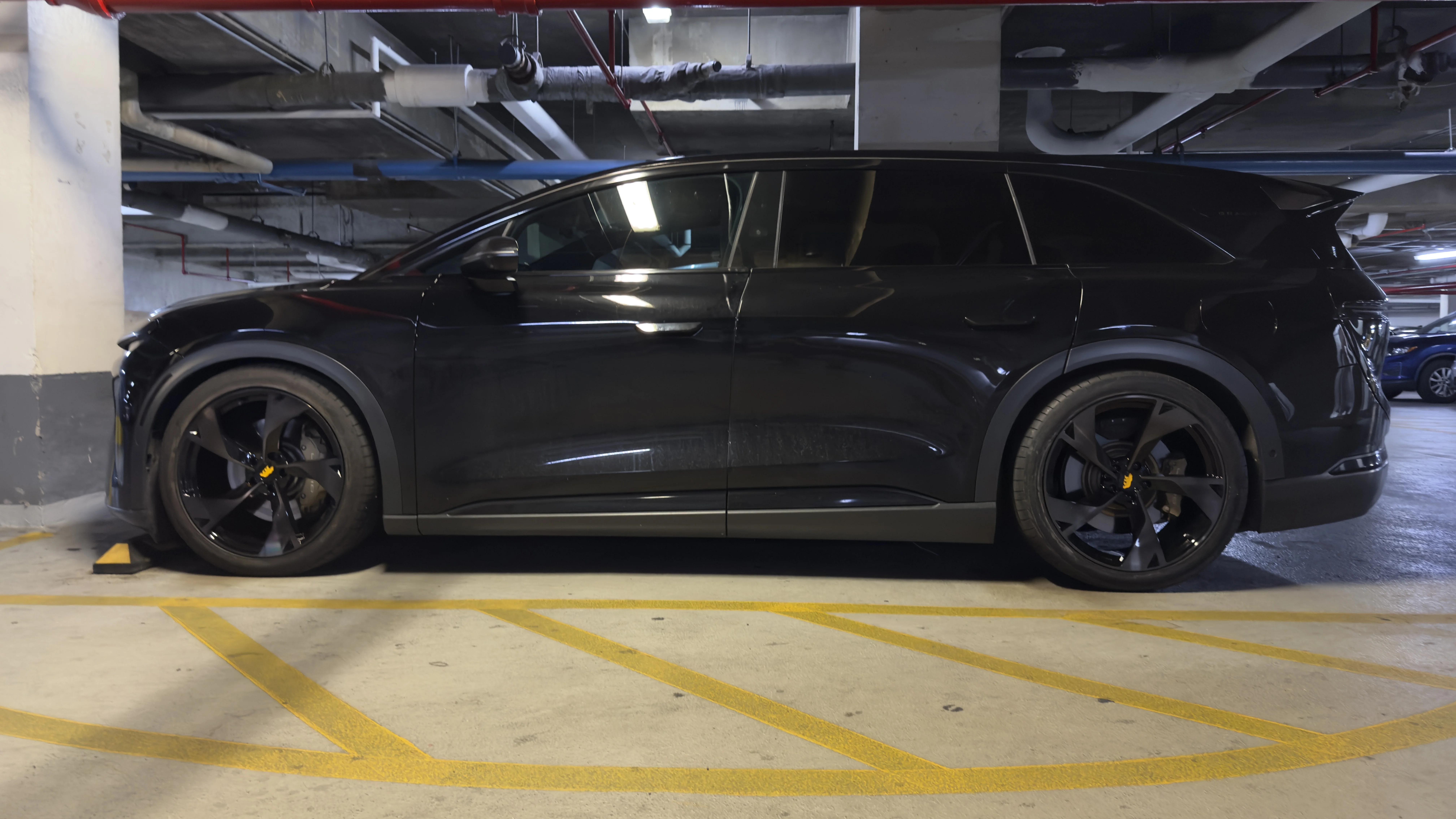

Technically…I do have a replica forged large wheel in a square 22” size with 275/315 summer tire.
They make quite a splash in the rain
In theory…these are ice rated and you can run them square, the rear is going to be wrong size but within acceptable margins, and won’t rub.
