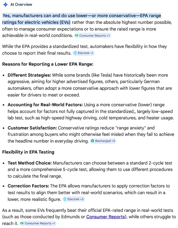

There's that too (choosing the 2-cycle or 5-cycle test), but they can go beyond that and apply "correction factors" if they choose. I remember Ford doing that with the Mach-E. I can't find the articles from 6 years ago now, but Google AI summarizes it...
The correct term is “adjustment factor” and does not mean precisely what you think; the EPA adjustment factor is a regulatory multiplier, typically 0.7 (or a 30% reduction), applied to EV laboratory range tests to better simulate real-world driving conditions. This factor reduces raw, 2-cycle lab results to account for factors like high-speed driving, cold temperatures, and heavy HVAC use. Note that this only applies to the 2-cycle tests, and is done because those are extremely unrealistic; they equate roughly to a 0-60 time of 18 seconds, which is not how anybody drives.
Most OEMs use a default factor of 0.7 applied to raw city and highway test results to calculate the final range on the window sticker.
Instead of doing that, manufacturers can run 5-cycle tests (including aggressive driving and cold/AC tests) to potentially earn a more favorable adjustment factor than 0.7, although the adjustment can never be less than 0.7.
This dual-method testing dates back to the EPA's 2008 overhaul of fuel-economy labels. Initially, the agency wanted all vehicles to undergo five-cycle testing, but automakers claimed it was an overwhelming burden and the EPA relented.

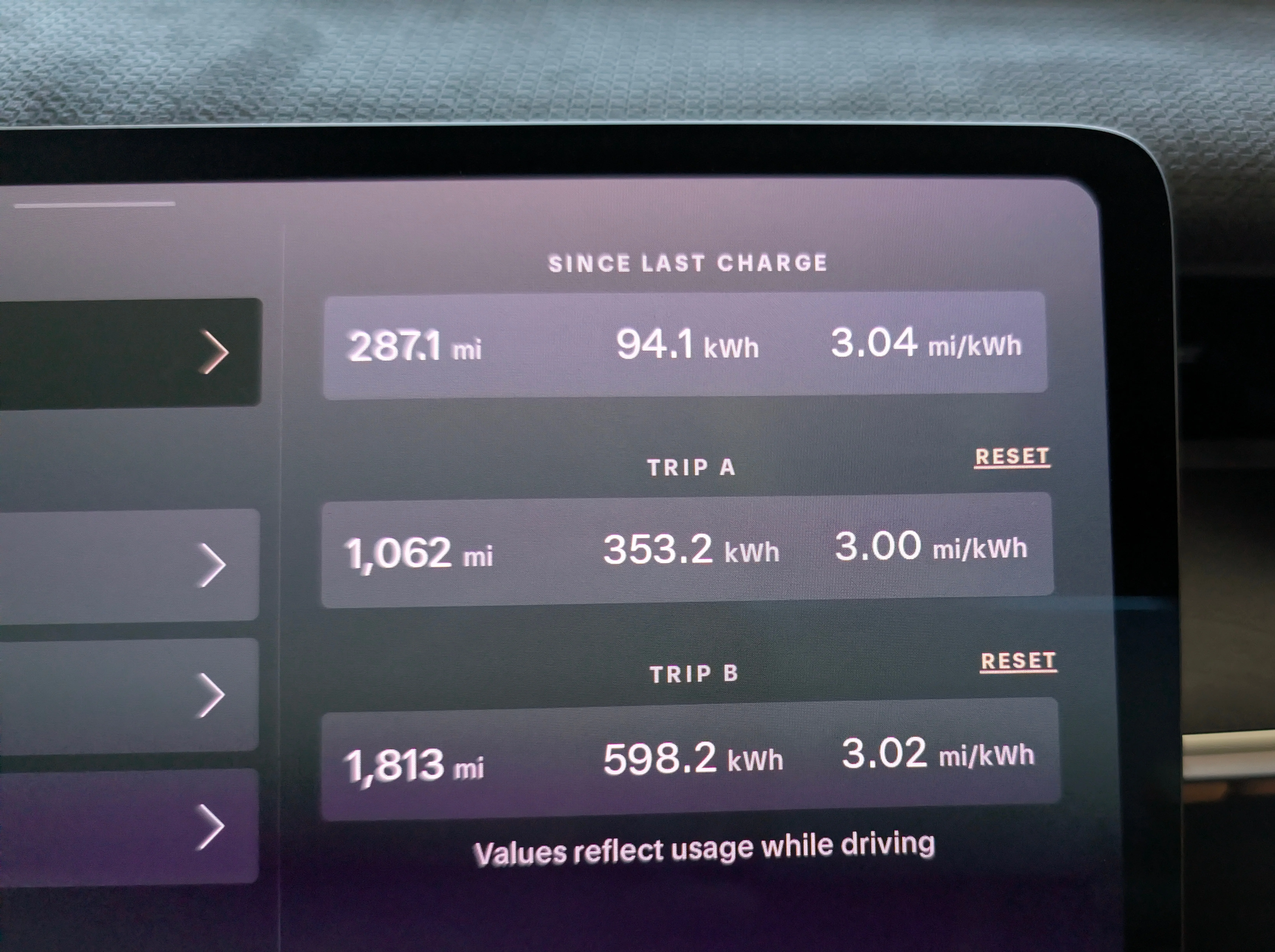

Miles 1000-2000 on our Gravity, trip A, mostly 65-80mph. Solidly 3.0mi/kWh, great for a large SUV. A wonderful road-trip vehicle.
Nice
What size tires?
The 20-21 wheel combo. I was happy to have the longer range, and a healthy sidewall for pulling off-road into rough dirt trail parking areas. The air suspension's adjustable height was handy too.
