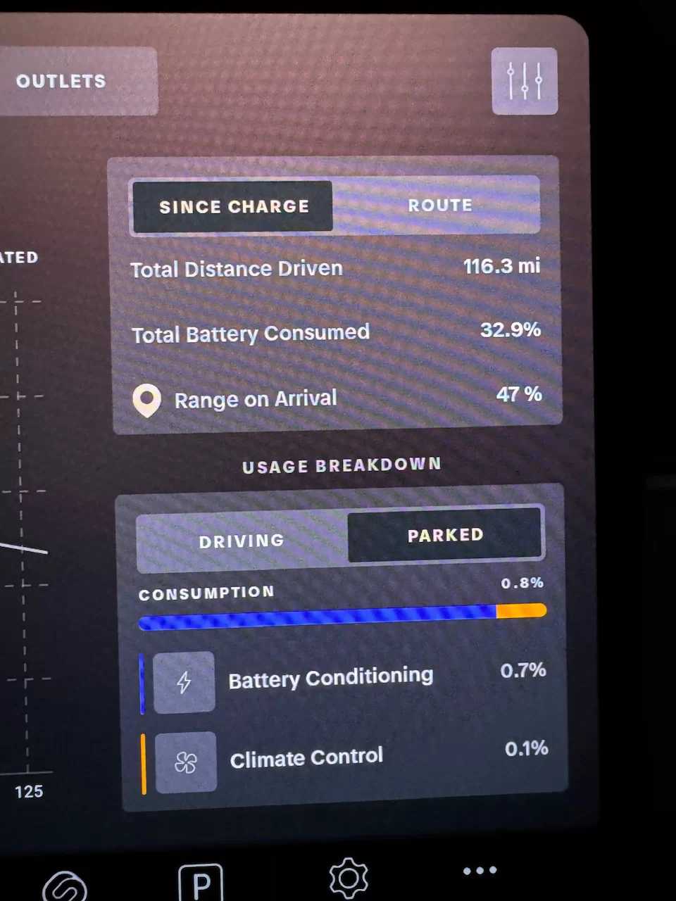

That 54.9% usage while parked over a week during sub-freezing temperatures seems reasonable to me. Attached is a screenshot I took when my car was parked for a few hours with temps around 47F, where 0.8% of the battery was used for pre-conditioning.
