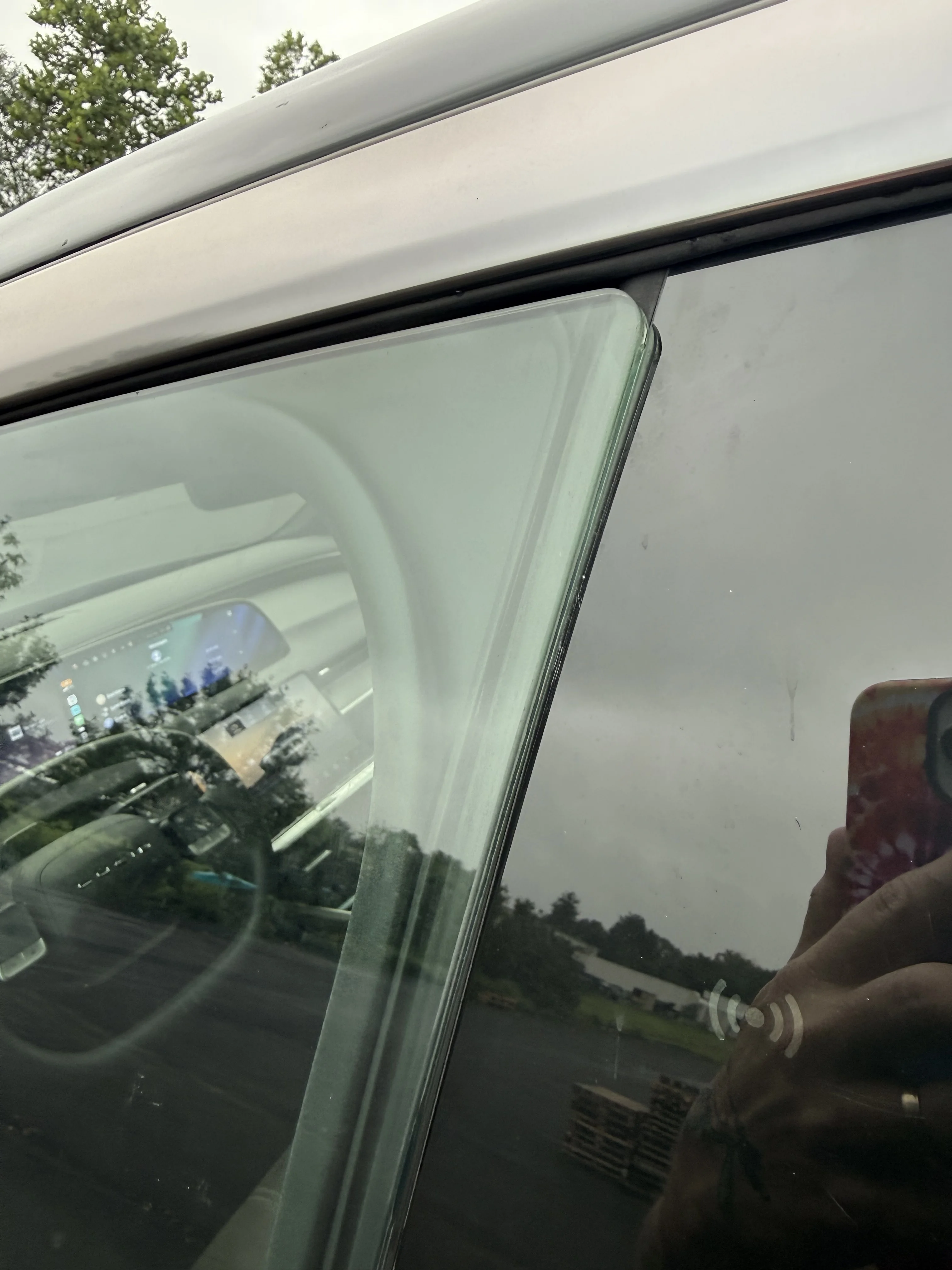

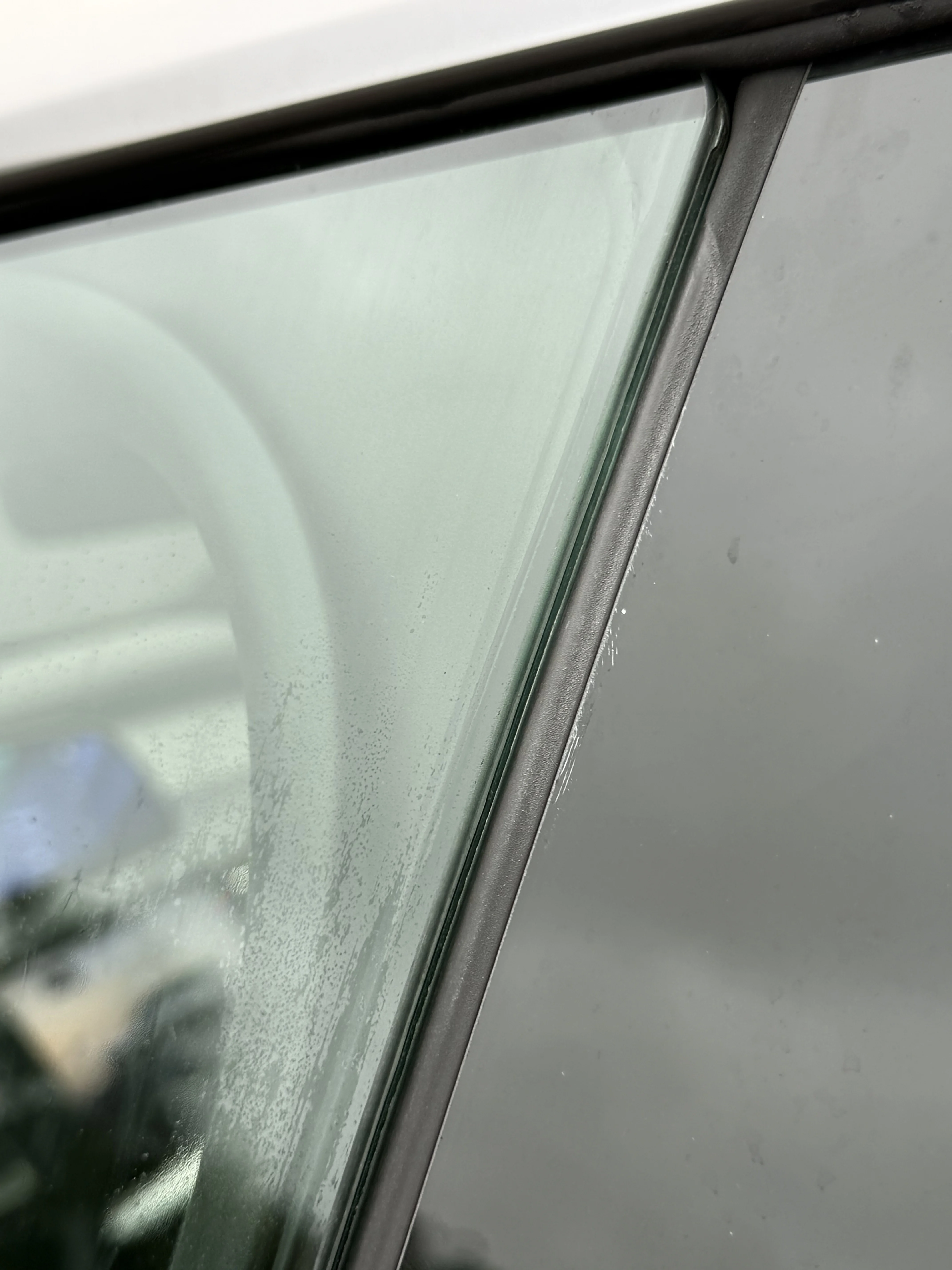

so my driver's side window is slightly off track/loose to the point where my window overlaps where it belongs
so I hear bad wind noise and it might even leak, but I have found a temp solution
temp fix is to roll the window down while the door is closed and roll it back up- the window catches the foam and is forced into place
Since i am in KoP thursday for my wife's iFly appointment I am going to bring to service and wait for the fix, which service has arranged for me. If it turns into longe rissue they will get a car for me
Pic after I do the temp fix
Had the exact same problem as have a few others on the forum. In my case it started happening on a week trip. I was alarmed that it might get really messed up or brake the window so when closing the door from the outside I would push the window towards the front of the car just as it closed. That wouldn't work if I was in the car, so I used a suction cup device made to pull glass off mac computers to do the same from the inside.
When I showed this to the Torrance service center people they liked my dedication apparently and said they happened to have a roving service guy coming who could fix it on the spot if I came back in an hour. I did, even talked to the guy and he said it was a known assembly loose bolt problem. He had it fixed in maybe 15 minutes, don't remember.
Definitely get it fixed ASAP
I've got the same problem on the drivers side window. Give the local (Milbrae for me) service center a call?
Pic of it off alignment
I had that problem too. Had my local service centre fix it when the Gravity was in for another far more serious problem - coolant leak due to a failed "ferrule seal". Problem with window hasn't recurred. Neither problem has, I hasten to add.

Yeah. I’ve had this issue twice on my Gravity - once with driver window and once with rear driver window. It just happened again with driver window. Each time they’ve replaced regulators. It’s incredibly annoying. The windows have also been stuck all the way down twice. I will deal with the noise this time until something else happens as it’s not worth waiting a month for it to go in service to get it fixed.
All of this for frameless windows. I’d rather the windows work 100% of the time like they do on our Rivian. This has probably been the single most annoying issue in my year of ownership. And it always seems to happen on roadtrips.
