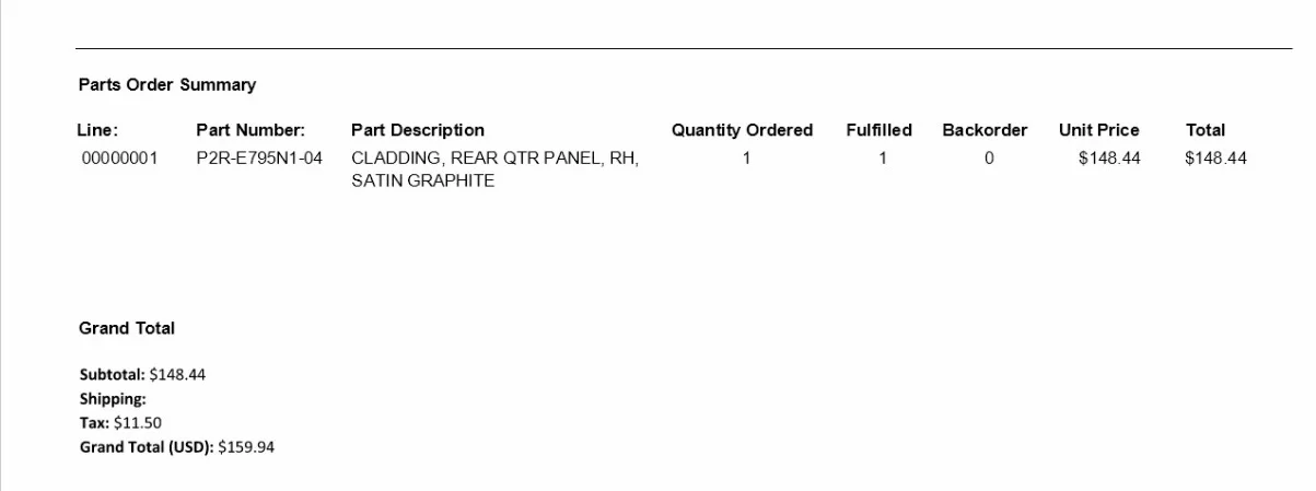

Damaged my rear fender arch trim (the one with a sensor cutout). In case anyone wanted to know, it’s $148.44 for the replacement part. The piece is held by clips.
