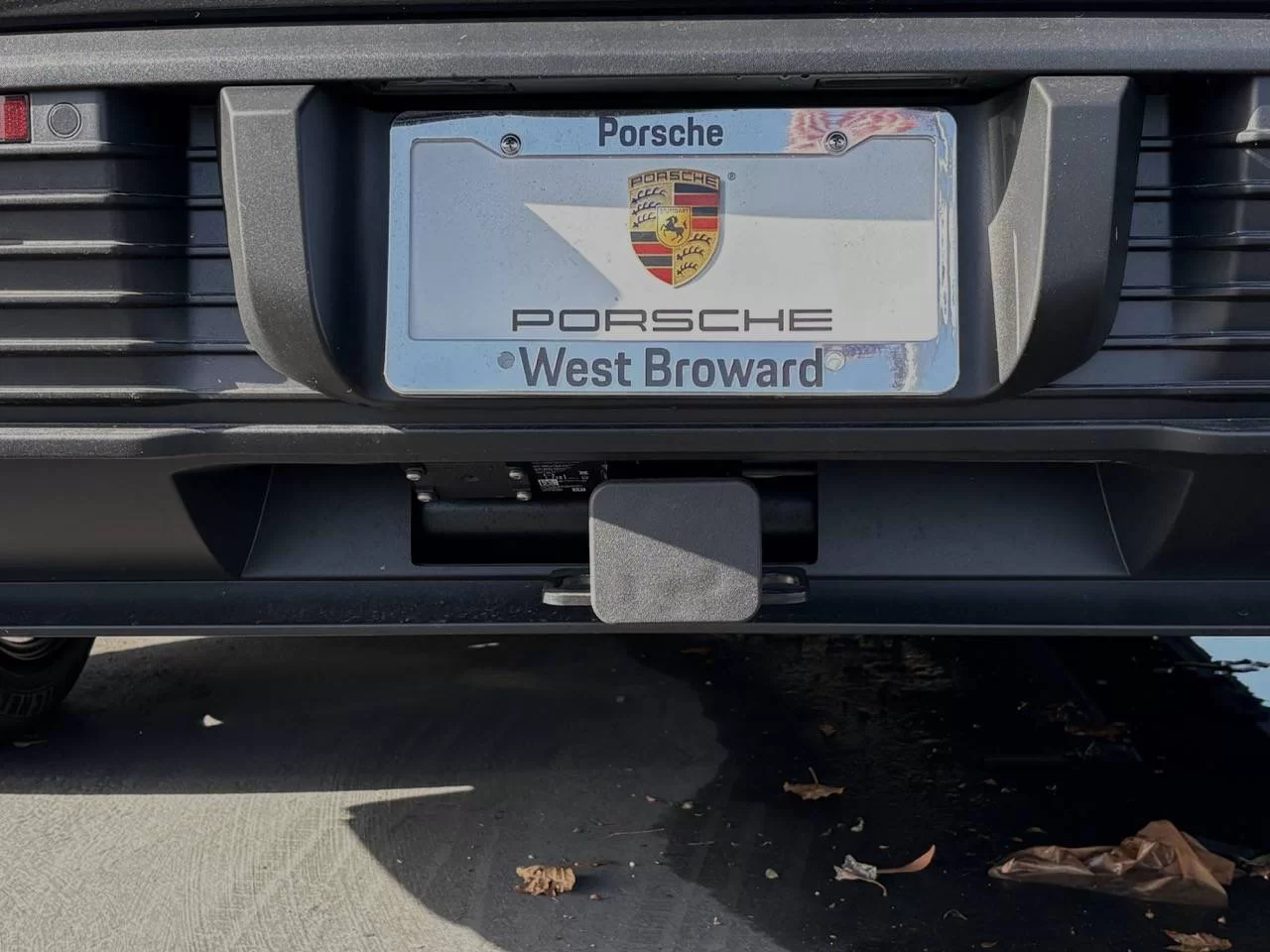

Also, with regards to the picture of Porsche with through bumper hitch, I remember a year ago looking at the new Cayenne and when googling hitch info, I was directed to European model info that showed that in Europe, Cayenne’s come with a similar hitch to the Gravity one, so probably with similar limitations.
