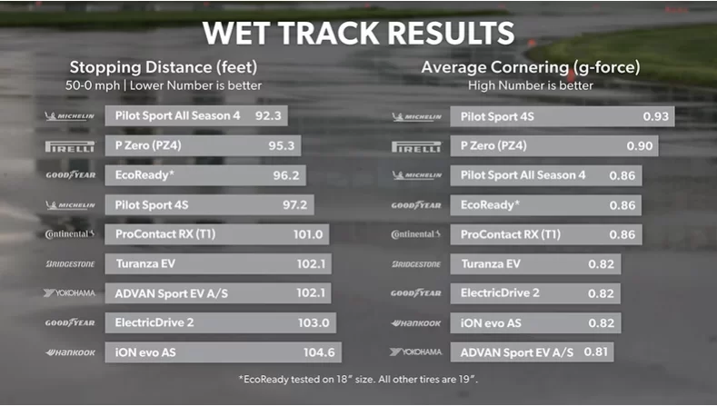

The point was that tires tuned for efficiency have significantly worse wet weather performance. And that summer tires have excellent wet weather traction as long as it's not too cold.
I doubt the Hankook iON evo AS SUV and Hankook evo iON AS have significantly different compounds. If there was some magic compound with excellent wet traction and efficiency they would have used it on both variants.

Never said it was a bad tire, in fact there may be no tire that is better than it in every way (i.e. it's Pareto optimal*)
But, I'm willing to bet the PZ5 has better traction in wet conditions in temperatures above 40F.

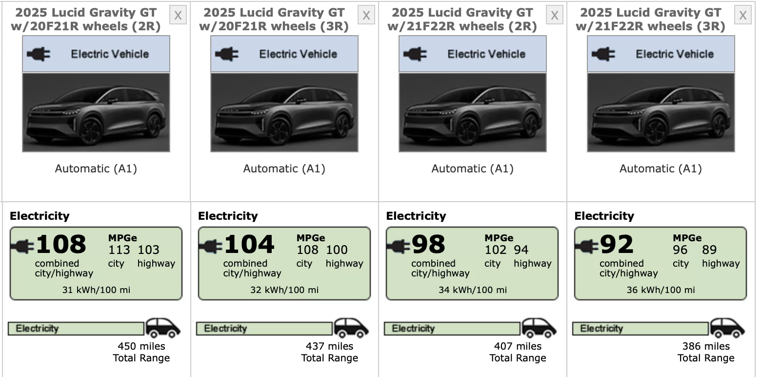

No argument that the smallest tire is the weakest for traction and PZ5 being the best.
I am happy to quantify the braking on smallest tire after my GT is delivered. One day.
