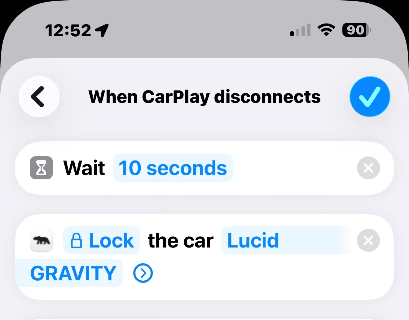

Sometimes my lucid fails to lock after I exit.
I suspect it is because the car sometimes think that the car is not in Park
Exhibit A automation works, though sometimes failed reporting the car was not in park.
It would helpful if lucid commands could run in background mode and provide external feedback so shortcut if command could be used when command succeeded or failed
Exhibit A iPhone shortcut automation

The Home Assistant automation can see the Gravity's current gear position as the entity sensor.[carname]_gear_position. You could create an automation to alert you if CarPlay disconnects and the car isn't in Park or something similar to test your theory about it being the gear position.

Exhibit A iPhone shortcut automationView attachment 37676
