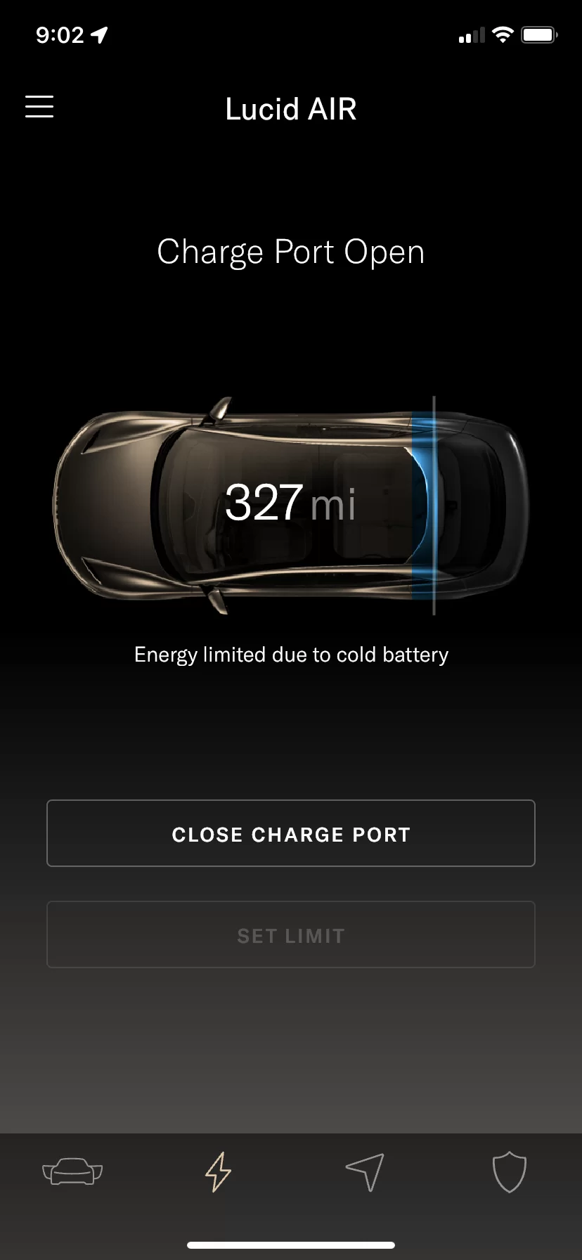

I’m getting this message this morning. It was about 12 degrees overnight. Now 29. I’ve been in the car driving around town for about 1 hour.

Thanks! Car is parked in garage and temperature outside is around 20F. I did contact customer service but they indicated because it is cold car is giving that alert. I am surprised, that I am getting that message even though car is plugged in. I thought plugging in might keep the battery warm. Anyway, I will see if it goes away, since temperature is going to be higher in coming days.
I have this same issue. I thought that having the car plugged in would prevent this but as far as I can tell there is no advantage to being constantly plugged in. Pre-conditioning will not eliminate the message either. I tried Pre-conditioning plugged in and unplugged but still have the message. It only goes away after driving for 20 or 30 minutes.

Thanks, CS asked me to precondition it which takes 45 min or so and it did go away, probably it is similar to driving for a while. I think this alert can be ignored, I saw first time and just wanted to confirm can it appear even when car is plugged in? CS said it will occur regardless of car is plugged in or not due to cold weather.
